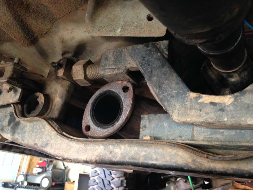

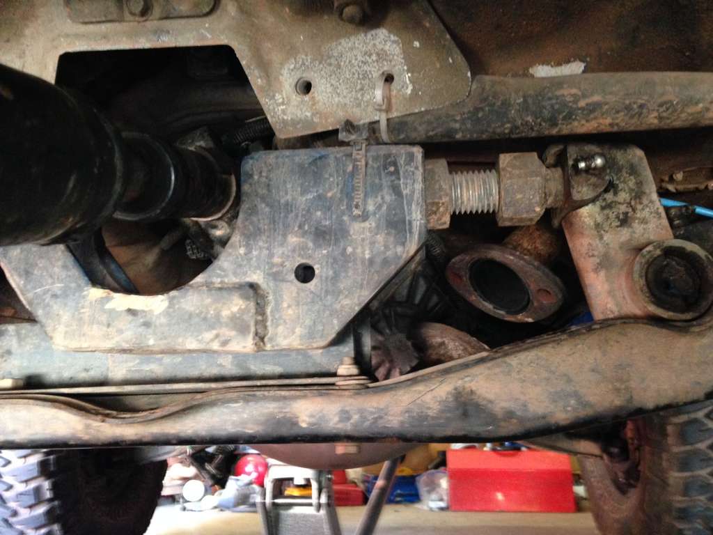

Next came to exhaust. I decided to return the exhaust to the original two cat with crossover after the TC design that came on the VX and '00 troopers onward. The design I was using came of my original '99 trooper donor and if I tried to reuse that I would have clearance issues at the bend that goes around the front prop shaft since the new shaft is bigger in diameter than the TOD one. I could still make it work but I like the idea of going back to the stock setup. So I tried to install the right side exhaust and found that I needed to remove the front prop shaft to get it in place grrrr. I eventually got it installed but know now that it would be better to install this before installing the TC. The left side went in without too much of a fight but exposed another problem: the rear exhaust flange interferes with the super flex IFS setup. It fits but it will definitely make a racket bouncing around. Since I now have a front locker I think I'll go ahead and remove the SFIFS and go back to the stock setup there too. Which brings up the likelihood that I will have a SFIFS kit available in the near future, see pics
SFIFS exhaust clearance - my previous exhaust had a straight through pipe here instead of a flange.
With locking pin in place
Locking pin removed
