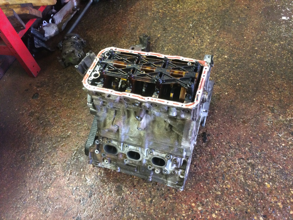

    So back in June my engine gave up on its steady diet of a quart every month or so, and just binged on half its oil supply in one day. So it pretty much sounded like ball bearings in the engine.

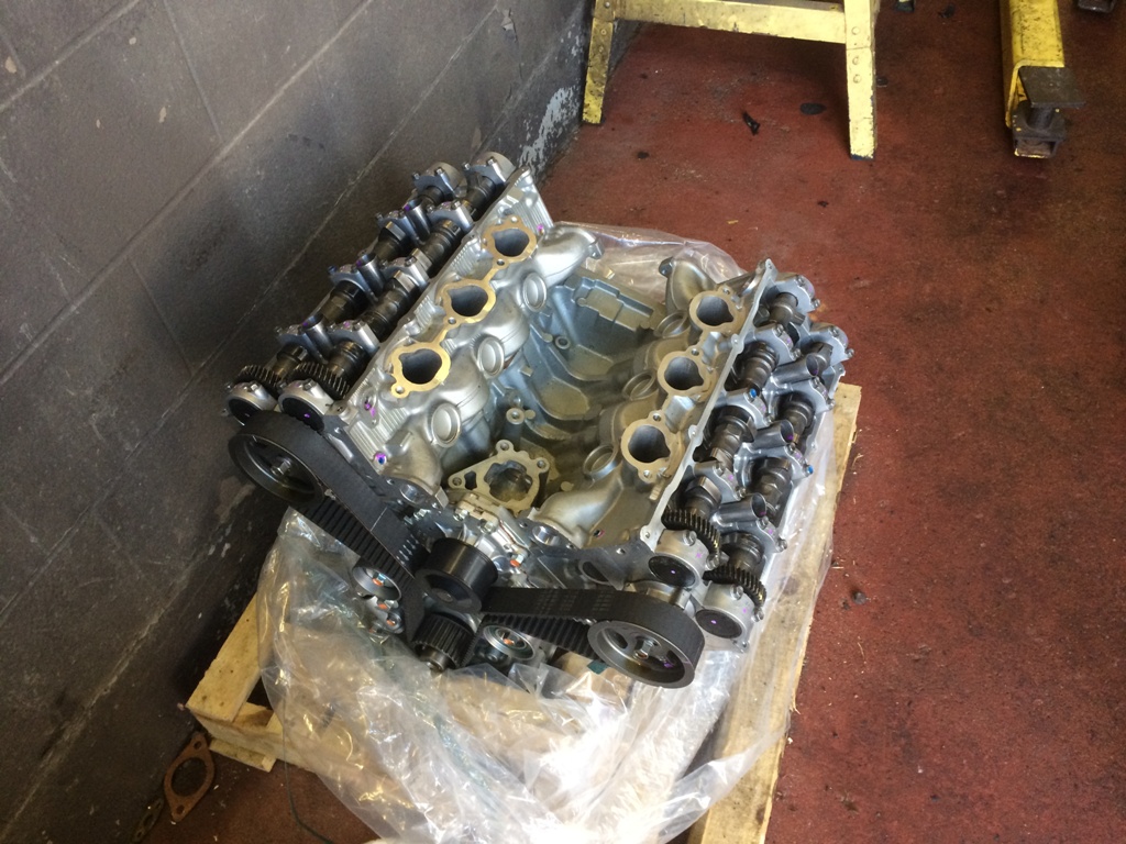

    After a month of digging around and looking at my options I settled on a re-manufactured 2003 Axiom Engine. I chose this as it was easy to get through a nearby autoparts distributor and it comes with a 3 year 100,000mile warranty.I did try to consider a used Axiom Engine from a wrecker 500 miles away, but it was over $2,300 with getting it to my door, where the reman was $3,000 (with core return). Made sense to spend the extra to get close to "New".

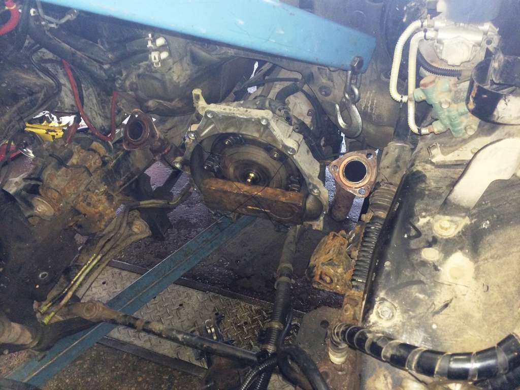

    I had one guy I got a price from that said he had to lift the body off to get at the engine (probably saw that online video) so his price was higher... That doesn't have to happen. My mechanics however had to pull out the front differential and axles. Not sure if that was truly required by someone familiar enough with VXs... Anyways, a few interesting tid bits I learned/saw:

    Funny thing with all the parts swapped off the old engine onto the reman, It was hard to tell it was "new"- the reman was all shiny and it pretty much got covered in old covers, headers, tubing, etc...

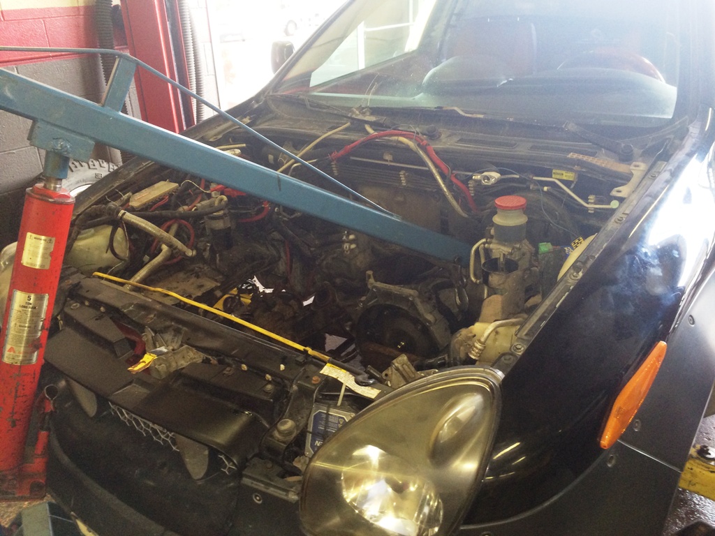

    Engine Out:

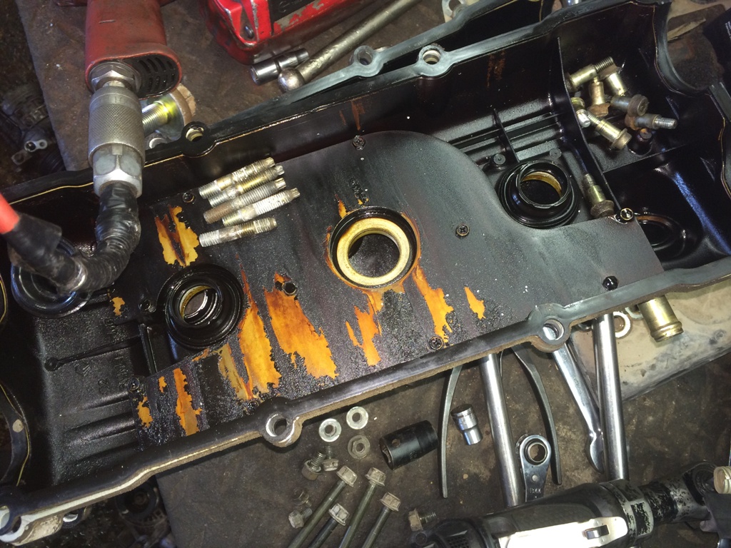

    Build-up under existing headers:
    Old Engine out (pan was FULL of metal bits ):
    Shiny reman Engine:

    We are in the same boat! Just installed my remanufactured engine last week. I did it myself, and actually, wasn't that bad of a job! Not sure why they had to remove the axle or mess with the brakes? I think that vid with the body coming off is a bit extreme. I pulled my engine only out the top! The good thing about doing this myself is, like you, I swapped everything off the old engine ( sensors, brackets, valve covers, ect) to put on the new engine, but not before completely cleaning, and in many cases painting the pieces going back on the new engine. Also cleaned out the plenum to shiney new condition. Yeah, all that took time, but the end result looks really nice in the engine bay! Congrats to you on the new heart, and many wishes for many carefree miles ahead for you!
