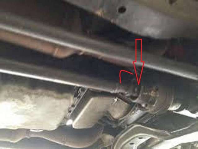

    Take a look at the front prop shaft. It is a CV style shaft, has internal boots fore and aft. If you drop the front diff too much, it pinches the boots on the "cup" portion of the flange. The flange will deform to fit the new angle, the boot, not so much. The boot is not obvious like the CV joints, as they mount external to the shaft, the prop shaft is internal to the flange assemblies. Crawl under there and look
    As for rear axle, I run the adjustable rear lowers, centered the axle and have been fortunate with no problems.
    JoeD did my diff drop, CVs are perfectly straight (on a note, they do not like negative angles at all)
    The arrow points to the boot location. The curve represents the changing angle as you lower the front differential. As you can see, there is not a whole lot of room for angle change. You may be driving around with ripped prop shaft boots right now. My last shaft boot ripped 3 or 4 years ago, but I never really had problems until I started playing in water and mud. So, if you stay out of mud and water, just add grease every so often, probably be fine. My last one started grinding, it was full of dirt. This new one got washed out in the pond in front of Baby Lion's back at Moab, so it is already making noise. Full of sand and grit.

    Not sure how many have dropped their diffs,but they may have the problem and not even know it. Unless you take a flashlight under there and look into the assembly, you would never know the rubber cuff is ripped, until water/dirt gets in there, which would not normally happen unless it was submerged, which would have to be a significant depth to reach that high.

    This is not so much a "dropped diff" issue...though that might accelerate the issue. Over time those boots deteriorate. The dirt/grime from offroading speed it up. My diff is not dropped but my prop shaft went. The front joint had about 1 inch of play in it. Replaced with a low mileage trooper unit (exactly the same) a little over a year ago.

    Billy, the dropped diff certainly causes failure. The prop shaft was designed to always stay at a certain angle, not like the CV joints. As illustrated in the photo, there is not much room for angle change. Less than an 3/4" in play in either direction. The cuff was not meant to flex either. I would be curious for those with diff drops to crawl under the truck with a light and see how much metal deformation has occurred, and if their cuffs are ripped.(Only my front ones ripped) How many have actually installed diff drops? That would be a good survey
    I do agree that even without the drop, the cuff can tear, but much the same as a CV, keep adding grease, stay out of mud and water, and it will probably last years. My wife has a torn CV boot, haven't had a reason to repair it, if the CV gets noisy, there are lots of troopers in the yard

    It depends on how much you dropped the diff. At the time, I was nose high in the air on the front end, and Joe did a decent drop, will need to measure to see how much. I would say an inch is probably fine, and does a world of good for the CVs, so well worth it IMO. I will not be repalcing the shaft again, I will have one of the shops fab a universal joint shaft to go in its place. Shouldn't be too expensive, hardest part will be keeping the original bolt pattern, or fabbing an adaptor to make it work.
