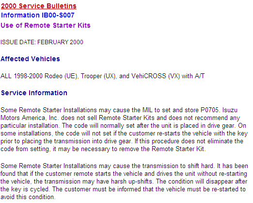

					Ok...weird.  This happened 2 or 3 times.  1st time was last year. Normal driving and then when slowing down as it's downshifting, i feel a big jerk.  Then starting back up as it upshifts, it jerks again.  I thought, "Dang!  Tranny Problem!".  Got home, shutdown, and the next morning back to normal. No problem.  Most recent, last week...same thing.  I decide to pull over the side after it happened a few times.  Turned off the ignition. Waited 1 minute.  Restart...no problem.  any ideas?
