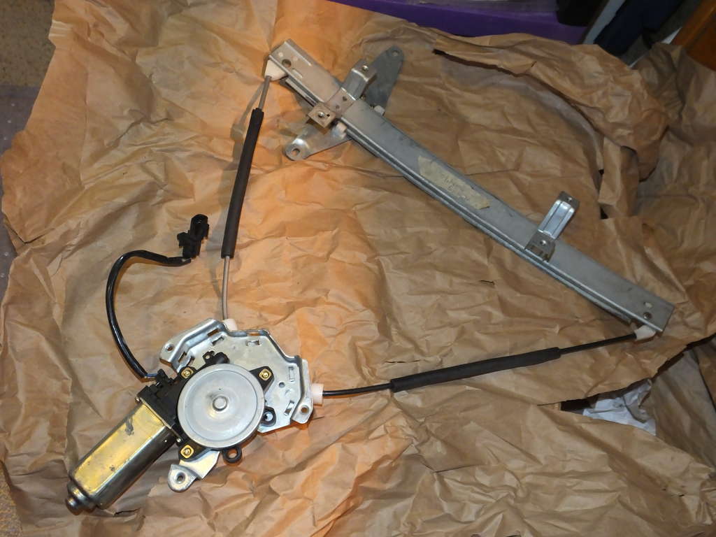

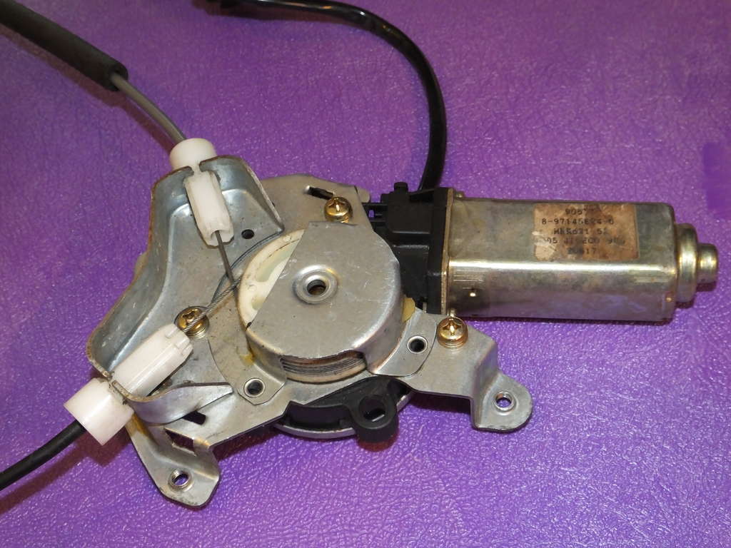

    I'm not clear David.....are you after the beige electronic module that's attached to the black switches, OR are you after the actual motor for the WINDOW? Or both?
    Here's closeup pics of the window motor attached to the window regulator. It's super easy to remove the motor, it's just those 3 brass colored screws.
    In case somebody is looking for used WINDOW MOTORS, here's BOTH ON EBAY for a VERY reasonable price!
    LEFT SIDE (US Driver side)
    http://www.ebay.com/itm/ISUZU-VEHICR...E:B:SS:US:1123
    RIGHT SIDE (US Passenger side)
    Here's close up pics of the US spec window button modules, in case it helps you decide if you can mod it to work for you.
