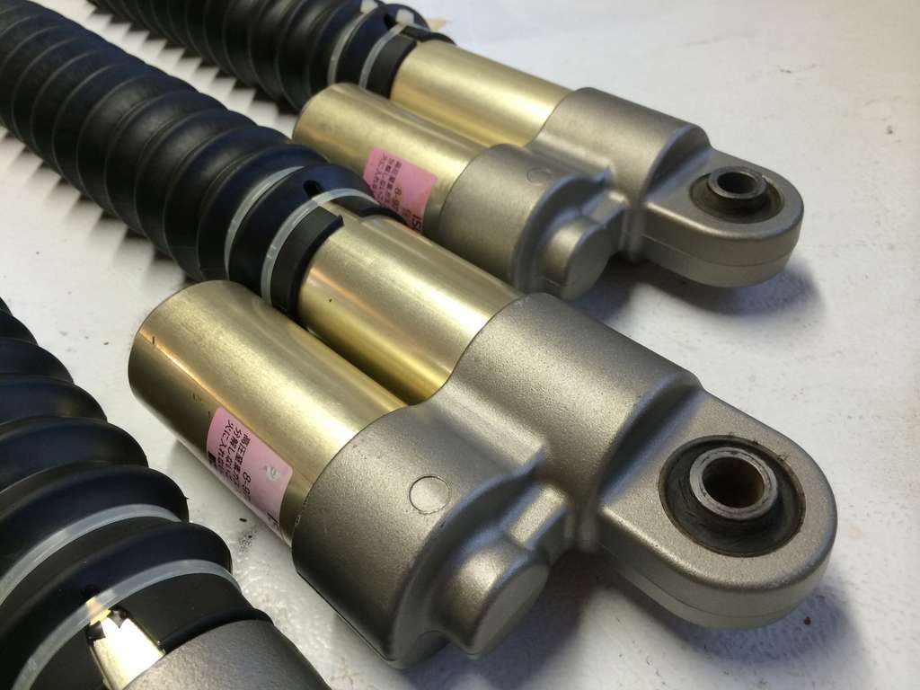

    Now I happen to be a big fan of the ride that the OEM shocks provide when you lift the VX and add big tires. I think that the OEM shocks perform better than other shocks. The current VX that I am working over has some sad Rancho RS9000 shocks and I really don't care for the ride in comparison to the Ebony that I recently sold. One of the first things I am addressing on the Kaiser is the Shocks.

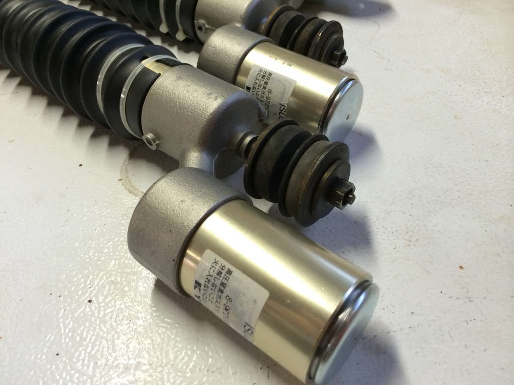

    I must express gratitude to Mile High VX for working with me to get the shocks and also assisting in lining up the rebuild in Golden Colorado. I do not have before pictures of these unfortunately, but I do have after pictures. They look beautiful and I can hardly wait to get them in place and see the difference in the ride. The rebuild is a little spendy, but to have the quality and performance of what the VX came with I think worth it. You have to remember that new these shocks retail for over 500 each, so in contrast the rebuild was minimal. I can't wait to get them dirty.
    If anyone is interested in rebuildt shocks Matt at info@rg3denver.com. I think that the work on these really look great. take a look and judge foor your self.
    Thank you to everyone that helped this come together

    I'd press the "Like" button if there was one!
    They look great!
    They look great ... but pretty is as pretty does. Make sure to post how they perform after you get them installed.

    I agree with you. I just replaced my still fully functional RS9000's with a set of original OEM shocks (not rebuilt), and love the stock ride. Now I have four bad OEM shocks, including one with a snapped off upper stud, and would like to get them rebuilt for spares. I need to write him with photos to see if that one shock can be repaired.
    I like how he resealed the canisters, and also like the looks of the black boots, although I would probably ask for red just for originality.

    Not sure if I'd ever consider that much for a shock rebuild....and I'm used to higher priced Bilsteins for my sportscar. They are only $300 for a set of 4. That said, if being open-minded, I have to ask why it LOOKS like these rebuilds still have the original rubber bushings? For that much, I'd think everything would be replaced!
