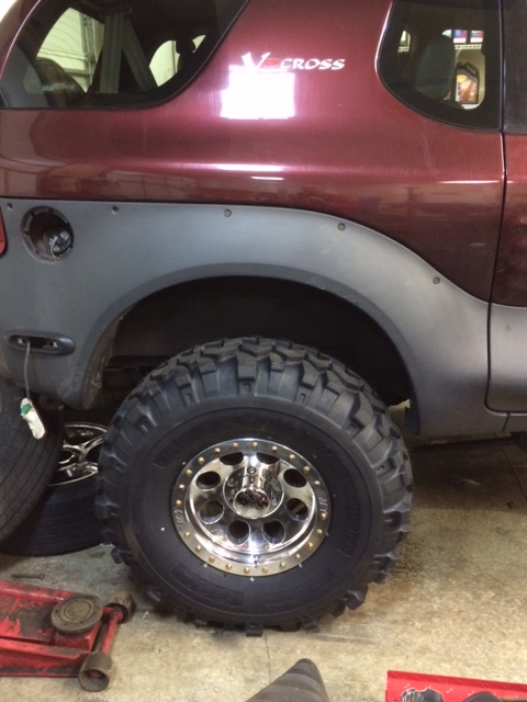

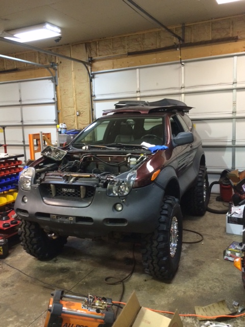

    A couple Pics

    Lookin good.

    OhioVX...so, you have a 3'' body lift and a 3'' suspension?
    Jan 2014
    2001, Foxfire, VX, 1132
    91
    Yes, I think I'm going about another 2"s so I don't have to do a ton of cutting on the front.
    will having that body lift reduce your mileage? Id like more clearance but not if it sacrifices the gas.
    I think it looks great at the current hieght...don't fear the sawzall and bfh!
