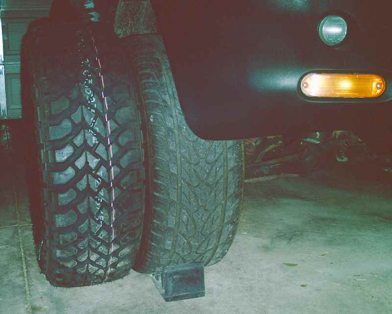

Thinking of going with:
-Maybe going with same brand of wheels in 20x9 with same offset (+12)
-33x12.5x20 Nitto Mud Grapplers
-OME 912? (do I need to change springs or can I add a spacer to OME 913)
-ball joint flip? (will this be needed now if I go bigger)
-lengthen brake lines for new height?
-additional trimming of cladding/fender at front wheels wells if needed
-adjust torsion bars if needed
-another alignment when finished
