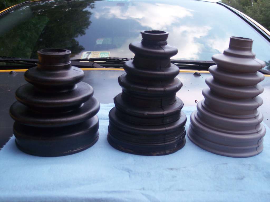

    I have no road experience with them, but after holding an OEM, Dorman, and NAPA CV Boot in my hand, I can tell you that the NAPA feels the most heavy duty. Feels like they could take some hits without breaking.
    ... but after holding an OEM, Dorman, and NAPA CV Boot in my hand, I can tell you that the NAPA feels the most heavy duty. Feels like they could take some hits without breaking.
    Yah, I'd posted this pic a long time ago (L-R: AutoZone, MechaTech, Dorman):
