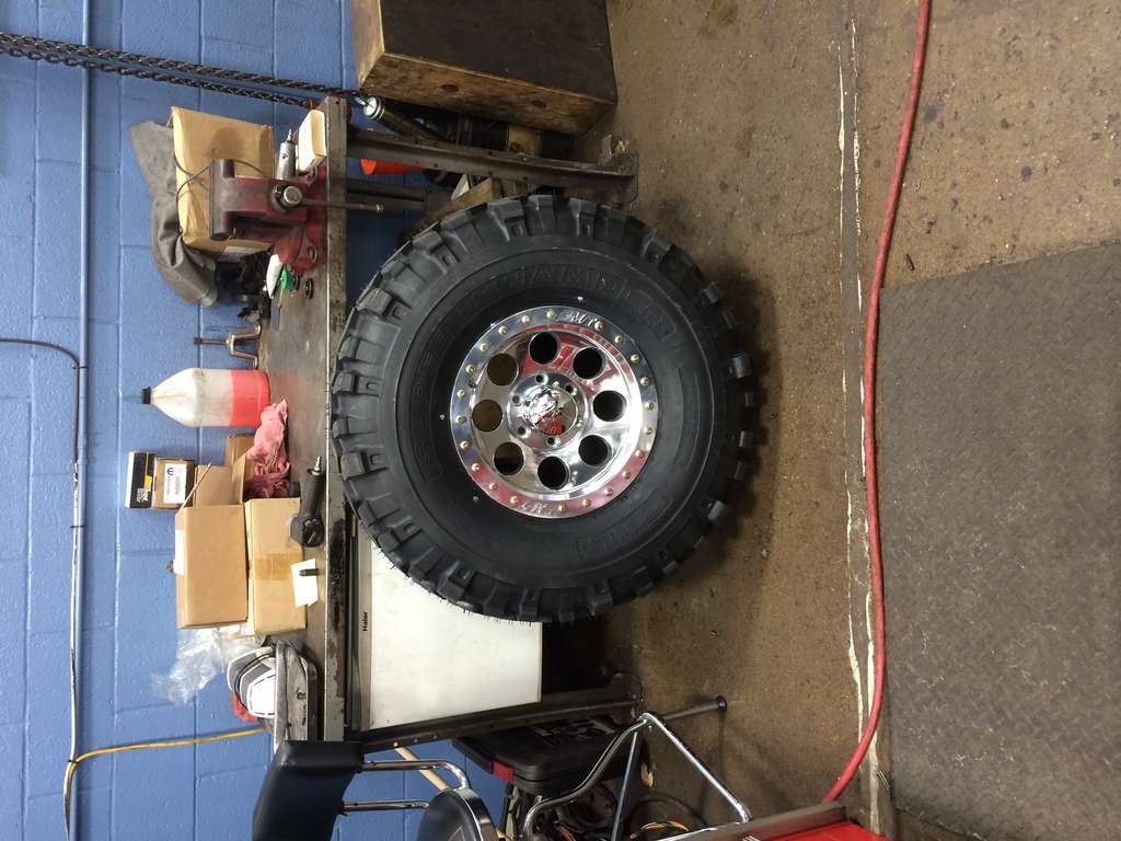

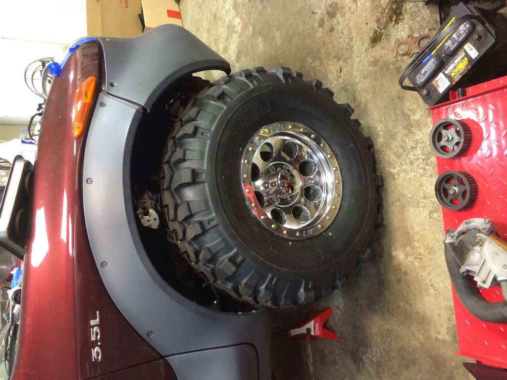

    I like the MEATS, what the size on those?
  5. #20
    Mar 2012
    sold
    1,158
    look like tractor tires! awesome!
  6. #21
    Awesome wheels as well...info would be appreciated...
  7. #22
    Jan 2014
    2001, Foxfire, VX, 1132
    91
    They are Mickey Thompson 16x8 Polished fake bedlocks. Tires are 13/36/16 Super Swamper TSL (old school)

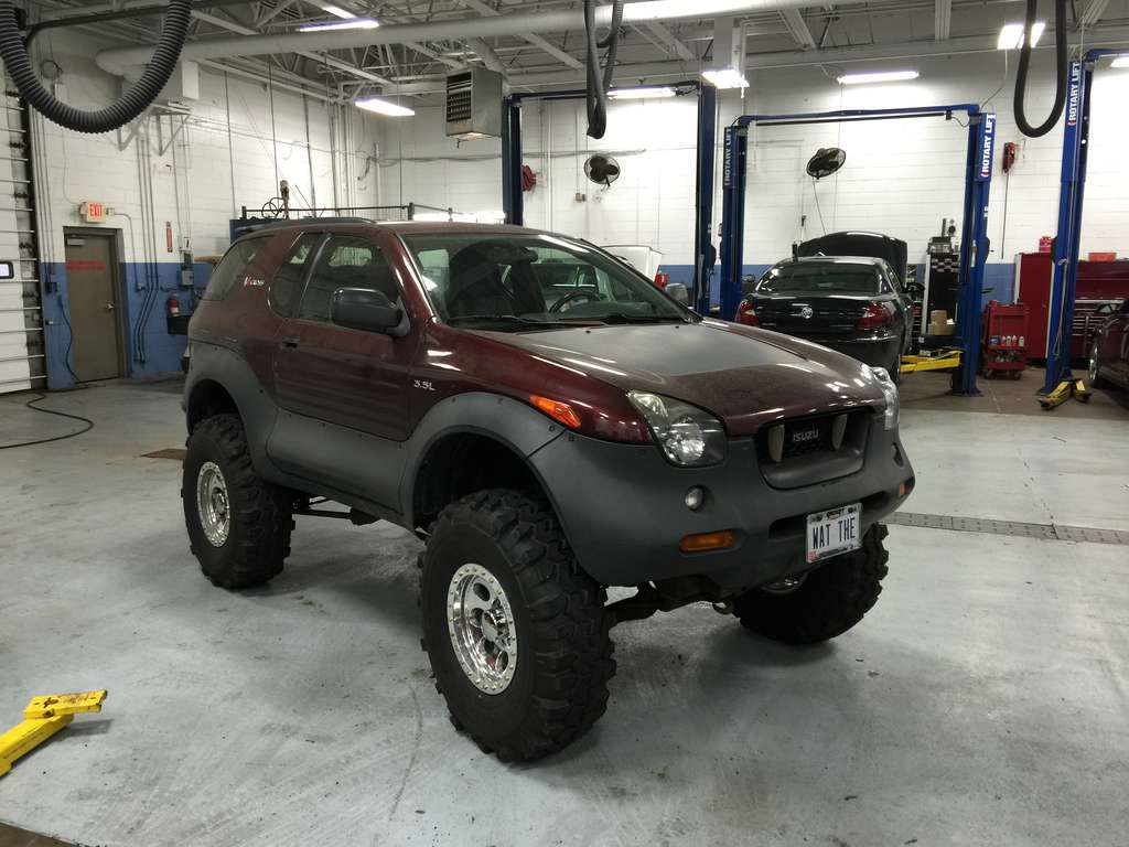

    Well it took me a long time to be able to actually work on MY OWN VEHICLE! but I actually got it together & drove about 25miles to work. The alignment & the bias ply tires being flat spotted kept me off the freeway. I'm going into work tomorrow to get the alignment straightened around then hopefully be able to drive it on the freeway to get the 8 month flat spots out of the tires. I had the detail department where I work, buff it & detail it. It is very impressive how nice it came out!

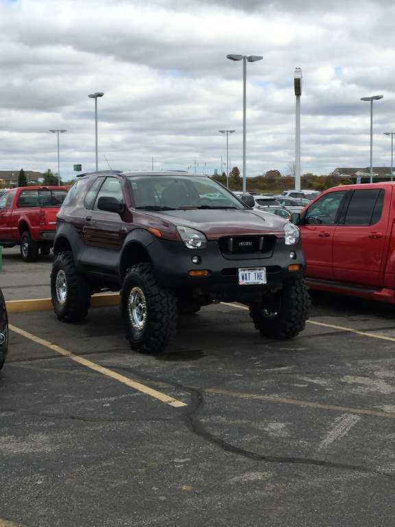

    That's quite a lift! Looks good. Well done. Make sure your cv boots are able to hold the lube in with a lift like that.
  11. #26
    Very nice...looks alot like SuperStang460 before his wreck in the snow...
