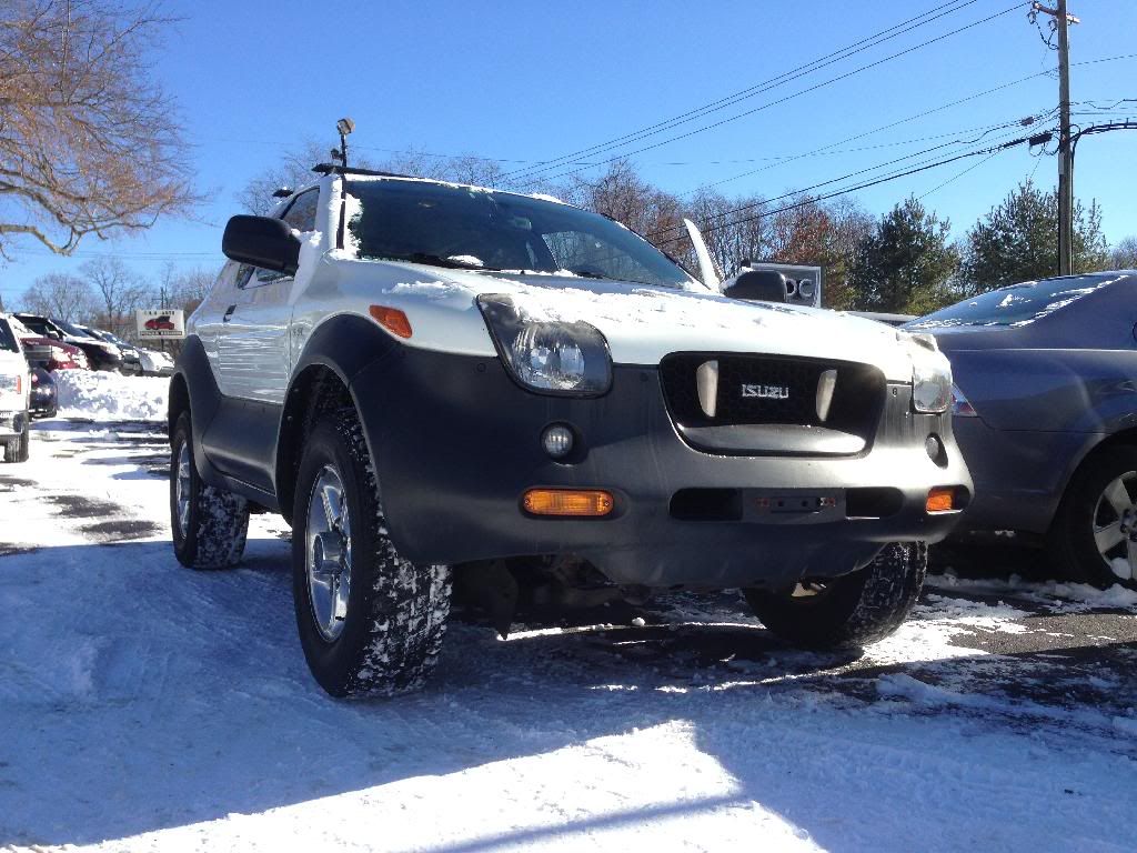

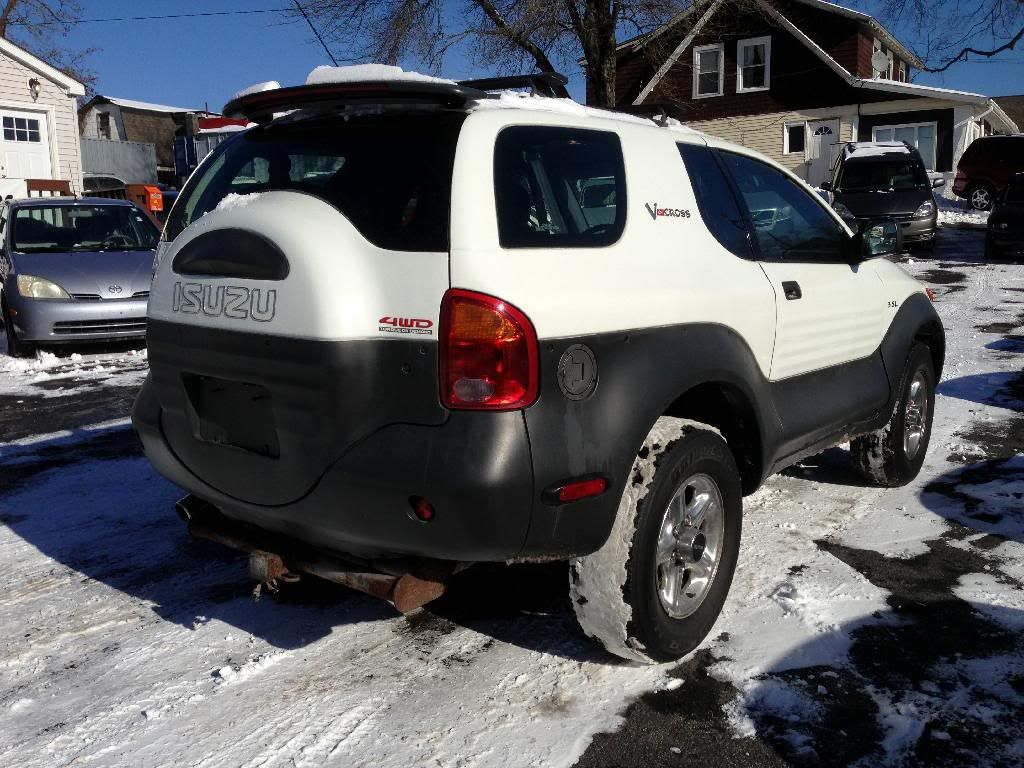

    Just got back from driving the VX. Unfortunately was fairly disappointed by it. Not sure if it was the general driving characteristics or this one in specific, but I expected it to be much more hunkered down feeling; it felt as if it was fairly hollow overall, not all that great in terms of on-road manners. Very well could have just been this specific VX though. Here's a rundown of what I found, much of which were points to be inspected as directed by everyone on this thread and in the thread provided by VX KAT:

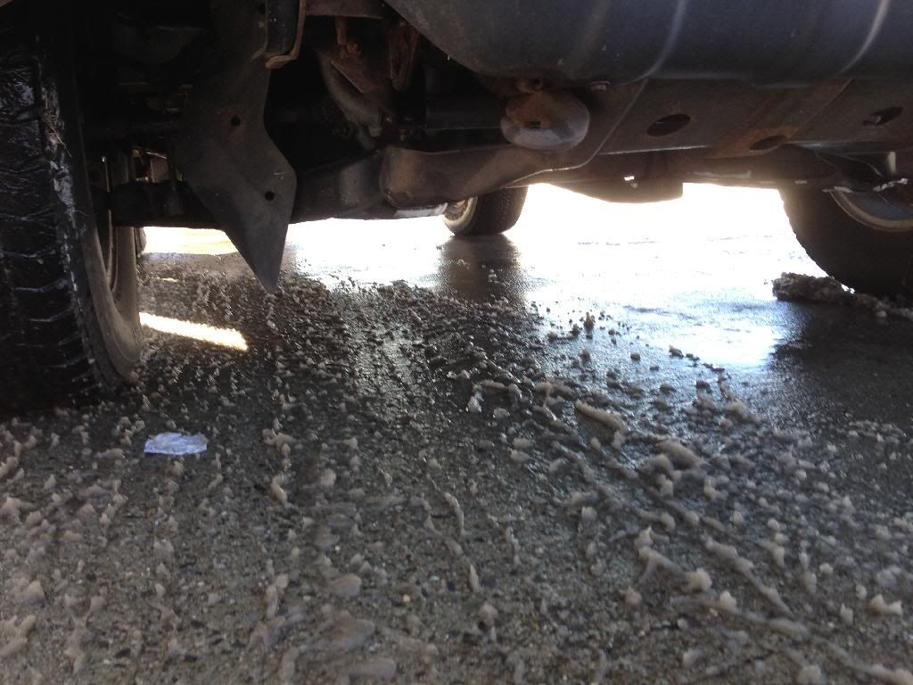

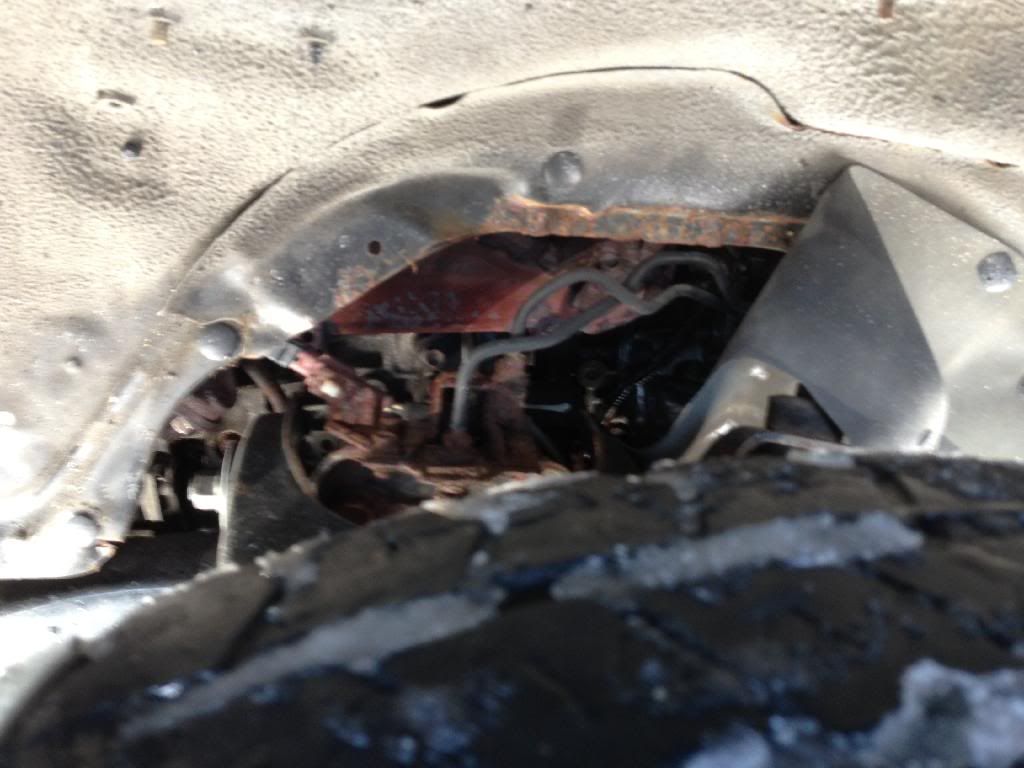

    -The vehicle came from NY and as such has a fair amount of underbody rust. Nothing I'd call concerning, but it's by no means a Florida car.
    -The dealer has no service records for the vehicle. He *just* got it in and nothing came with it except for an owner's manual. Thus, no way to tell if it's had the timing belt, tensioner, water pump, or serpentine belt replaced. Additionally this means I don't know if it's the original engine or transmission
    -The tires have about 5-10% tread left and would have to be replaced immediately. There goes $500-1000 into the vehicle. I would barely feel safe driving it home as-is on the tires that it has now.
    -The ABS light is on and the system does not function at all. I hit the brakes pretty hard on some snow/ice and didn't get any ABS feedback whatsoever from the brake pedal. Between the horrible tires and lack of ABS it was a pretty scary ride coming to a complete stop from 30 MPH on a snowy patch of road. The dealer did say he would fix the ABS system prior to sale, but whether this would this be a real fix or a "fix" has me concerned. If I have to fix it myself, there's more money into it already.
    -The lack of ABS and tread on the tires helped show that the TOD system does in fact function properly, lights included. Didn't get to try out 4-Low other than crawling for about 20' but it seemed to function as it should. Tried hard acceleration on snow/ice as was recommended and the TOD worked well giving the VX grip.
    -The CV boots seemed to be in decent condition
    -Didn't get a chance to open the hood to check the oil (already couldn't feel my fingers at this point of inspection); thus also couldn't see the condition of the battery

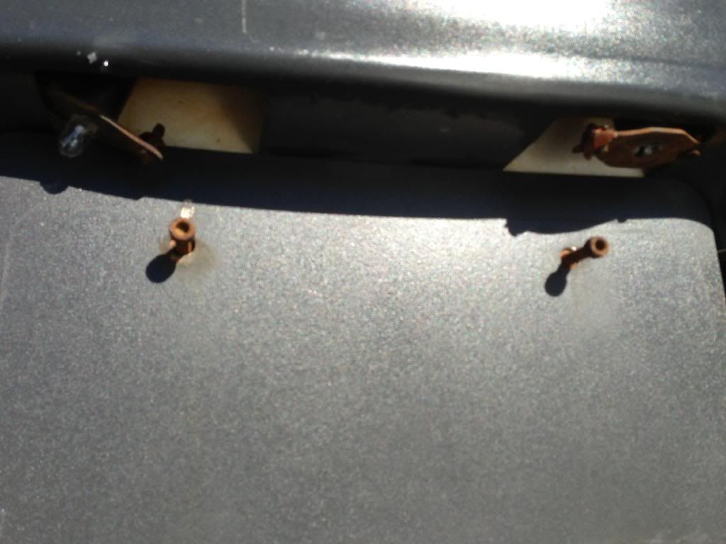

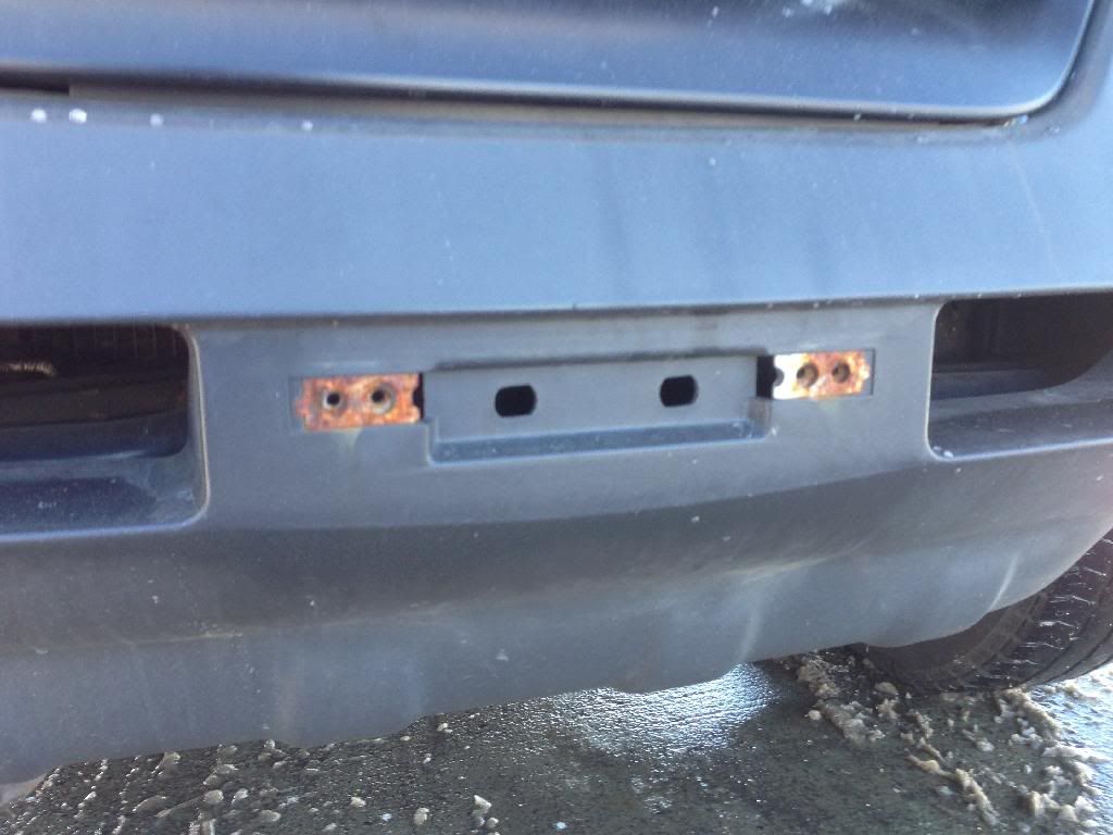

    -There is some rust on the license plate areas, both front and rear
    -Couldn't get to the bumper beam, thus couldn't tell if it was rusty
    -The engine idled and ran up/down the RPM range fine; transmission held first gear a little long after startup when it was still cold, but after a few minutes it didn't hesitate any or slip at all
    -Couldn't tell if there were any fluids dripping because it was parked on a recently plowed and sanded wet parking lot
    -NVH was a little worse than expected, no strange noises but the steering wheel did vibrate slightly and the ride was not as compliant as expected
    -Couldn't tell if the shocks were OEM or not

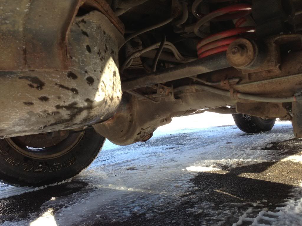

    -The rear differential cover was somewhat rusty
    -The exhaust looks as if an aftermarket tip was installed; definitely didn't sound like an aftermarket full exhaust, as the engine was much louder than the pipe itself
    -There's a trailer hitch that is rusty as hell and would need to be removed
    -U-Joints aren't looking too great
    -The power windows *barely* worked; could be result of bad battery, but they needed manual help to go back up

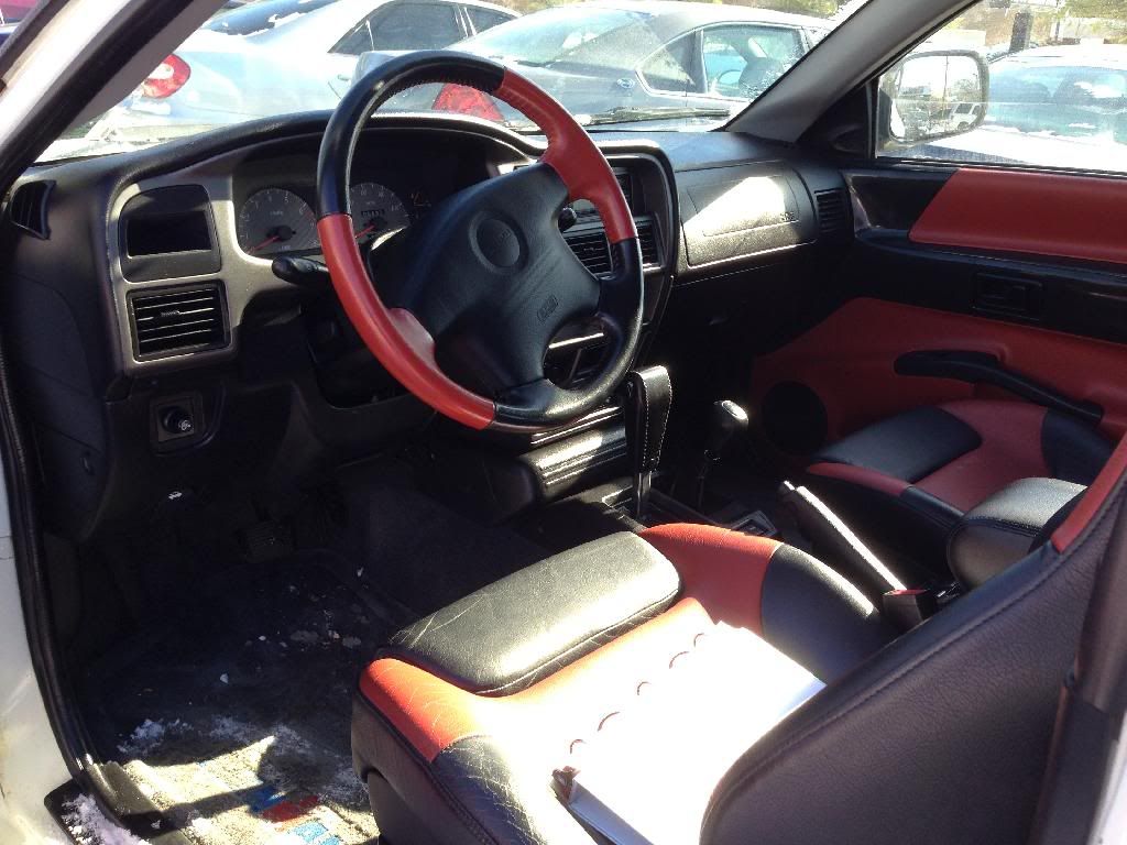

    -Interior is in good shape -- seats are ok but not great, door handles/levers are good, CD player is original, steering wheel is in ok shape (not great)

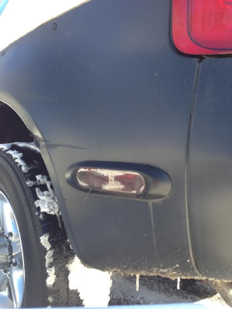

    -Paint & cladding are decent - looks as if it got a love tap on the left rear (see pic), otherwise fine
    -Part of the right front inner fender-well is hanging down and has to be re-attached
    -Price is $5200
    All in all I was fairly disappointed. Clearly this example needs some work and I'm not sure if I'm willing to do as much as it will really need. Figured if it needed some things here and there I would scoop it up and spend a little time working on it but there's a lot that this thing needs to get to good working shape before it can be road-trip worthy.
    What are everyone's thoughts on this? Even if I buy it for $4000 it's going to immediately cost a couple grand more from the get-go; that makes it hard to justify unfortunately. It needs tires, a battery, the ABS system fixed, u-joints, shocks, and possibly more that I couldn't identify today. Add sales tax and registration and it's already a $6000+ vehicle. Thoughts?
    Here's pictures of the VX - sorry they're not great, couldn't feel the fingers I was using and didn't feel like lying down on the wet pavement

    Not feeling the rust.
    Quote Originally Posted by eternal21 View Post
    x2...would be too much for me.
    '01, Proton, VehiCROSS, 0229
    631
    Thanked: 15
    x3...personally I would consider this one a "part out" vehicle. I think its to much unless you got it for a couple thousand...especially not having ANY service records ...and you still dont know what problems hide under the hood...
    I would continue your search for one that will make you smile when you see it, and not 2nd guess yourself
    994
    Quote Originally Posted by tysamigo View Post
    I respectfully disagree. The only "part out" candidate should be one with a wrecked body, bent frame, or fire damage. Unless the frame is rusted through, it can be cleaned up and made right. Whether it's cost effective for this owner may be questionable, but don't call it a lost cause quite yet.
    I'm an old muscle car guy, and I've seen much worse project cars. This one doesn't sound that bad. Mostly unknowns and assumptions. It needs a good inspection and a little TLC, that's all. Go for it!!
    Gregg

    You have valid points. "Part Out" was probably over the line, I'd like to retract it lol... nontheless I personally wouldn't be interested in such a "fixer upper"...especially without any service records
    Dec 2013
    2001 Kaiser Silver VX
    30
    OK so I'm thinking I'll give it another drive once the ice melts (not about to drive this thing on the 1/8" of ice we just got with no ABS and bald tires). Will try to look under the hood and will man up and just crawl all the way under it to check it out.
    If everything looks decent I'll try to pick it up for around $4000. Any more and it's paying way too much; this thing is just above true "fixer upper" status.
