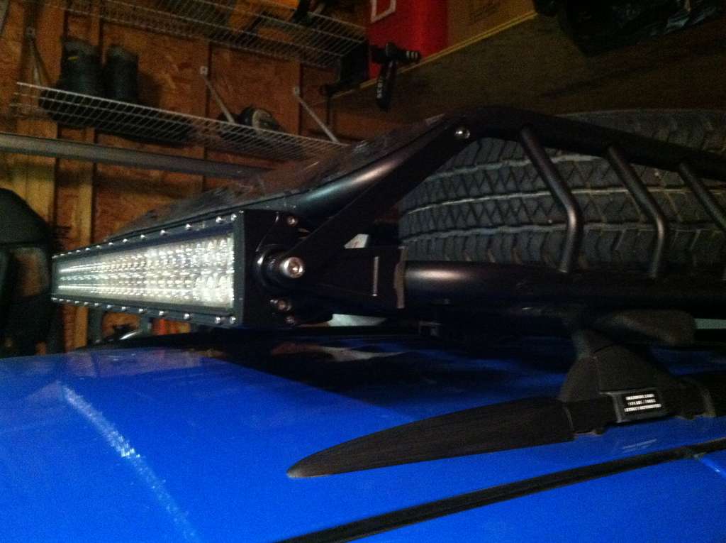

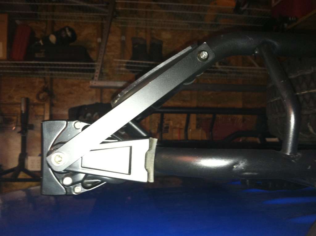

So I measured out the location for the light and drilled two holes through the lower front bar of the rack for the mounting brackets. I bolted the brackets into place using two stainless 1/4 20 bolts and nyloc nuts. I mounted the lightbar on these brackets and it held up OK but, I figured if I take this wheeling there would be too much weight and leverage for these to be a lasting solution. As luck would have it the width of the outside of the brackets lined up nicely with the upper rack bar and there is a bolted in crossmember at the top for the wind faring. I went off again to Lowes and bought a length of flat aluminum metal bar to use as a brace. I cut, drilled, and painted the aluminum braces and installed them with the lightbar. Success! Very stable now.

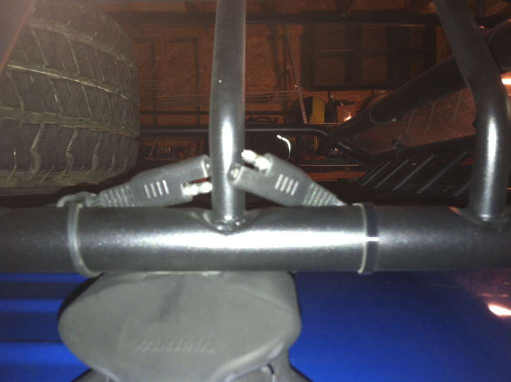

For the wiring, I had an old motorcycle trickle charger that I didn't need so I cut the cord off that since it has the SAE 12V battery connectors. This will allow me our anyone else in the future to remove this light and replace it with something else if desired.

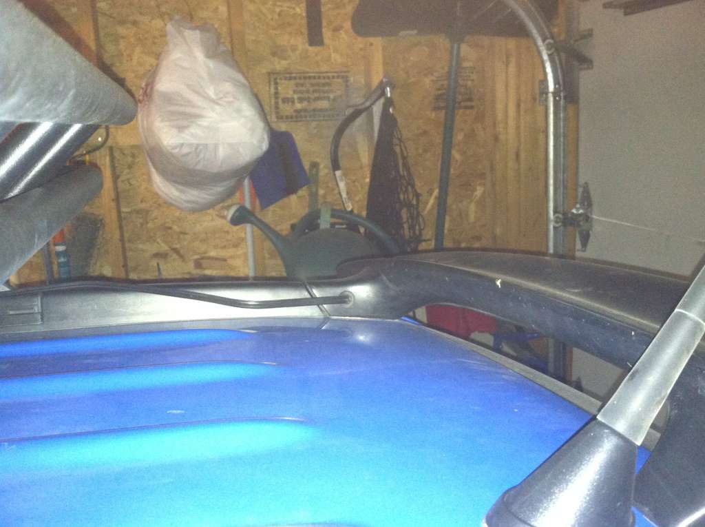

Then I ran the wiring along the rack and down the rear OEM roof rack pillar and along the inside surface of the roof rail. I removed the wing, drilled a small hole, inserted wire and grommet, and fished the wire through the brake light hole in the roof. I reattached the wing and now have the wiring inside the cab.

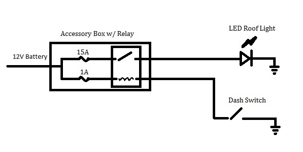

I grounded the negative on a convenient lug near the antenna. I used the write-up in here for the electric accessory box:
http://www.vehicross.info/modules.ph...ewarticle&id=6
But since I am only powering one accessory and didn't have the AC relay Moncha spec'd for now I wired it a little differently:
