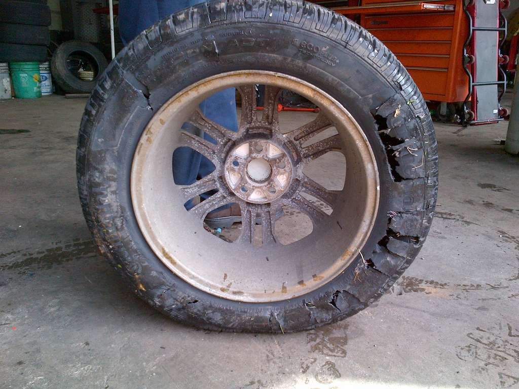

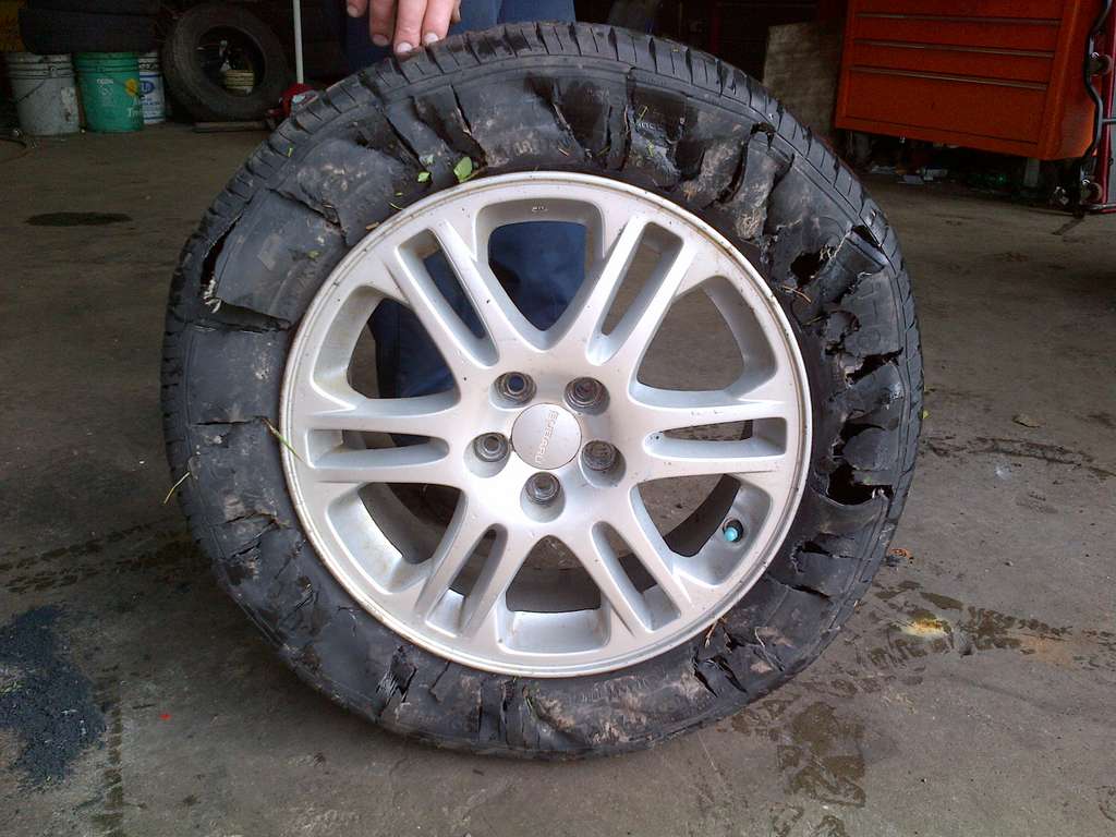

    So I bought 4 brand new Continental PureContact with Eco Technology tires for our 99 Subaru Legacy. These things are the highest rated passenger all-season tire on TireRack.com, and for the first 100 miles or so everything was fine. Until this happened the other morning on my sister-in-law's way into school:
    Now I know what you're thinking, and she was NOT involved in a drive-by or in the shootout at the OK corral. It was probably 65 degrees and drizzly out Tuesday morning, and it more or less exploded as she was going around a turn. She lost control and slid into the oncoming lane, but thank God no one was there and she righted the ship long enough to get on the shoulder. Continental provides an unconditional 1-year warranty on its tires from the factory, so we got a free replacement overnighted from TireRack.
    But my question is what the **** happened? I took it to my mechanic and the first words out of his mouth were "well I bet she **** her pants." He'd never seen anything like it. Anyone else have ideas? A manufacturing defect perhaps?

    Wow. I actually know someone who works at a Continental manufacturing plant. I'll have to forward those pics and ask what he thinks could have caused that. Could be anything from an error in the mixing process to an improper build to a malfunction in the curing process.
    Glad your sister-in-law is ok...and I'd probably second your mechanics first thought.
    I'm guessing that there was a manufacturing defect that caused the blowout but most of the damage you see is probably from the skid/recovery/stop. There's so much damage to that tire that you'll probably never be able to tell what gave out causing the blowout & what occurred after.
    Glad everyone is OK.
    im guessing the tire was not fully inflated. An underinflated tire at speeds over 40-50mph will it heat up and eventually shred. i see that kinda thing some some frequency in the shop. Not quite to that degree, but i see it often. Michelin's are notorious for blowing out like that. I dont deal with enough continentals to know if they do that frequently.
    is there a bunch of tire "dust" stuck in there still?
    That's simply amazing, glad it ended well!
    It seems there's more damage on the outer side vs. the inner side, wonder why.
    Curious, what position was it on and was turn left or right? Maybe this was the front outer position so the weight of the car and G force "pushed" on the outer side more causing those rips as it deflated under load?
    It's possible, I certainly didn't look at that specific tire before she left Tuesday morning. A bit weird that it would so much less inflated than the other tires, but if there was a slight leak I suppose it could happen.
    There was tons of black powder on the inside of the tire. What does that mean?
