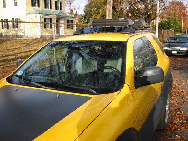

    Installed Thule # 871 fairing on the VX yesterday. Its the 38" model. I opted for this model v. the # 555 version because the install seemed easier, and it was. The longest part was waiting for the horizontal mighty mounts for isuzupart.net
    I think it looks pretty good... the 'wings' on the side compliments the rear spoiler nicely.

    drdavis4u, the rack is the OEM yakima rack made specifically for the Vehicross. There is no other rack that will fit, believe me I researched it. If you need the part number for the rack, I can give it to you.
    I installed the fairing b/c the wind noise is caused by the shape of the bars. If you don't have the aero bars installed, there is no need for a fairing.
    I researched fairing options and the best choice was the Thule #871 model. It was easily installed with 4 horizontal mighty mounts.
    There's no more wind noise after install, so I guess it works. You can purchase at your local REI, costs $45.

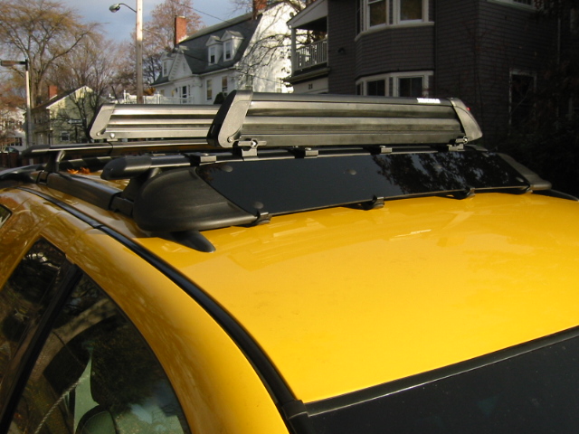

    Cool pix,
    but does thois cut down on that annoying howl from the rack at anything over 60??
    Red face
    by redirecting the wing over the wingbars, the wind noise is drastically reduced.
    i was trying to listen by sticking my head out go about 60 mph. wind noise was nominal, the bars use to start howling between 35-40 mph.
    if anyone needs any help/tips with the installation, give me a holla.

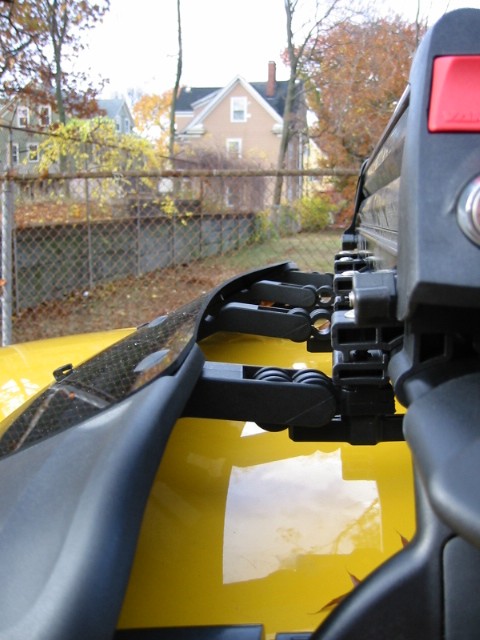

    i checked out both the yakima and thule fairings... if you take a look at the yakima fairing install it, seems the the outer brackets are specifically made for round yakima bars, which we don't have:
    http://www.yakima.com/instructions/1032276b-instr.pdf
    With the Thule fairing, I cut off part of the square bracket (as instructed by manufacturer) and threaded the screw though the upper bracket and mighty mount assemby, then tightened everything down.
    I wanted to go with Yakima, since the rack components are Yakima. But the Thule fairing presented more viable mounting option. I just installed the Thule fairing in reverse so the brand name is not facing outward.

    also, can you post a better detailed pic of how you installed?
    i went with the square bolt in the track of the rack bar (per instructions) i didnt see anywhere where it said to cut the square box off the back. as it stands now, i doubt i will be able to mount my ski rack to the top, as the tri wing nut seems to be in the way
