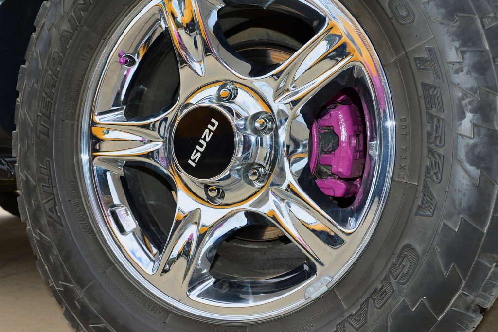

    And it will MATCH my brake calipers - how kool is that!! - - -
