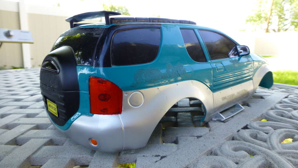

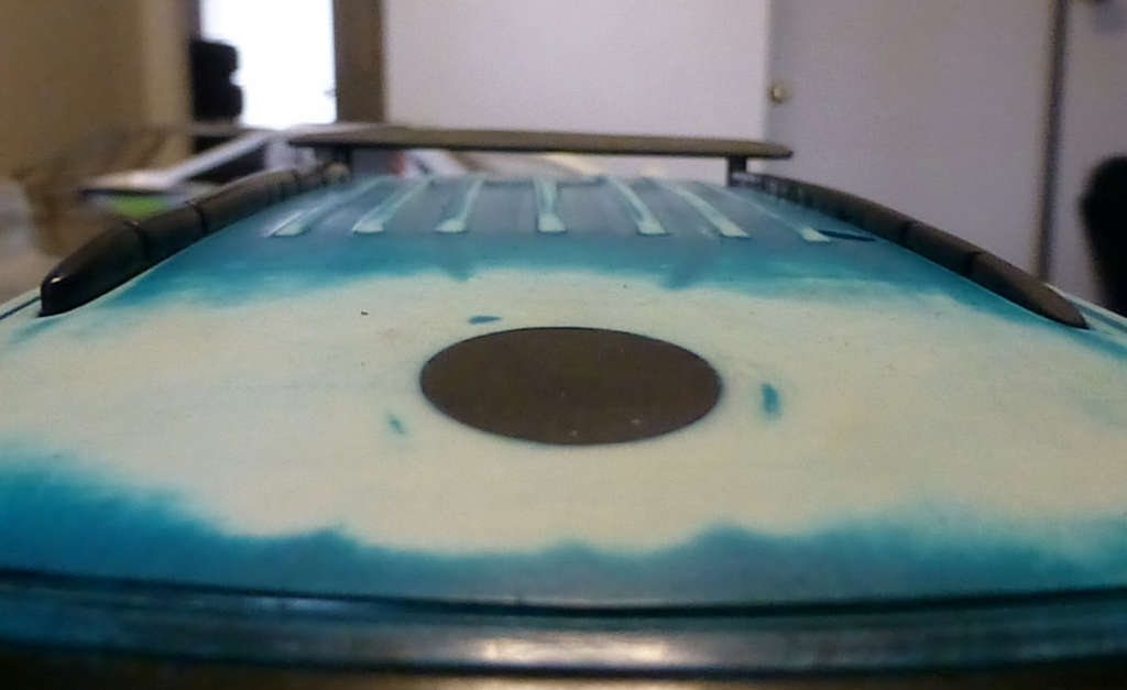

Man, good progress. Gotta be careful with those harsh chemicals on that plastic. Have you tried just Mineral Spirits?
Bart
Bart

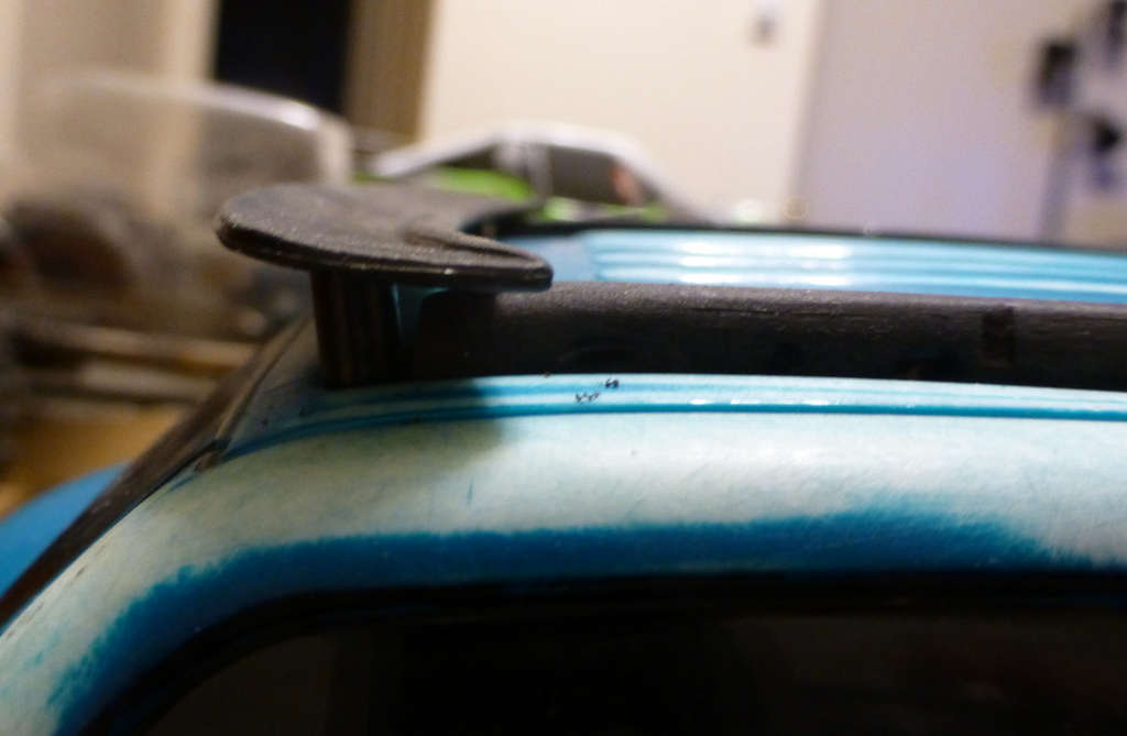

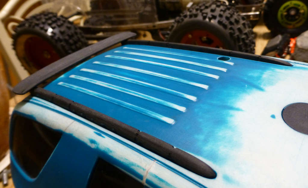

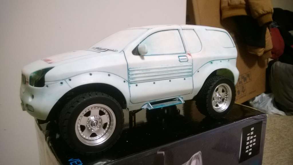

I'm sure I have mineral spirits somewhere but can't find it - you know how my house is! Haha I'm glad I sanded the whole thing anyway because I got rid of some high spots & pointed out some low spots. The windows were the toughest parts to get thru. They had the blue paint & then the black paint on top so there was quite a bit of color on there. I truthfully think sanding did not take much more time than using chemicals would have being that I still would have needed to sand before & after primer anyway.

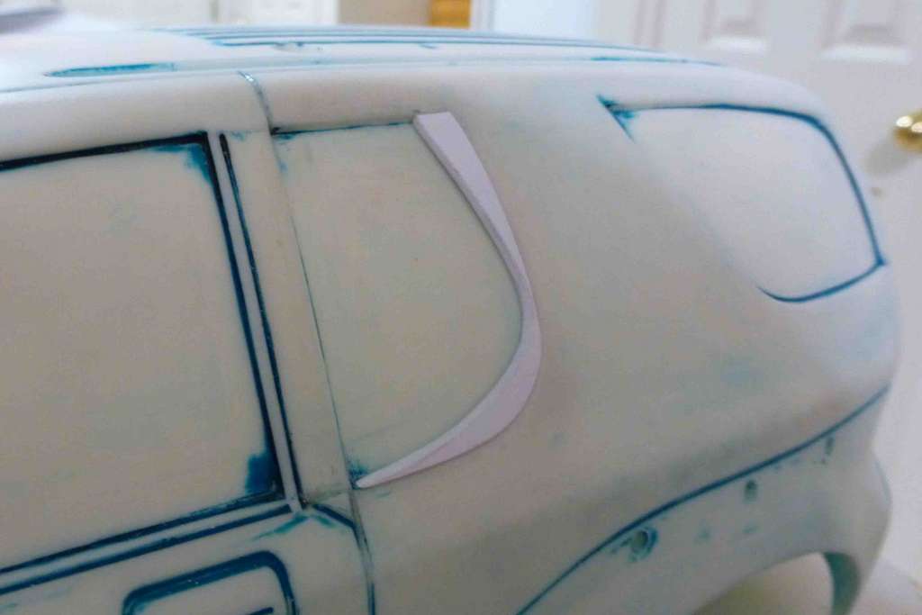

With the styrene I acquired I got to measuring, sketching, transferring, cutting, & filing something I find important for the project design.

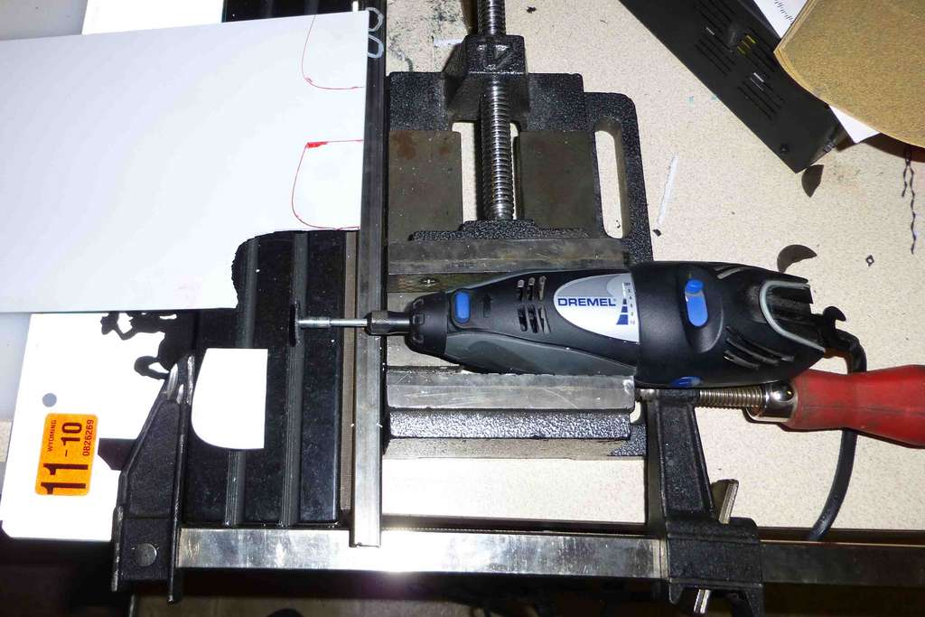

I clamped down my Dremel & then clamped down a make-shift cutting table:

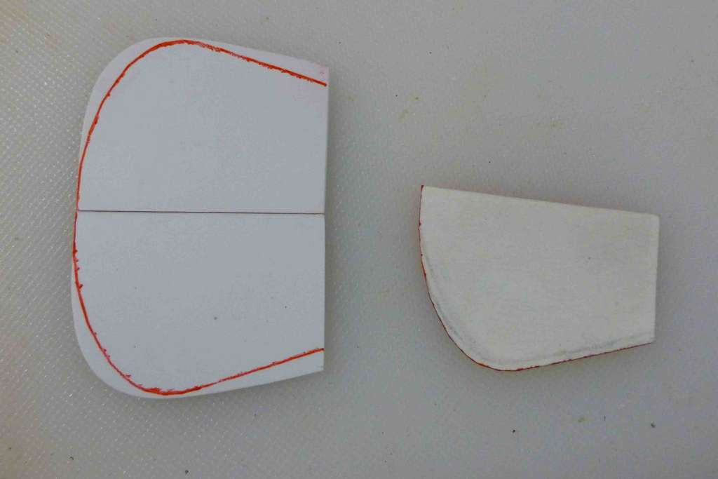

I cut out a few blanks, just in case I come across another VX body from across the pond one day:
The first pieces didn't come out quite up to my standards so I started again & nailed it:

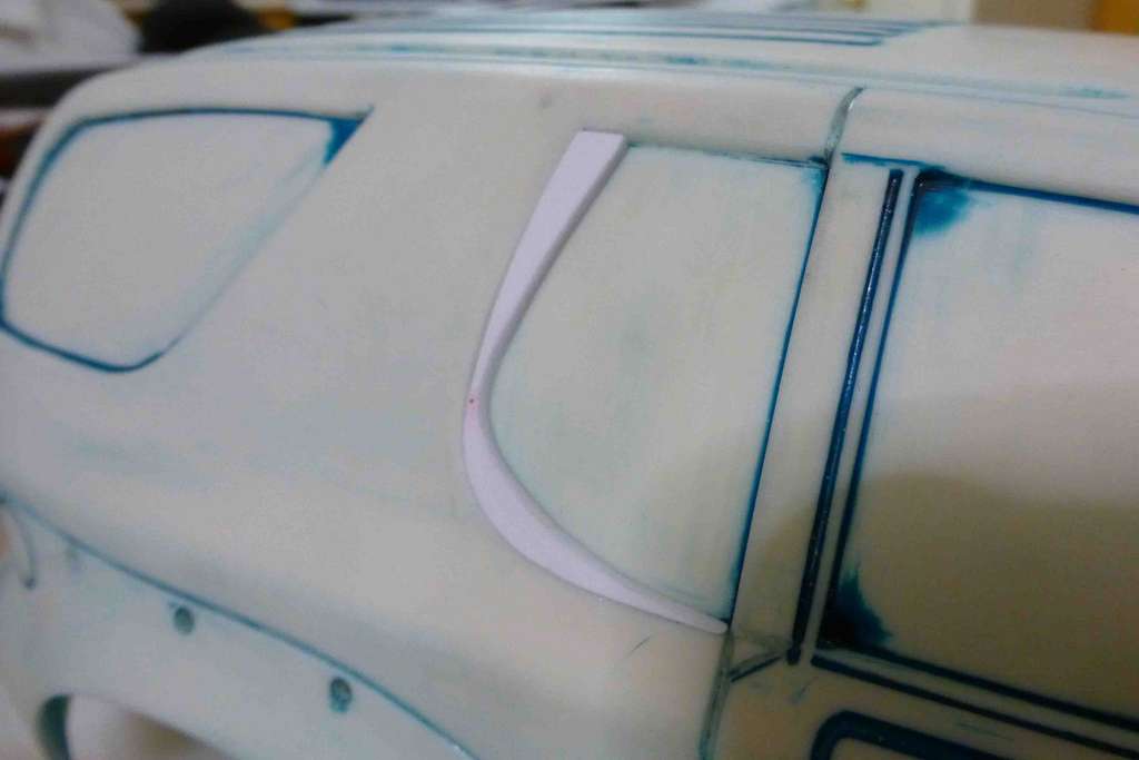

Here is a piece taped up against my on-screen template:
Much better, right?! I am not going to glue them on just yet. I am contemplating cutting this body into three pieces to adjust the wheelbase by 10 mm. The wheelbase is spot on 1:10 scale as it stands but the overall length is 20 mm too short (based on schematics I have been viewing). A 10 mm stretch would better even out proportions in the rear side windows, front fenders/hood, wheelbase, & overall length. Besides, +10 mm would also bring me to the wheelbase of the chassis kit I have been thinking of using for the future copies... If I do end up cutting it apart I will also dove-tail the rear end a little bit because that fat butt is killing me. As Joe Isuzu said, "Go Farther." It might be time to order that IFS chassis to help me make these decisions before I go... "Too far."![]()
Back window looks good. It's a shame these VX toys are difficult to find now. If you had like 4 or 5 of them, you could really do some engineering to make a perfect scale VX.

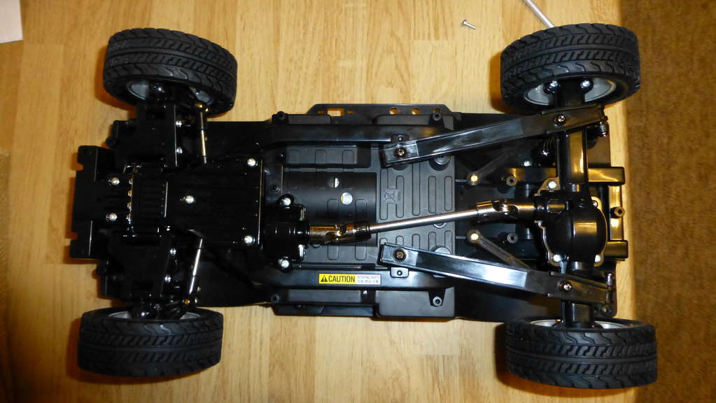

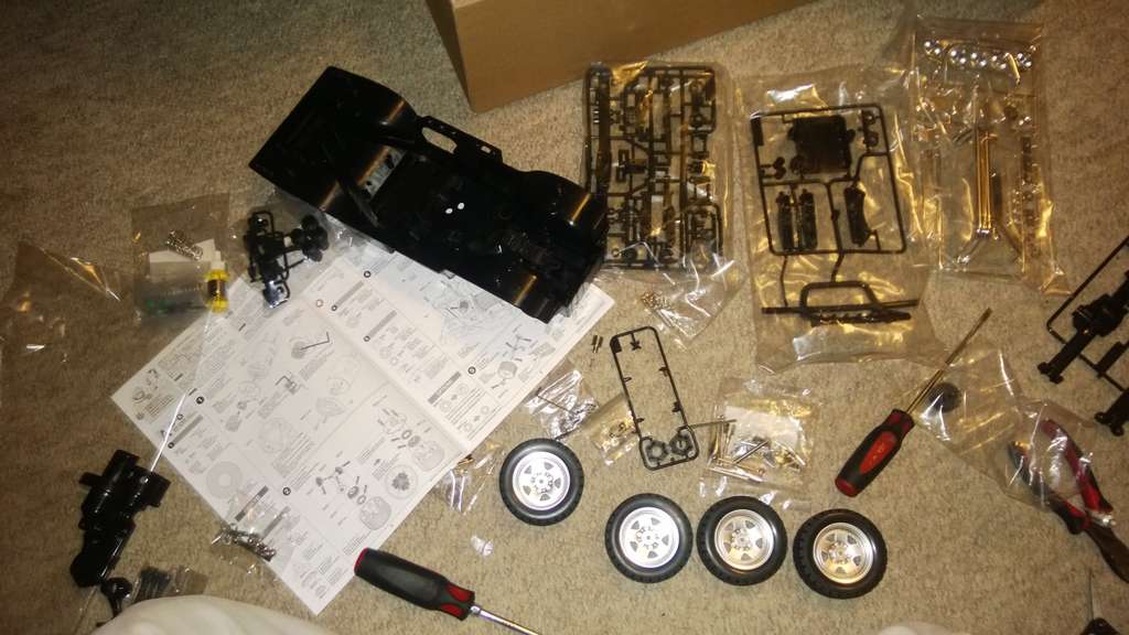

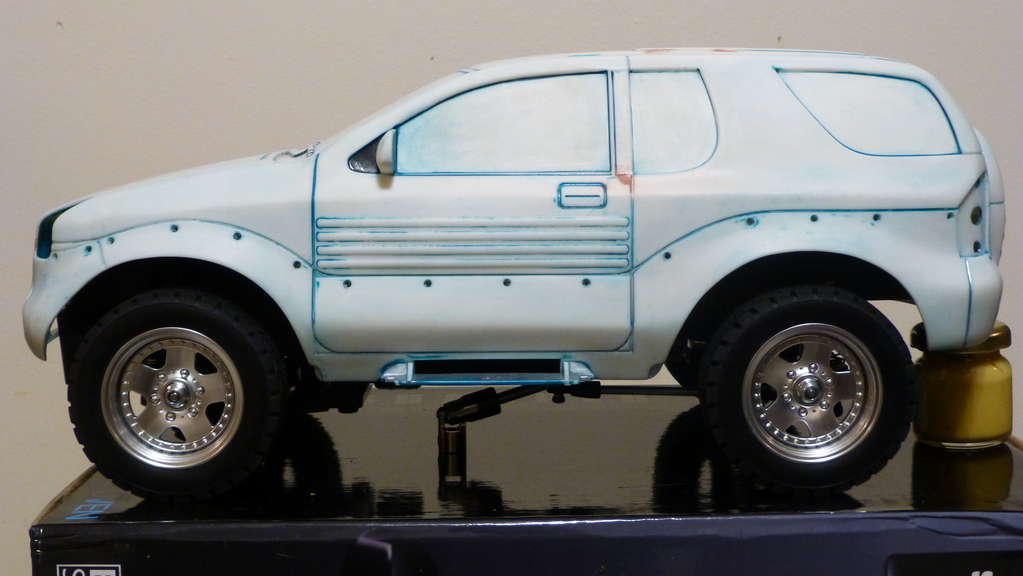

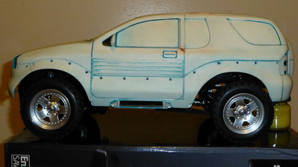

I ordered a Tamiya CC01 chassis in the "Landfreeder" variety as it is the cheapest option & includes the tires in a 31" size. If I were to recreate some RC VX's for others, this is the chassis I would build upon. It took me about 5 hours to assemble & comes with a motor & esc. It just so happens that the included rims are very similar to what I put on Zeus too!
Assembled chassis:
I already knew the stock CC01 wheelbase was 10mm too long for the VX body & here is how much of a difference that is.
I did not take any pics as I was working on it but I picked up (2) 2.25" long all-thread & screwed on some rod ends to make the shorter lower links. I also took an upper V link from an HPI Wheely King, cut it down, drilled some holes, & screwed in two rod ends there too. I need to make shock brackets on the axle side & cut the driveshaft down. I also figured out a way to lift the chassis-side mount of the lower links for better looks & ground clearance. At least now I have an idea of what is involved to merge VX shell to this chassis if I end up making more of them.
So Zeus Mini is coming along! Check out the similarity of the wheels & the tire size. Close enough for me!

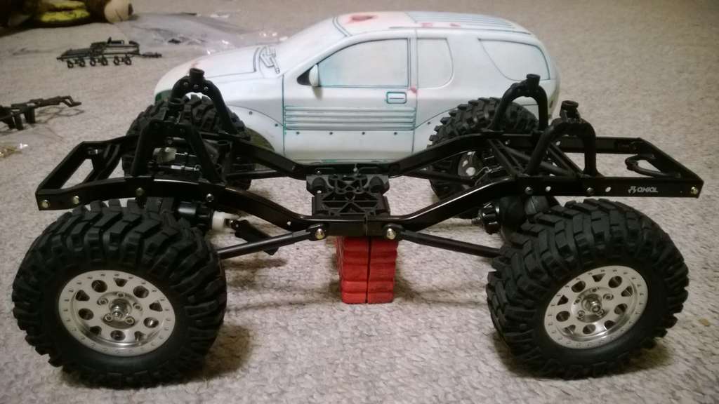

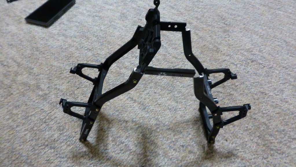

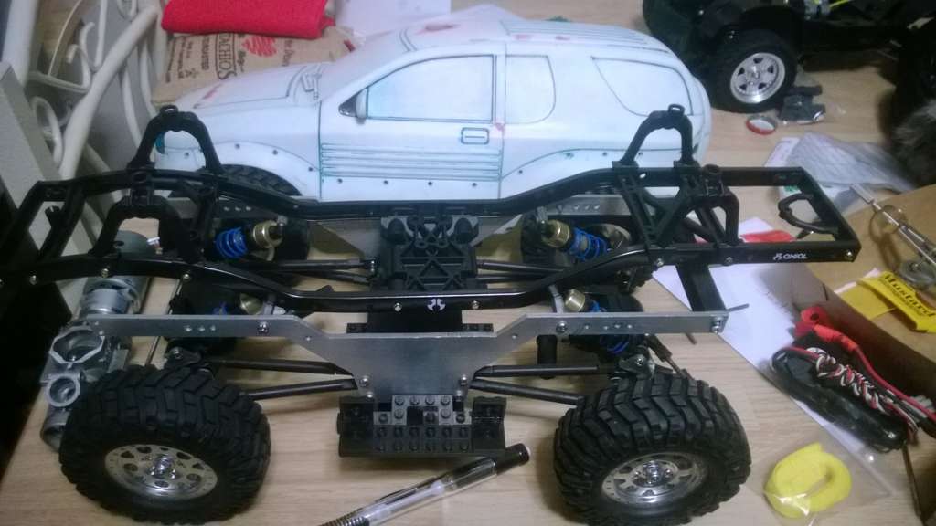

So then... back to the solid axle chassis! The mock up chassis & setup has served it's purpose but is on its way out for a true frame rail-type chassis. I ordered the frame kit for an Axial SCX-10 crawler to start from. I also ordered a zinc-coated hex-head hardware kit for that extra touch of realism. The problem is the VX wheelbase is so short compared to everything else out there! Jamming everything into a 9.2" wheelbase versus the 11.5-12.5" norm is a bit tight to work with! Here we go:
See, way too long:
I got to hacking 2" out of the middle & made a transformer:
That cut made the frame fit just right within the underside of the shell & it put the shock mounts in a usable location for this wheelbase.

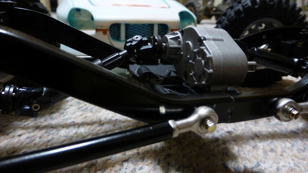

The next obstacle is driveshaft lengths & angles... I need the most narrow transfer case or transmission I can find in order to have usable driveshafts. So far it seems to be the HPI Wheely King transmission which I just happen to have an extra of! It will not allow me to create an interior though so if I use it, it will be temporary. The new axles I ordered are on backorder with no eta but they cost $300 for the pair! Ouch. The planetary trans I think I want to use is also on backorder, as is the t-case I thought I could use. The t-case may be too thick tho. Fun fun... OH YEAH! ...A driver is also on the way...![]()
