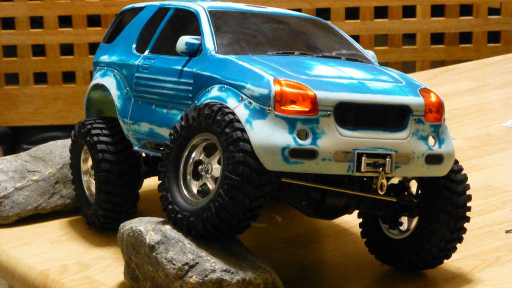

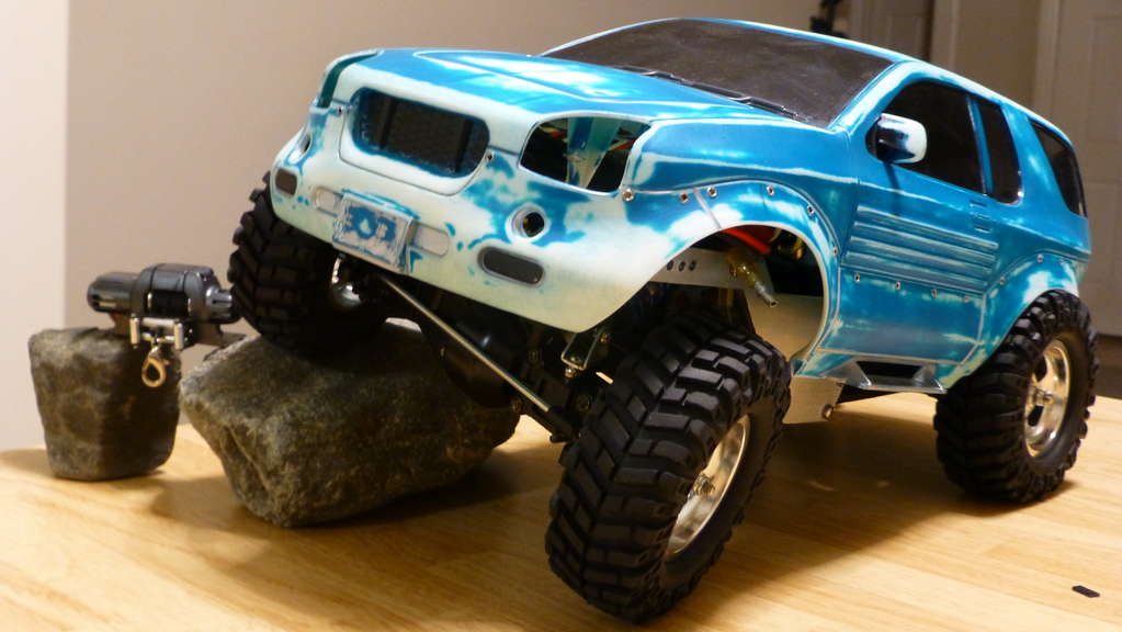

    Got the Mickey Thompson Claws mounted up on the temp rims! Fondled the winch... (the most action I get. ) Modified the driveshafts to fit the short wheelbase so the drivetrain is all hooked up which means I've got myself a roller!
    The body is not mounted yet tho; just placed there:
    POSER!
    I cut out an opening for the winch - it is just taped in right now. Notice in this pic the pencil lines above the front bumper cladding. I need to move the cladding seam to this location to be more accurate:
    So 37" tires on essentially 20" rims. The rims will be swapped out at some point as they are not scale enough. Otherwise...
    I don't like the shape of the headlights - too boxy.
    Front bumper cladding looks pug-nosed.
    Front bumper cladding seam is too low.
    C-Pillar is shaped wrong.
    Tailights are too big & squared off.
    Hood line at windshield is wrong.
    Mirrors look goofy.
    Rear window is mis-shaped.
    Door seam shapes are not accurate enough.
    Fangs need some pizazz.
    Gas filler door needs more detail.
    Rockers need filler.
    I also noticed it has JDM windshield wipers - on the opposite side than US.
    Sooo.... I will be reworking the body to better resemble a VX. This will take quite some time but I feel it is worth it in order to create a nicely detailed & more accurate mold... Yup, I plan to make a slush mold of this reworked body & it's parts! One scale VX is just not enough! I hope to make at least 5 copies but it is not all that cheap due to the materials. I don't want a mis-shaped lexan body; I want a hard shell with detail. Add chassis, electronics, & parts - this is a $500 toy! But a very cool toy! If (when) there is a poor copy, if the doors end up usable enough to cut & graft, I could make a VX-4. If a copy ends up with a thin or warped roof, bam, VX-02 under way.

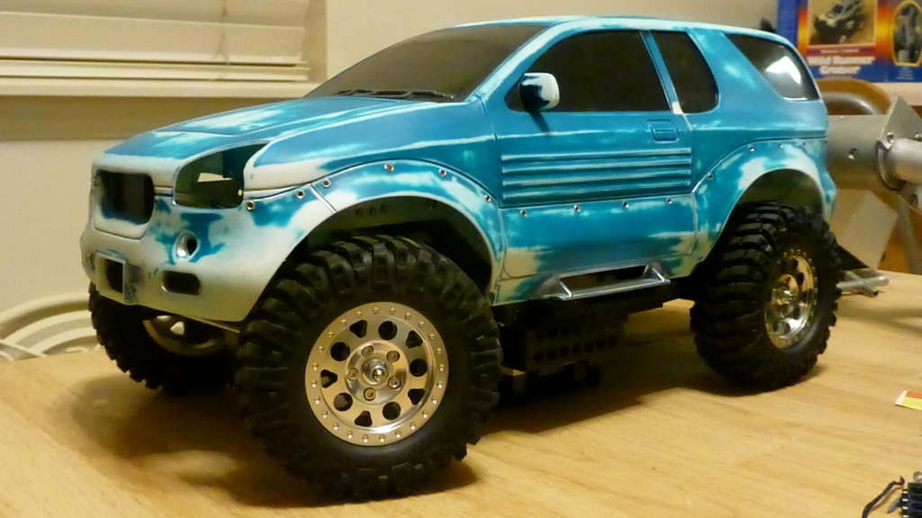

    Well, I have made some tiny (get it?) progress. Then again, research is progress, it's just never seen with the eye.
    Just for entertainment sake - here is my collection of RC crawler projects:
    From right to left -
    Wheely King base - Chassis was CAD modeled, built, & brazed by me - It works & is fun!
    Axial AX10 - All green aluminum - I call it Mary Jane, The Cannibis Crawler. It just sits around.
    Kyosho Mad Force base - drill motor with 2-speed trans - work in progress.
    (Behind VX) CEN Genesis-based axle parts inside custom-machined chunks designed by me - the project got too expensive to continue... for now.
    THE VX!!! TLT axles, Stampede trans, K2-S Chassis... for mock up only
    I ordered new wheels (which are the most inset beadlocks available) because they have been discontinued - you can see they still stick out with these TLT axles. They are RC4WD Enduros, based off KMC Enduros. I think they look great with the MT Claws! Notice the raised front bumper cladding edge I carved in last night...
    You can see in this pic why I am trying to improve the geometry of the shell to better match a 1:1 VX. Lots of carving & filling to do but the carving is coming along pretty well, I think.
    I picked up some Bondo filler & some Shoe Goo today. I've only had slow & steady progress over the last week, so that's it for now...
