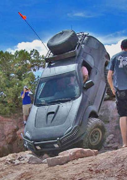

Hood Scoop...

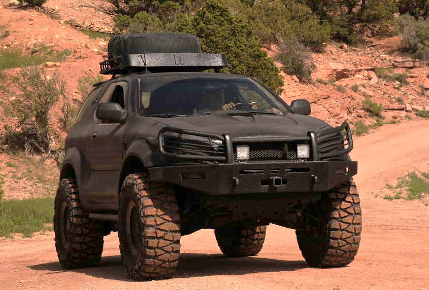

Rock Bumper ( with brush guard..will offer rock bumper ONLY) :-
Hood Scoop is non functional..but easily made to extract hot air if you so desire.
Fashioned from a cut down Camaro Scoop ( props to VXFocus!).
I'd suggest sending me your insert, I mold it on, fill , fair and primer...and send it back.
( Line-X finish or satin black available as option).
Scoop drains through holes in "Horn" ends..and has mesh over opening.
Price ( given I get 3 or more orders) will be $435 plus p&p.
Rock Bumper...is expensive...but in line with similar "Off the shelf" bumpers ( see shrockworks.com)
I'll produce it without the brush guard add on....too many different styles to suit all tastes...plus the one I used it tough to find/expensive.
Bumper fits to a custom plate welded to/across front of frame rails, with 5/8ths bolts welded to it..will come ready to weld to frame.
This plate matches up to a custom plate welded to bumper with holes for bolts.
10 mins on/off..SUPER STRONG.
Outer 'wings' of Bumper will be cut/welded/filled & modified to fit line of Cladding as per my pics.
You will need to ...cut down your existing cladding and remove OEM crash bar to fit.
## side note...buy a damaged cladding cheap...sell your good one for $250-300...AND...sell your good OEM crash bar for $300.... recouping $500 plus on cost of Rock Bumper.##
OEM Turn signals will fit Rock Bumper...you will not have the round "Fog lights" anymore....harness can be used for optional lights you want to fit to Bumper.
Winch will fit if you cut down your grill...I chose not to..I welded in a receiver for a plate mounted winch I can use fore & aft!...this will be an option ( plus $65)
Sent to you either Line-x'ed or primer....Line-X will add $120 ( sprayed inside and out!)
Price ( given I get 3 or more orders) will be $1440 plus p&p for primered Bumper, no receiver.
(So..about $1000 if ya cash in cladding and OEM crash bar)
