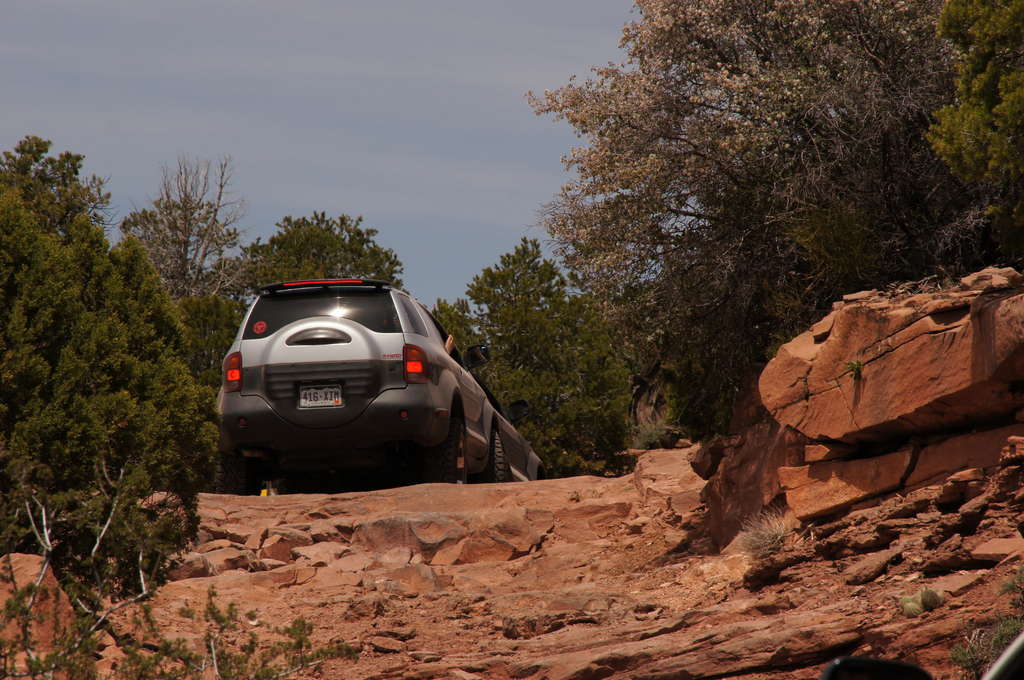

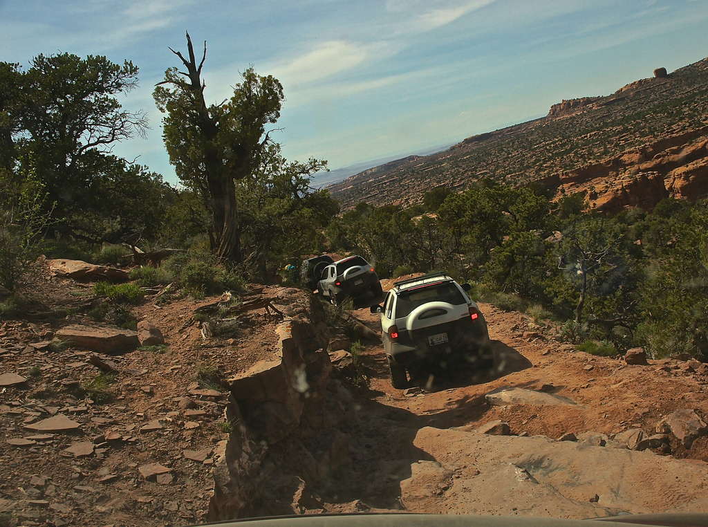

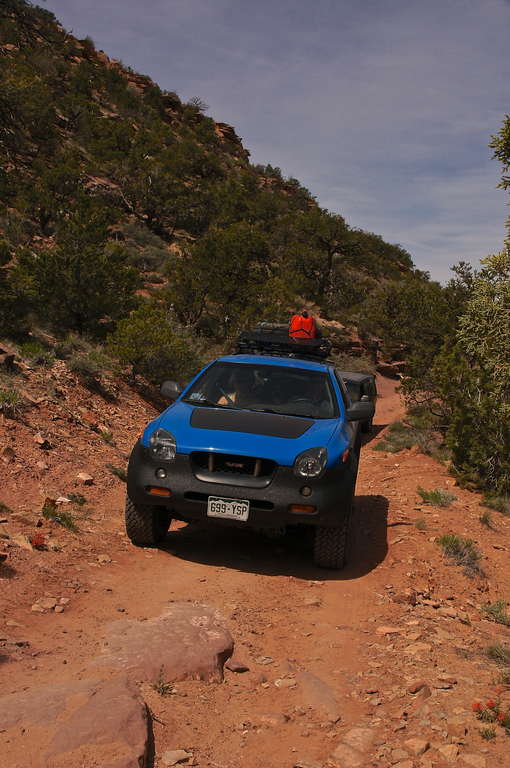

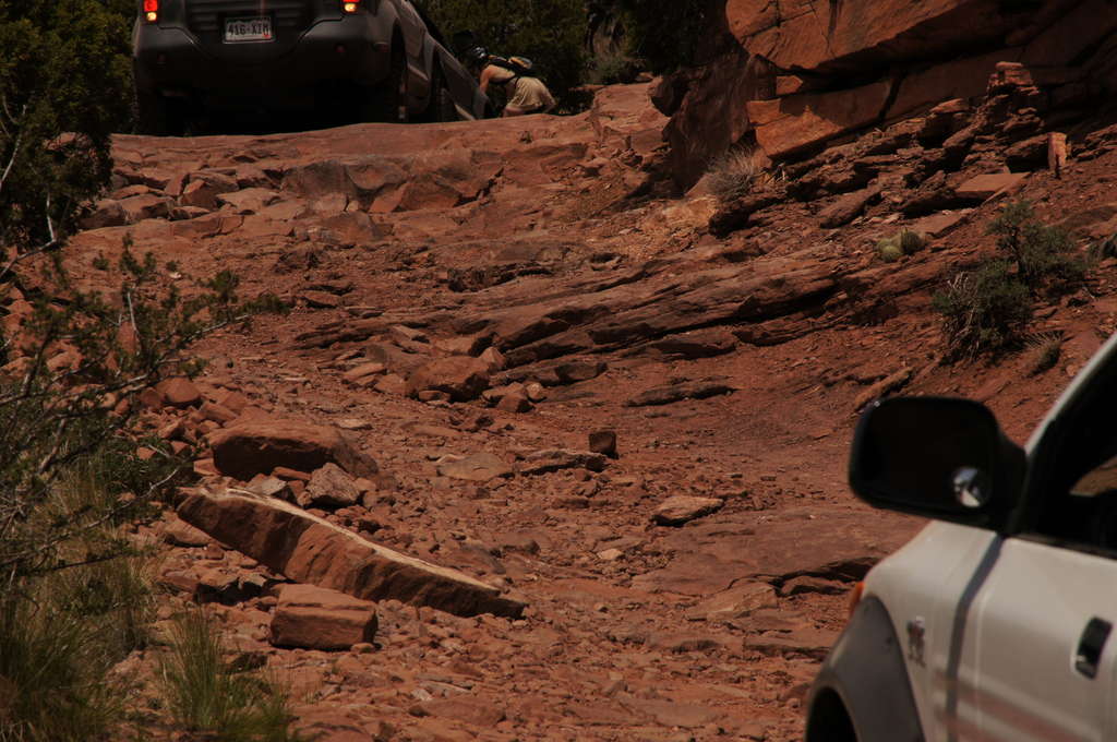

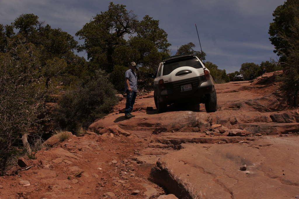

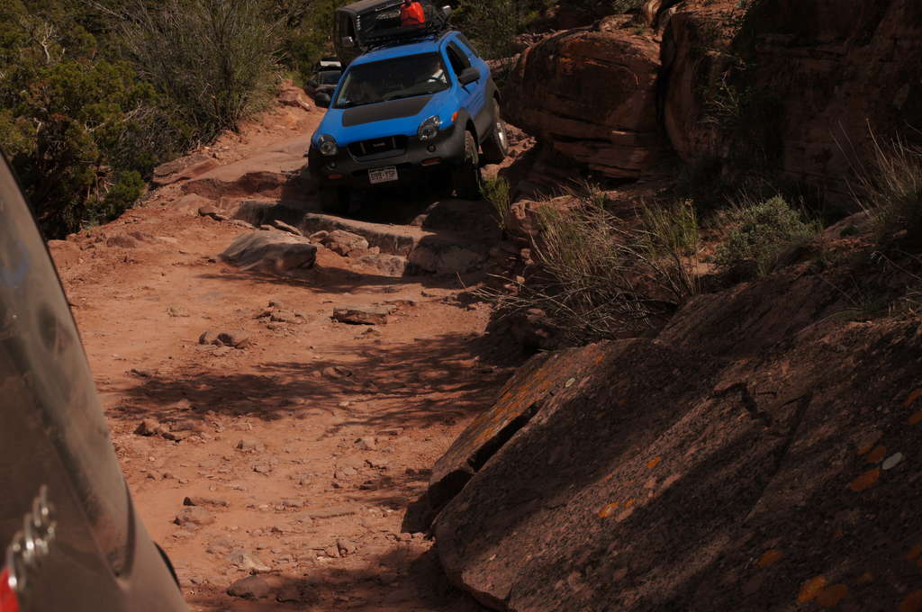

    Interesting Porcupine Rim is listed in the Wells book as Easy, whereas Hells Revenge and Fins-N-Things are listed as Difficult. I thought it was a little harder than "easy".
    On Porcupine you go up and back on same trail, so some of these pics were harder going down. I know I slammed down on a few of these, any one could have caused my damage. Look at all those potential hits to the Driver side LCA!
    I just took some bad lines, wasn't careful enough on some areas, and have no one else to blame but myself.
    A stocker could still easily do this trail.
