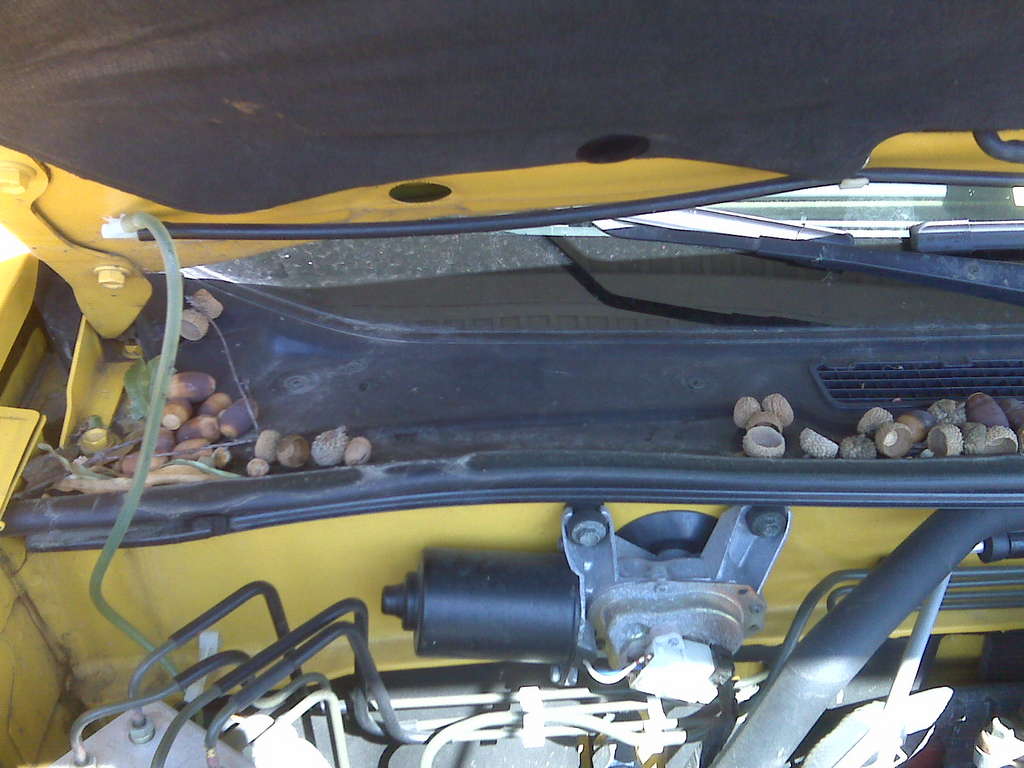

    Here's what my rattling ended up being:
    Nov 2012
    775
    Tom just can't pass up an opportunity to show off his nuts!
    SSHHH!!!
    Wifey doesn't know
