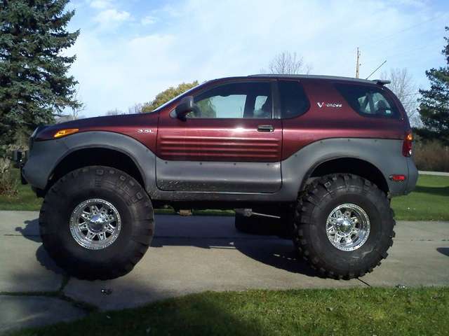

    thank on the 03-06 rubicon, i havent thought of that. But what i really want to do is have 38 to 40s on the cross and tall enough to not cut the cladding. I know it is a big task i would be taking on and im not sure if im would be ready for something like this, not without more research. But i have never seen a vx with anything bigger then 35s

    How is this vx with 37s lifted? I would really like to go a little bit taller with the vx. I seen the pics of the one with the 40s but i dont even think they are bolted on. Is this vx yours that has the 37s???
    37s
    40s
    37's have lots of cutting/trimming
    40's was just for pics...not driveable unless you just want to drive straight

    I posted the VX on 40s to support Billy's point on necessary cladding cutting. Even my 35s required a bit of cutting. So, 40s would never work unless you removed all of the cladding.
    The one on 37s has a build thread I linked below. The owner said he had some steering issues which is be common with custom SAS builds. Usually an SAS with larger tires is best as a trail rig that's trailered everywhere.
