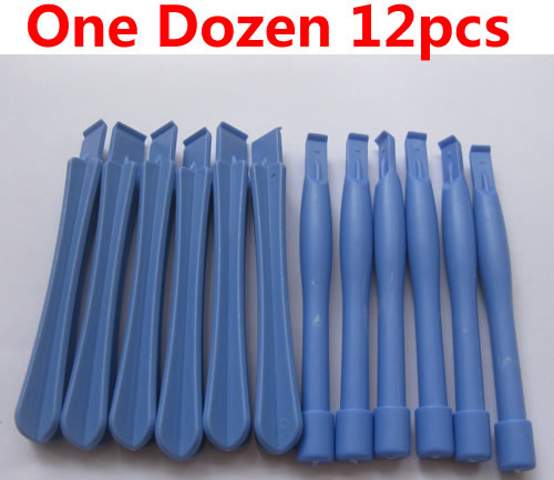

    Or use an edge of a credit card, or one of the plastic pry tools they use for electronic equipment like cell phones and such. They have a very thin edge so they can pry open the battery doors etc without scratching.
    I got a bag of 10 of them on ebay for like $2. They break easy for the stuff I've ALSO used them for….…but that must be why they come in a 10 pack.
    I didn't want to use any type of metal screwdriver because too much risk of scratching for me.
    http://www.ebay.com/itm/5-Plastic-Pr...item4aabdbd0e0
    http://www.ebay.com/itm/12x-Plastic-...item3378e5eca5
