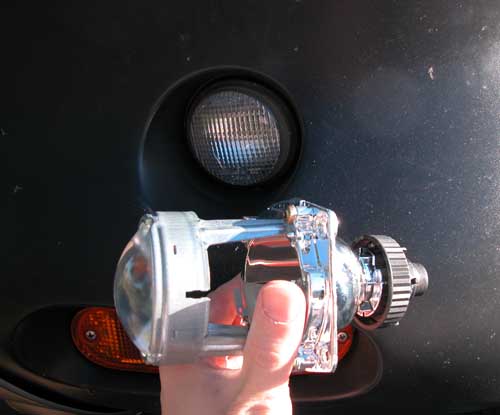

I already briefly posted about my debates concerning this mod. I went ahead and purchased the HID projectors used on the Audi TT, with the intent on installing them where the parking lights are now.
Just out of curiousity- does anyone that's installed fog lights in this location happen to know what depth I have available from the inside of the cladding back to wherever?
Some cars like the Infiniti QX4 have manual headlight levelers, where you can adjust the headlight from within the car.. that is a cool option as well. Getting your headlamp to perform well without blinding traffic on uneven roads will be a tough challenge, be sure to keep this in mind.
