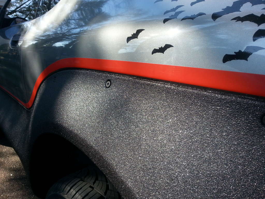

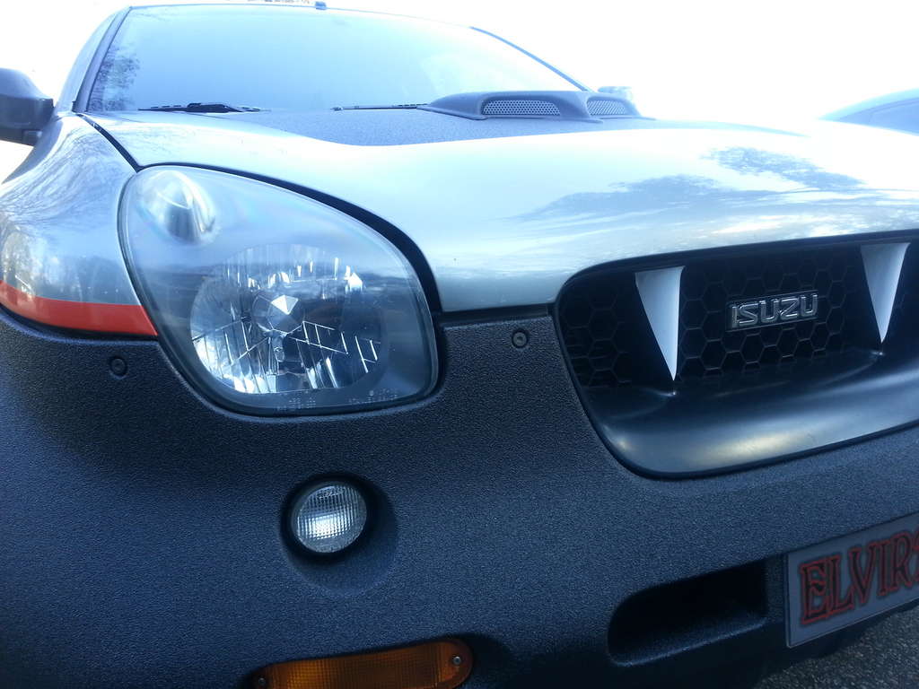

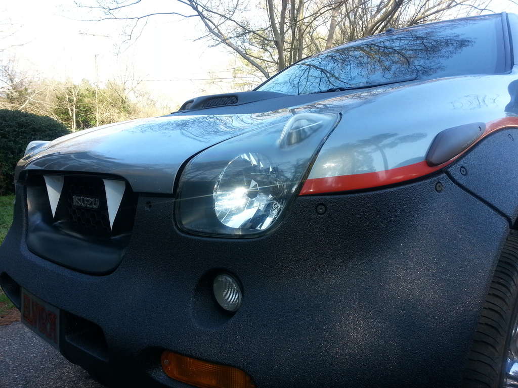

    So, we had my wife's Vx "Elvira" Line-X'ed yesterday and the results are incredible. This truck came with cladding that had the typical fade, and having been a Florida vehicle previously, it really needed attention. I had attempted Showroom New, but it was not what we were looking for. The Line-X is beyond expectations. I highly recommend it. The owner of the Line-X dealership was excited to do a Vx (He has owned several Troopers) and wanted to make sure it turned out right. The job took all day-- we brought it in at 9AM and it was finished around 7PM. We got a lifetime warranty on the finish-- even if the truck is in a wreck (heaven forbid). It cost $600 to do the cladding, and hood insert and worth every penny. Here are some photos:

    And all I've read about it in forums about lots of make and models say it's all about the prep. If they tell you it's going to take a couple of hours, beware. I checked in throughout the day and they spent all day with a chemical etch, then sanding and a primer coat, then main coat, then UV coat. The actual bill was $550 for installation and $50 for the materials.

    That was black, but the texture can be changed. This was a pebbly texture, the smoother ones appear darker. In person, it appears very dark. You should stop by a Line-X dealer and look at the samples.

    I was just responding to a post questioning the ability of Line-X to adhere to the plastic cladding over the long term. I did a lot of research into this, reading posts on many different forums. The Line-X product has advanced through the years to the point that they do a lot of cladding on a lot of kinds of vehicles with great success. The lifetime warranty on cladding is by dealer discretion. The nationwide warranty only covers bedliners. So make sure your dealer will back it up. If there is any caveat, it is that the texture allows mud to get caught in it and the best way to clean it appears to be a bristle brush. I'm thinking, too, that maybe spraying something like silicone spray on it before hand. But the photos I've seen (including some Vx's) of whole vehicles Line-X'ed look really cool. That one done in blue Line-X is sharp and the one done completely in black with the snorkle is great, too. Couple of more photos showing texture. It isn't as glossy as this looks. It has more of a satin sheen .
