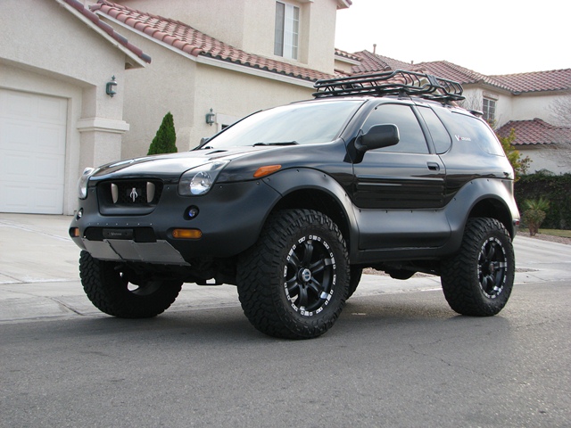

Some people have been asking about my front skid plate, so I thought I'd do a quick thread on it.
So, I got rid of all my old stand up jet skis, and had a few parts left over.

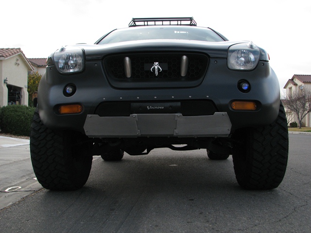

The skid plate is actually 3 aluminum ride plates from Kawasaki 650sx jet skis, cut, shaped, bolted together and mounted to the front of the cladding. But, if you remember my previous attempts, I had removed/cut the front cladding area where the VX02 skid plate would line up. So, this new one pulls everything together perfectly. I also added the stock intake ports back behind the openings.
I surfaced them using a handheld belt sander.

Here's what my new skid plate looks like:
					 My Aluminum Front Skid Plate
