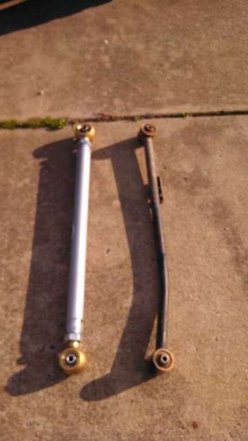

    I managed to get the worst one off the truck today. Some prying, a 1.5ton breaker bar (I like to use my jack on the breaker bar, I am out of harms way and can control the force far more consistently) It actually wasn't as bad as I thought. The perch is long enough that it has some flex to it, so I popped a cold steel chisel in the gap and pried it enough to get a real pry bar and the rear link popped out. There was no tension on the links, I was waiting for a pop or something when I punched the bolt out. Notta. Some flashbacks to the whole driveshaft thing. I overcame that and got the new link in. About 1.2 hours to do one side start to finish, not bad at all.
    I did say "Damn You Matt!" at one point. Lifting the new link in place, got the bolt through the ball joint and wouldn't you know it, different size bolt than the OEM. I crawled out from under the truck, correct size socket and wrench in hand, and damn it all, the nut is a different size than the bolt head. Another trip from under the truck to get the right wrench. Managed to get both in with minimal issues. They are well machined, I can adjust the rake by hand just by loosening the locking nuts and turning the tube. No wrench needed except to lock the nuts in final position after adjustment. Tomorrow will do the other side and take it into Firestone for lifetime alignment, just got a 25 dollar off coupon and they do military discount too.
    Here are a few pics of the links side by side:
    The bend in that link is way more than the bend in the other side. I think that is the culprit in my popping sound when I first turn the truck each day.
    There is no mount on the new tube for the ebrake cable, but I am not concerned, that line is pretty stiff and now it is well protected by that monster tube of a link.
