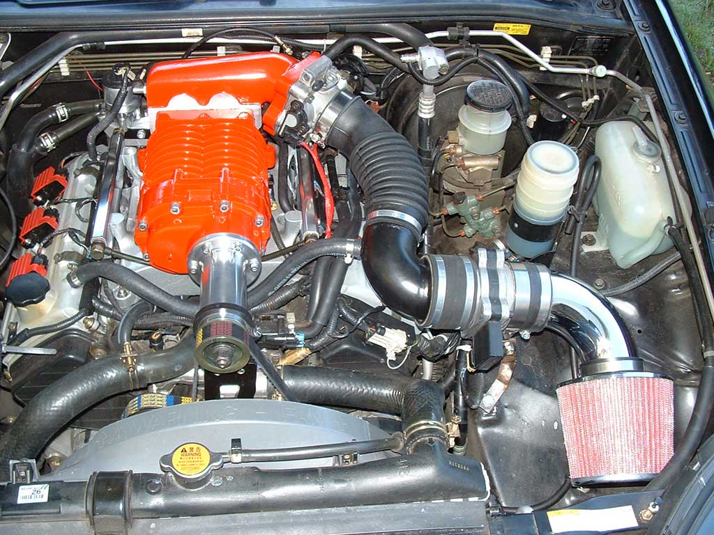

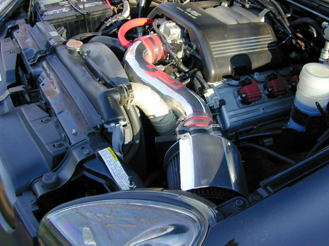

I used to... but now I have S/C, and am hacking it up to fit.
The unit was a bitch to get as the guy Don was working with hotshots to fabricated it for his trooper,and assumed that it would fit the VX... but it did not clear the hood....
Was a nice looking unit, the butt dyno felt it little, no dyno #'s though.
I also had a Injen intake before and before that the Calmini filter, they all felt about the same.
Mine w/ HOTSHOTS:
Mine w/ INJEN:
SPAZZ w/Calmini:
Mine w/ HOTSHOTS & S/C (not finished yet):

The Ingen Intake was for a 97 passport. It had to be rotated to fit. Problem with it is that it lays on the top radiator hose and transferred a lot of heat.
The Hot Shot intake solved this problem by looping up over the radiator hose. It was made for the Trooper, though, which has more hood clearance, so the Hot Shot had to be cut and recoupled, rotated to clear.
