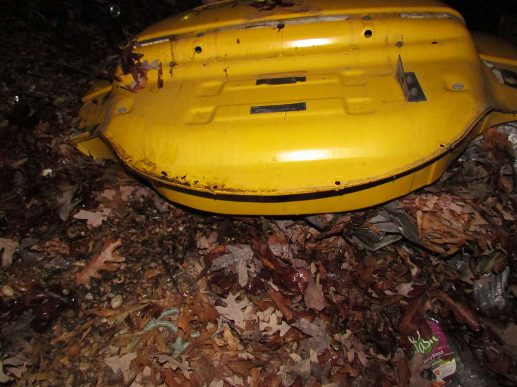

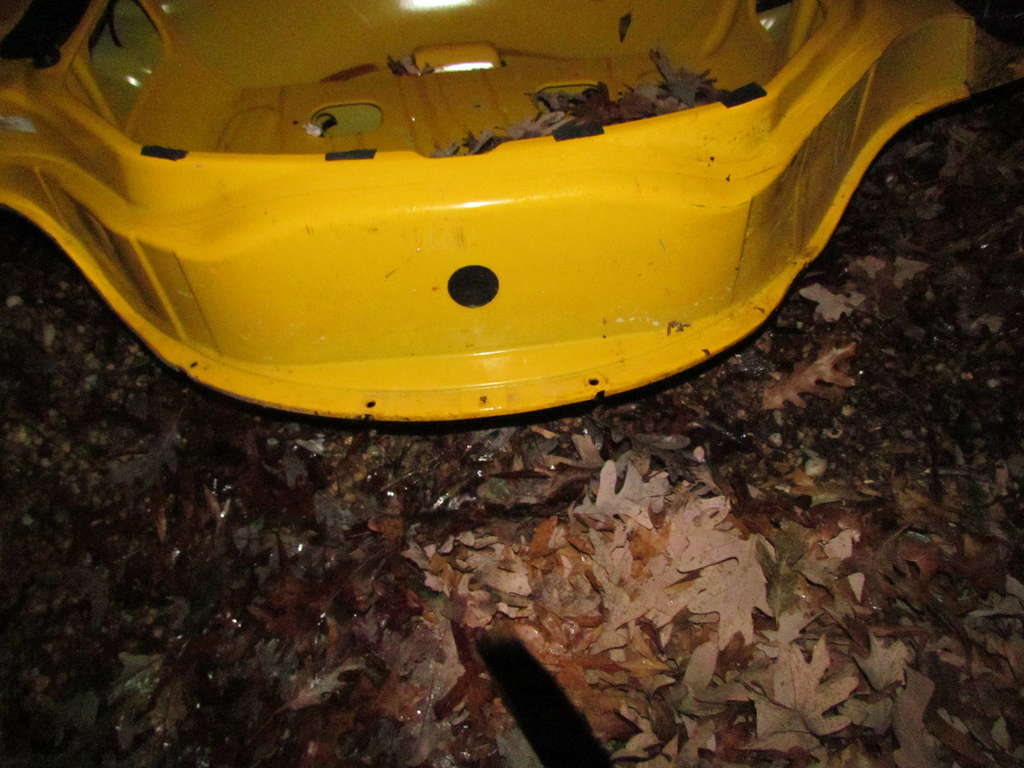

    Wondering if anyone here has thoughts, ideas, input, etc on this below. Would greatly appreciate it!
    My VX had suffered a slight rear ender where the bottom most part of the tailgate just below the license plate had bent in. No issues with tailgate door alignment, rear bumper below seems fine, just the tailgate door bottom got slightly pushed in and now does not line up with the lower bumper cladding when closed. Other than asking/paying a bodyshop, any thoughts on how to bend back that part to its original shape without collateral damage? The tailgate door cladding is unharmed at least cosmetically, it may have to come off to get to the metal behind it, who knows. Leaving it as is is not an option, it looks too awkward.
    I'm guessing that it's do-able. I still have my old door with that section of cladding removed. Lemme know if it would help to post a pic of what's behind the cladding.
    If I were trying to straighten it, I think I'd make a sacrificial tool (unless you have access to some body shop tools). Take a 2x6 about 3 feet long. Cut a 1 inch wide, 4 inch deep knotch in one end (sorta like a 2 prong fork). Use it to try and bend the damage out ... GENTLY.
    A pic would be helpful sure! I get your idea, and was thinking along the same lines...a steady reverse pressure of how the damage occurred...but it would have to be on the backside of the thin part of the bottom of the door pushing outward. It's the whole bottom that is out of whack, not just the door bottom tip, and even one side of the lower (left) part of the license plate was tweaked inward from the impact, which was a subtle one but had enough force to bend a lot. It looks like a tricky fix to get everything back outward, without removing the door, perhaps a counter force from behind but then I'd have to figure a way to brace the door and also what is pushing. Kinda sux.
    I didn't forget. It's tough to get pix when it's dark when you leave for work ... & dark when you get back home from work. OK, the truth is that I procrastinate real goodly.

    The hinge bolts on the door have some play. I would try loosening the bolts and adjusting the door position. You might get the door to close flush with the cladding that way. Also, I remember the very bottom of the door is just a cladding lip and can easily be bent straight.
    Do you have any pics? I worked extensively with a damaged door when I built the spare tire carrier. The body work wasn't too difficult but it's hard to give advice without pics.
