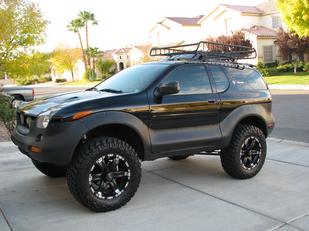

I just went to a local Webasto installer and he quoted $1200 out the door for installation of a Hollandia 730. He said that I'd have to either remove or re mount my roof basket back a bit to clear the tilt function.

Dropped VX off at the shop. They are installing the sunroof today and/or tomorrow.

I stopped by the shop today to check on progress. They showed me three problem areas of rust under the roof rails. Not terrible. I bought some Extend and they said they would clean the rust up and spray it and seal it for me. I'm not ready to tackle that type of project just yet.
The sunroof is coming along great. Actually, it should be done right now. Hoping to pick it up tomorrow morning!
When I was there, they had the hole cut out of the roof. Amazing quality of cut. The coolest thing though... I thought the sunroof was going to be kinda small. Actually, it's pretty big! It takes up most of the flat area (non-ridged) of the roof. I can't wait to see it completed.
The tech said he would take pics for me along the way. I'll post them if he did.
