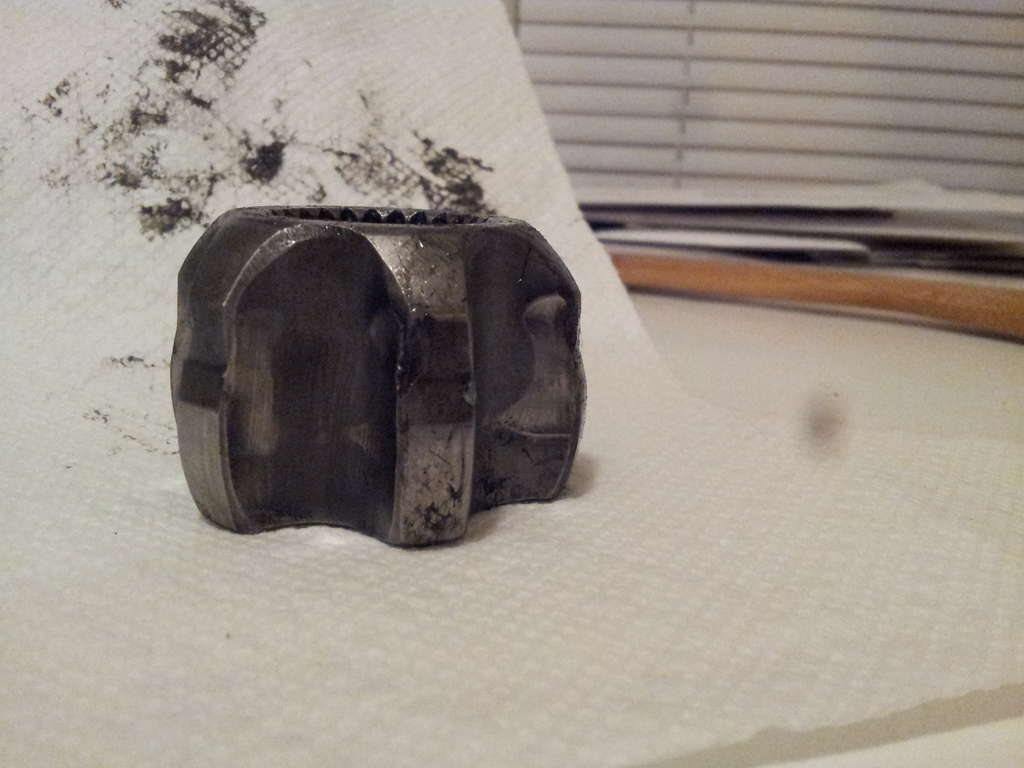

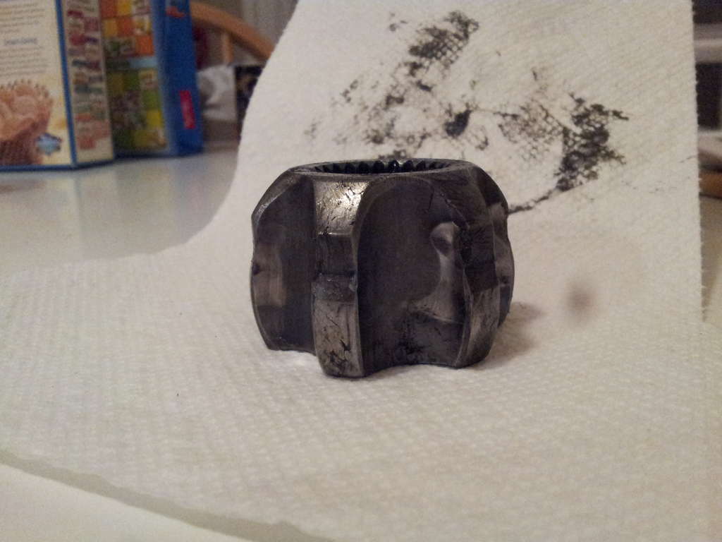

    So I replaced my OEM half shaft with the recommended EMPI shaft last November. My VX is lifted about 3" and the vibration and popping started almost immediatley after the swap. After seeing this thread I decided to pull out the EMPI and replace the balls and cage from my OEM axle I still had. I measured the balls while they were out. EMPI is at 19.8mm and OEM at 20.6mm. So the EMPI is definitely smaller. But here comes the problem; the EMPI retainer uses a snap ring in the cage to hold it in (as noted in the original post), but the OEM cage has a machined lip in it to fit the OEM retainer. Long story short, the EMPI retainer did not fit in the OEM cage.
    89Vette, how did you get these to fit together? After failing on that front I noticed that no combination would work. I couldn't even use the larger balls from OEM and the rest of the EMPI stuff because the holes in the cage are too small. So maybe you can shed some light on that.
    Anyway, I ended up cleaning and rebuilding the OEM half shaft. The only reason I replaced it was because both boots were torn and I was told it was easier to just replace the entire shaft. I figured I would rebuild the OEM eventually and use it as a spare.
    I posted some pics of the EMPI retainer. Note that the EMPI shaft was installed for only a few monthes and the retainer has been badly dented from the balls, and of course this damaged the inner green cup as well on one of the splines. I have only been doing on road city driving since replacing the shaft so this is regular wear. No off roading or drag racing. I can only suspect that the EMPI unit would have become useless in less than a year while also destroying the OEM green cup.
    I just sent RCV Performance a message to see if they retained the information they need to make them for us. I'll let you know if/when they respond.
    Several years ago, when I needed them, they were going to charge about the same as OEM shafts. Unfortunately they weren't able to make them in the timeframe I needed them. Hopefully since they are under new management they will be more responsive.

    Quote Originally Posted by Lucian08 View Post
    You're right. You can't use the EMPI cage with the OEM balls.
    Based on my post/comment about the snap-ring, I'm sure I used the OEM outer cage, the OEM balls, and believe I used the inner retainer from the EMPI shaft (inner retainer is the item you pictured).
    Seems like the length of the OEM inner retainer was to too long for where the snap ring groove was cut...which is why the EMPI piece had to be used. We couldn't tell the pitch/curvature of the EMPI inner retainer was any different than the OEM retainer. Just their lengths.
    At this point, I'm going more off my post than memory.
    BTW...My surgery went pretty well. They didn't yank the part of my brain that likes the Vehicross or Vehicross.INFO!

    At this point, the question in my mind was whether I also reused the OEM inner retainer (the thing pictured above).
    If the OEM inner retainer won't work (wrong splines or wrong length), then you might not be able to do the conversion OR use the EMPI shaft -- without problems. If the EMPI half-shaft doesn't allow the use of the OEM inner CV retainer, my next thought would be to modify it....OR make darn sure the EMPI and OEM retainers have the same arc/curveature. It would be necessary to prevent the type of wear pictured.
    One of us should probably contact EMPI (and/or Cardone?) to notify them of this issue/discrepancy. Could it be that Trooper, Rodeo, and other Isuzu's use a different sized inner cup on their inner front axles?
