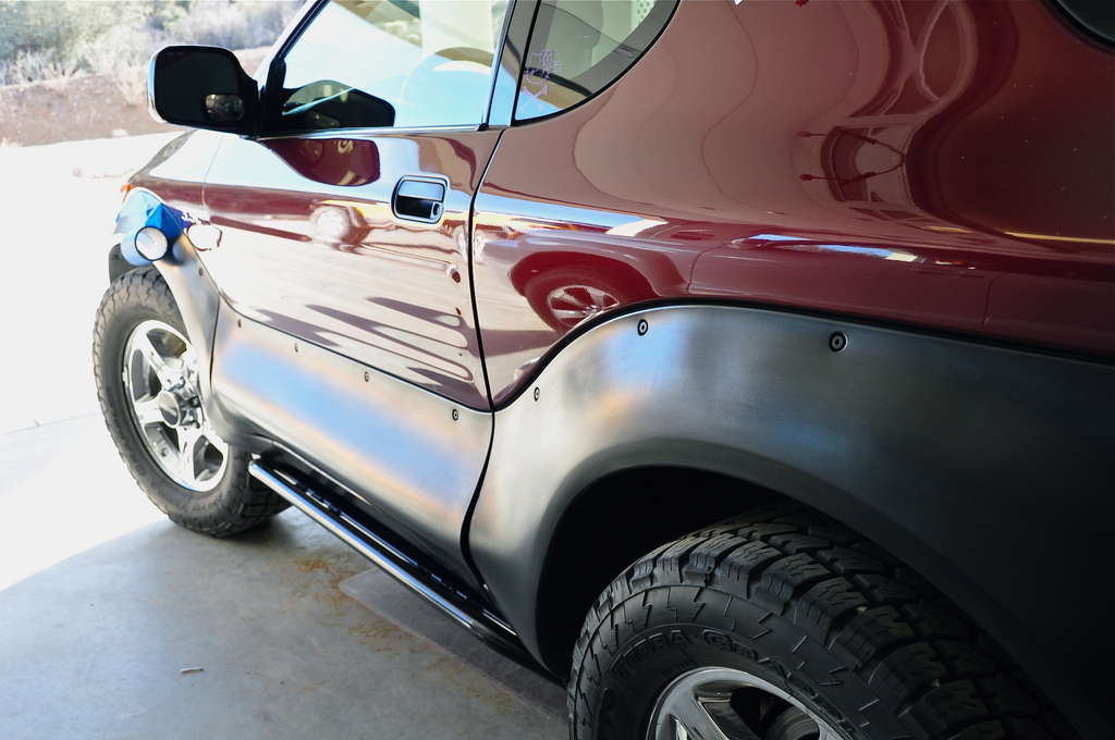

Rocky Road offroad makes rock rails/sliders for the VX, I think they're the only ones. IIRC everybody else made them/had theirs custom made.
Myself and vt_maverick currently are the only two I know who have them right now.

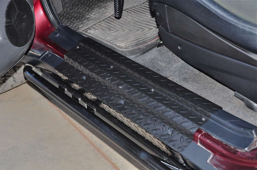

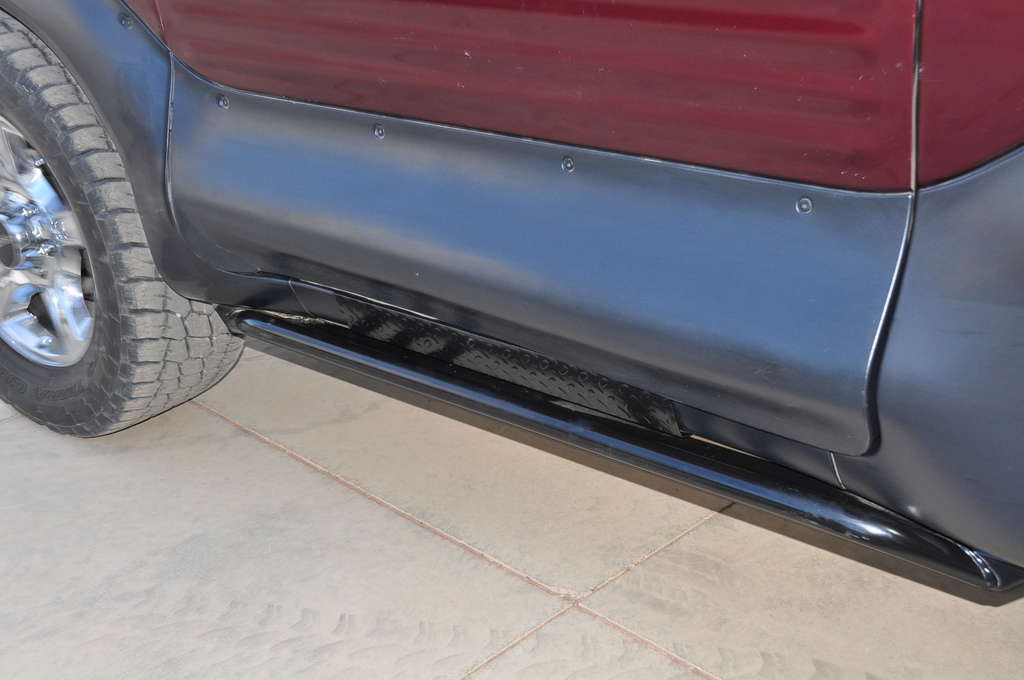

We both have the "Super Sliders" they offer. No trimming of cladding was required.
Can see I sure broke them in this year on Moab!
http://www.rocky-road.com/vehicross-rock-sliders.html
CAN SEE THE END OF THE SLIDER COMES RIGHT UP TO END OF CLADDING, SO NO CUTTING NEEDED.
edit...oh forgot to mention, all that orange stuff everywhere is good ole' AZ desert dust...not rust...

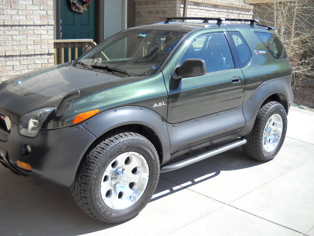

The old Strick9 sliders were similar and that's what I have on mine:
thank you for the pictures. That is exactly what i needed. Now i have a very good idea on what to get started with.

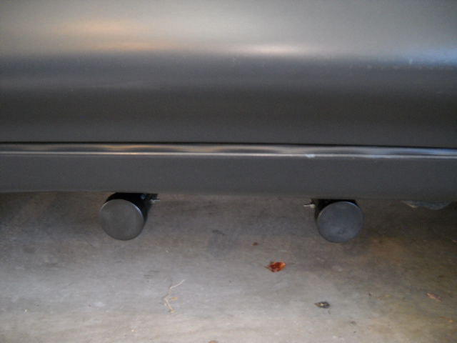

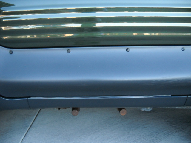

Previous owner cut the square tubes, welded in some solid round tube in, put them back together and drilled holes for a 3/4" bolt and made them removable.
I really enjoy being able to take them off in the winter so they don't fill up with snow and ice and drip in my garage....
With some covers that I made from black PVC

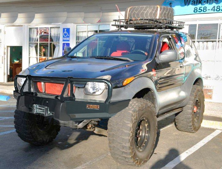

Another member did this back in the day, not sure if he did it himself or hired someone else. Some of our older members may know...
Grandpa bob... I always heard he wheeled the crap outta his Vx.
Old guys/gals chime in on his bumper?
