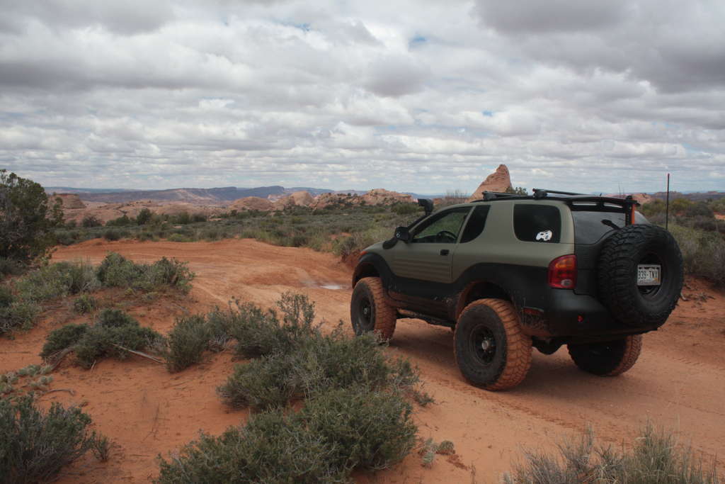

I went for a color change in April, out with the blue and in with the "new color".
Officially it's:
AVERY MIDNIGHT MATTE SAND METALLIC
...But that's a mouthful, so we'll just call it green.
Many already saw it in Moab but figured I should do the official announcement. Vinyl is getting CHEAP!!! $220 for the entire VX.
Currently I'm getting the Trooper RS fixed up as my daily. I have BIG plans for the VX this summer that will be posted in this thread. Stay Tuned.

Before & After
Ocean BLUE
Desert GREEN

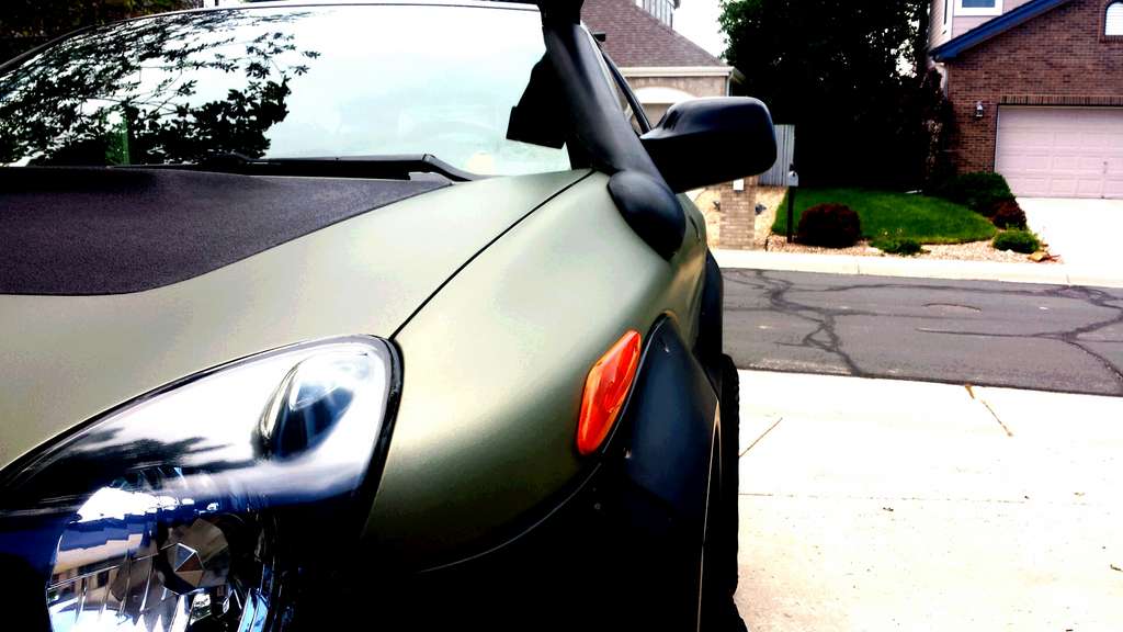

Jon this looks so badass as always, did you wrap the door jams too? What brand did you go with?
I did wrap the door jams this time and it was a real pain. Far from perfect but don't think door jams are a focal point anyway.
The old black satin hood was "Oracle" wrap, the blue brushed steel was "3M" and this green metallic is "Avery." I really liked the Avery as it wrinkled less than the other two. Who knows, the tech may just be getting better for the vinyls.
The three main stores to buy discounted wrap from are AVS, Ikon Wraps and MetroRestyling. Most of the time, you can find the wrap cheaper on ebay being sold through one of these store's ebay accounts.
Thanks Jon, I am looking at Avery as well, how much did you buy to do the vx, dimensions? Last question I promise lol!
Not the last question, because I need to know more! That looks great. I wouldn't have considered it until you through that price out there.
No worries on the questions Lisa, I can help you out with more specifics if you decide to wrap. All the vinyl is sold in 60" wide rolls and you just need to specify length. I used 25ft this time, which is just enough for the exterior and door jams (minus the back door). The first time I used 30 ft, which gives you a bit extra for mistakes/touchups.
Cheaper than a rattle can paint job!!![]()
So at 60" wide, do you have a seam when you do the main body (roof and both rear quarters)? I can see the doors, front fenders, hood and hatch all being done with no seam. Or are seams no big deal?
