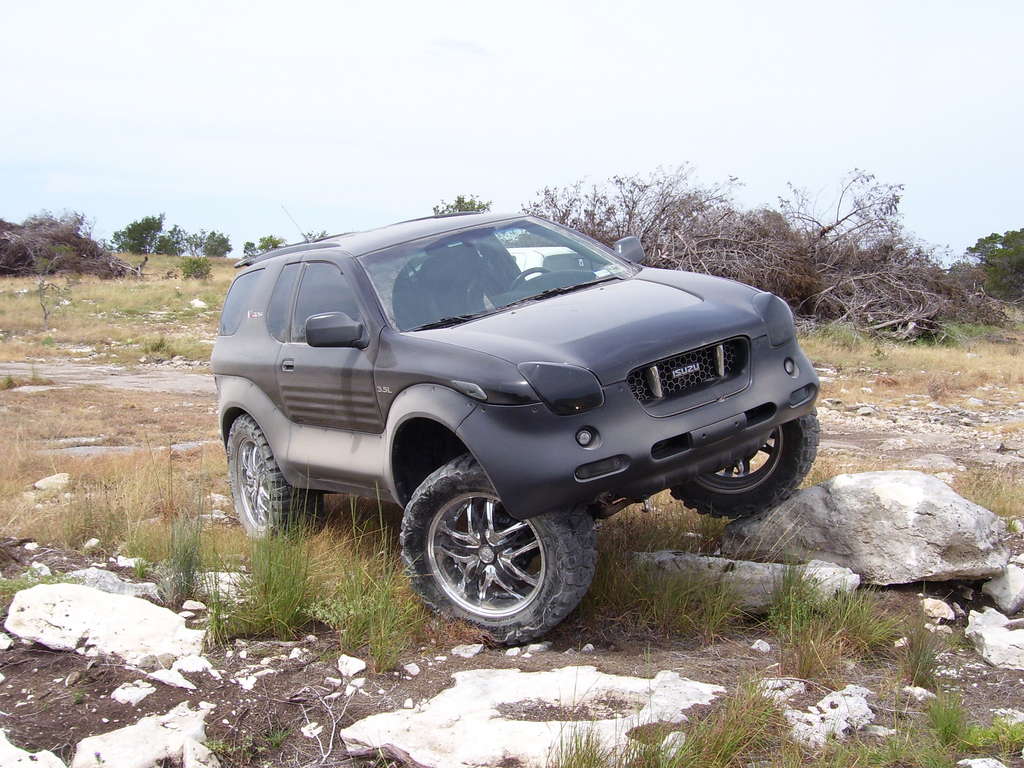

    I really don't understand what you are asking, but the spring spacer itself is 3" tall and the spring seats into the spacer 1" so it makes the spring 2" taller. Actual difference seen in wheel well to top of tire will be more like 1&1/2" to 1&3/4". If you already have OEM 912 springs it will make your total lift 4" or so. OME 912 by themselves only gives you about 2 to 2&1/2" lift. So OME 912's + 2" spacer will give you 4" to 4&1/2". The problem you run into when doing this is pinion angle. That is why I got the adjustable lower links. Without the adjustable lower links your driveshaft will probably start to vibrate past 40mph.
    Once again though when I had the smaller 33" tires on mine I had no problems with rubbing because I increased the size of my bump stops slightly. I did not loose any up travel in the wheel. See this picture:
  6. #21
    Jan 2005
    2001, Ebony Black, 1153
    2,264
    Once again these are with the smaller 33" tires I used to have on and I had extended bump-stops to prevent rubbing. Worked perfectly, and I was not giving up any up travel but I was saving my cladding from damage from the tires. These photos were not even at full travel. I do have sway bar disconnects and 4.77 gears, and diff drop brackets, and ball joint flip and lower profile bumpstops up front, and adjustable lower links and 35" tires now. Let me know if you are still interested in the 2" spacers though. I ordered 1.5" spacers instead to go along with the 912's.
