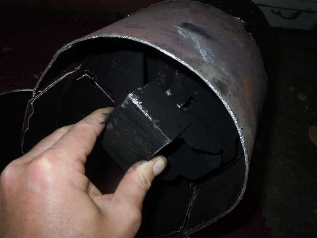

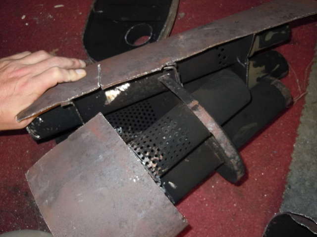

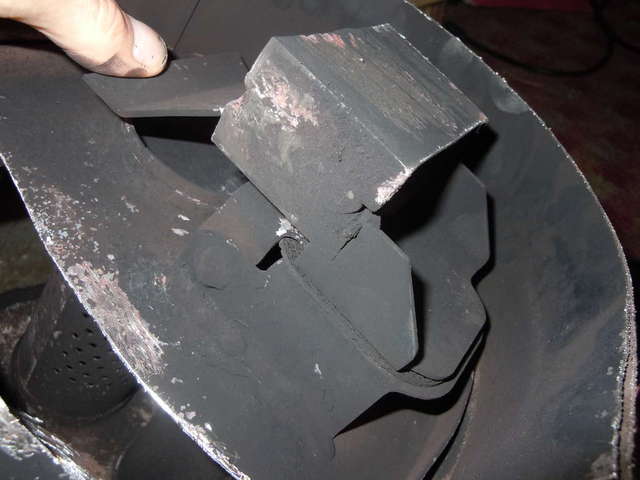

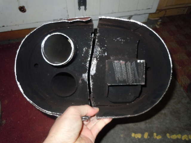

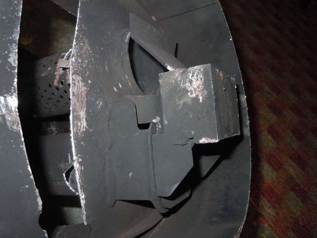

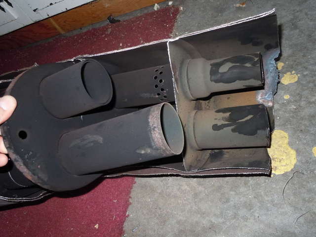

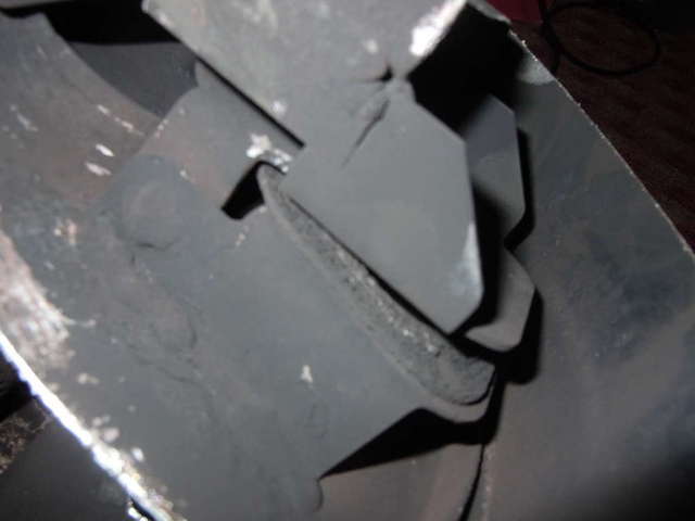

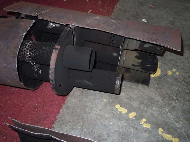

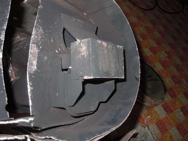

got a new "turbo" muffler installed and it sounds great ($75) - i told them i didnt want anything too loud and he said it def wasnt enough engine for flowmasters so they put one on that they said they use when someone comes in with a v6 mustang and want it to sound like a gt - cut up the old stock muffler with the sawzall and i think i might have found the mystery valve but not exactly sure how it works - ill take pics this weekend and put them up next week
side note: the stock muffler is a behemoth - very heavy - but i was surprised at how clean it was inside after 12 years
Fascinating! So what makes that valve open/close? The volume of the exhaust gas flow?
And is that the maximum amount that it can open?
Thanks for cutting it up!
I'm baffled by the valve too. (Get it? baffled? LOL)
It's difficult-to-impossible to determine flow path and what that doo-dad really does. I also wonder if it's really a direct obstacle to the "main flow path"...or something in a "secondary circuit"?
