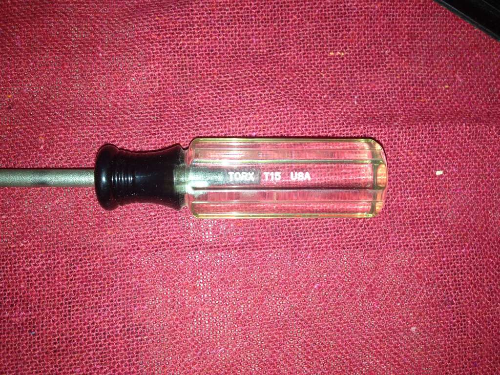

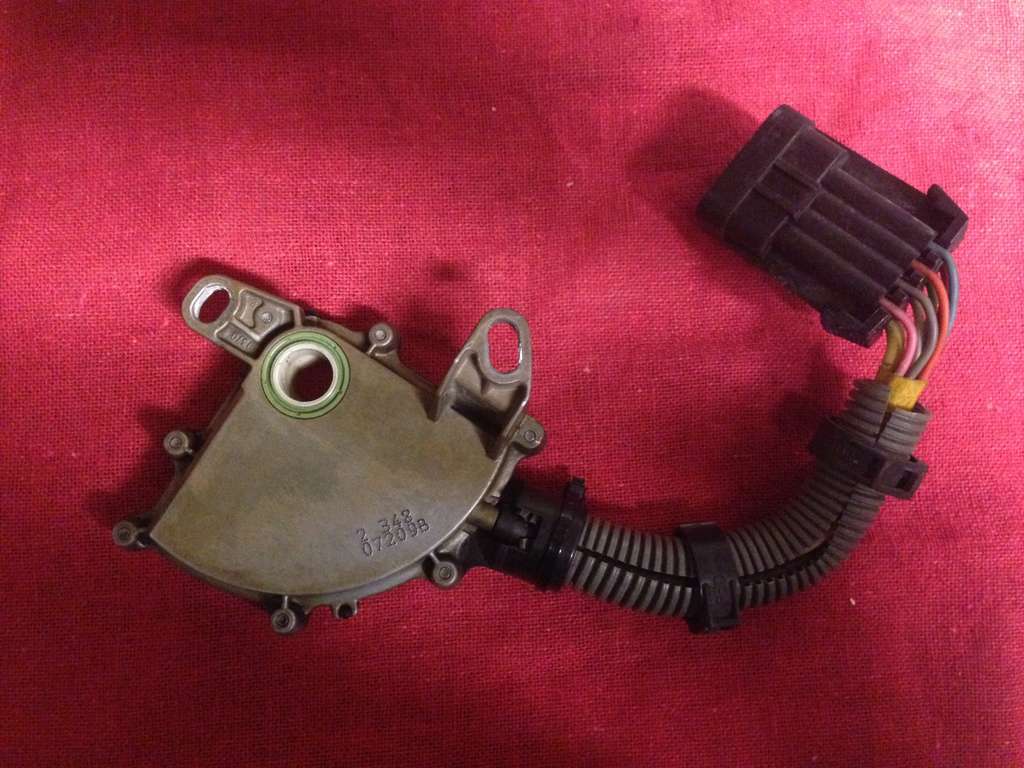

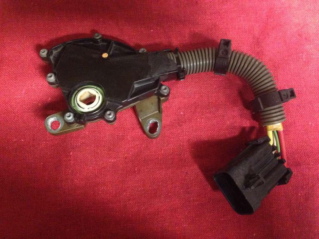

    Found it!!
    Finally dug through enough boxes in the garage to find the extra Mode Selector Switch.
    One side of the switch.
    The other side of the switch.
    Close-up of the torx screws.
    This is the torx wrench that I used to take it apart and put it back together. The T-15 is a little small, but it worked just fine. The torx screws might be a T-16, but I didn't have a wrench that size.
    Hope this helps some. Let me know if you need more pictures. I can always take it apart and take pictures if you need me to.

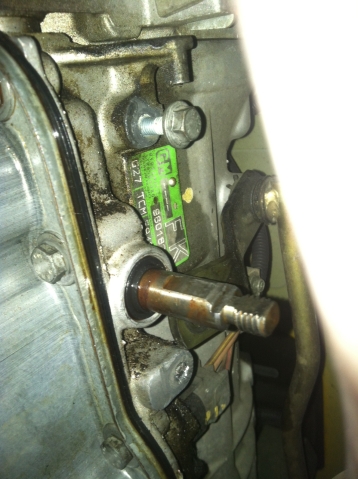

    Ok, so I think we have a solution!
    About a month ago, I took my VX in to get the mode selector switch cleaned out at a transmission shop. They claimed that the switch was riveted shut, and not bolted. I think they were looking at the wrong part.
    Yesterday, I took my VX to a DIFFERENT transmission shop to get the Mode Selector Switch replaced with a new one I got from Ebay . This second shop called me to tell me that when they went to replace it, one of the bolts holding the switch was BROKEN. They have to extract that bolt and put in a new one.
    That would explain the strange and intermittent missed shift at 27 mph!
    Ive been driving with this issue since 2010. I am VERY excited to see if this fixes the problem that it took 3 shops to notice. JESUS
    I should have it back tomorrow, will post an update.
    Photo of broken bolt below.
