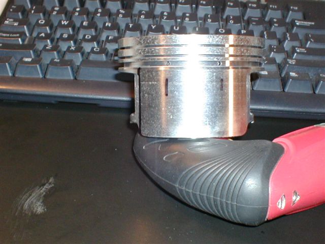

    Here are the instructions that I got from Jerry Lemond on how to drill extra oil drain holes in our 3.5L pistons:
    Drill a hole, the same size as the ring land, where the two black lines are on the skirt, right under the two factory drilled oil holes, then drill holes to the left and to the right at the other black lines right besides the boss where the wrist pin is. Use a battery powered hand drill set to slow speed with a new sharp drill bit. It drills very easy.
    EDIT: To be clear, and I double checked with Jerry, the holes need to be drilled IN the ring land and not on the skirt of the piston.
    Simple and to the point.

    Sorry y'all. I totally spaced out and didn't explain WHY you would want to drill holes in your pistons.
    As 89Vette said, one of the theories as to why some of our engines burn oil is that Isuzu used some bad/iffy rings and not enough oil drain holes in the pistons when they originally built these motors. The oil drain holes in the pistons are there, as Vette said, to drain oil back into the crank case. As the rings, and oil scrapper travel down the cylinder wall they are supposed to squeegie the oil off of the cylinder wall, and either push it back down into the crank case out of the bottom of the cylinder, or force it into the drain holes. The original drain holes are thought, by some, to be too few and too small thus not draining enough oil, or getting clogged and not draining any oil at all.
    The pistons in the new Isuzu motors have more, larger, drain holes and this may be why most of the new motors don't burn any oil. Jerry's instructions above provide a way to make the existing drain holes larger, and add additional drain holes to hopefully stop the oil burning issue in the older engines. Jerry has done this fix to numerous engines and he said that it works very well. He didn't mention that it might throw the balance of the engine off, but since you would be removing such a small amount of material and can't see how it would effect it that much, if at all.
    Obviously (well, maybe not to some), the engine has to be completely taken apart to accomplish this fix, so it is really for those who are looking into re-building their engines, or who have the time to take their engine apart to do the fix and then put it back together.
    If you get a re-built/remanufactured engine, it is not guaranteed that the shop used the new Isuzu pistons so you could be getting an engine that will have the same oil burning issues as before. Jerry said that he has ordered a few remanufactured engines to see if they were using the new pistons, or at least drilling them out, and most, if not all of them, had not.
