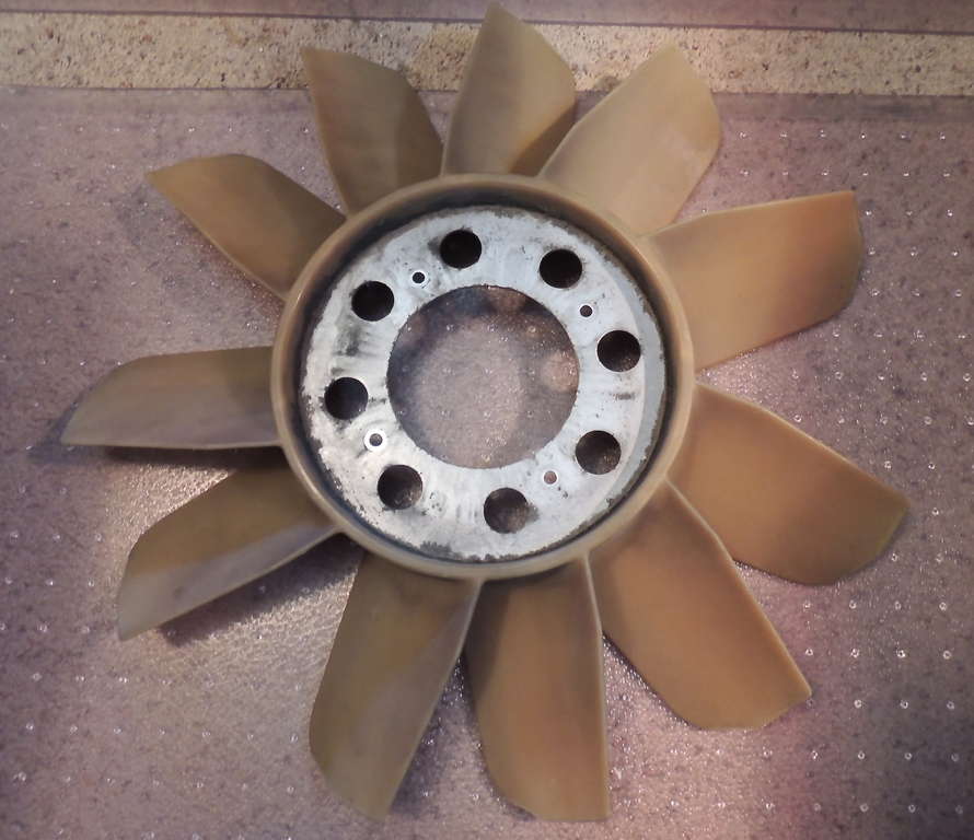

    Interesting, new fan has 9 blades, old has 11. Blade shape and curve are also very different. I didn't measure either of them, but visually, it looks like there may be more surface space on the new blade, but not sure.

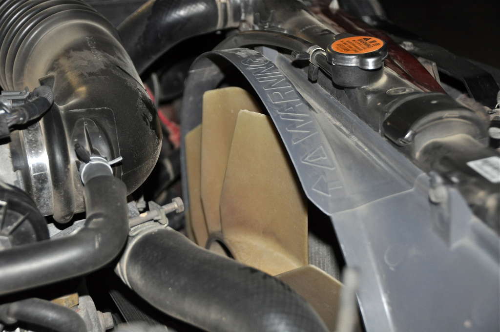

    I thought for sure the new blade wouldn't fit in the old shroud, but it did, mechanic said it was tight. And Dub's tread plate cover could stay as well.

    sooo, here is my question. I will type slowly... In Kats picture above, of the origonal fan blade, would the side that is facing up be the side that is attached to the fan clutch, in other words, would that side be facing the engine? because thats the way mine is. the cups of the fan are facing the front, facing the radiator. with the rotation of the engine being what it is, the fan is slicing thru the air, instead of cupping and blowing the air.
    its been like this for over a year, with absolutly no cooling issues, but, did i somehow put my fan on backwards?

    I matched up the blade with my pic, the blades are cupped down, away from the camera. (Despite the blade at the 9 o'clock position appears to be cupped up, it's not).
    I then matched it up to this pic from before I had my new radiator installed...It's definitely cupped toward the engine so theoretically, this is the factory position.
    So if yours is now cupped toward the front, I believe it's backwards.
    This is other side, cupped toward camera, which is facing the engine.

    If you order this part from Isuzuparts.com, you need to specify the part number. If you have the new fan clutch (part number 8-97349-761-0) DO NOT order online as they will send you the old fan (part number 8-97172-201-0, bottom picture above). When I had to call them after ordering online because they sent me the wrong fan, the guy I spoke to (Brian) said that the new fan doesn't even show as a part for the VehiCROSS. Just as an FYI, the redesigned fan part number is 8-97349-762-0, top picture above).
    The old fan/new fan clutch are physically incompatible.
