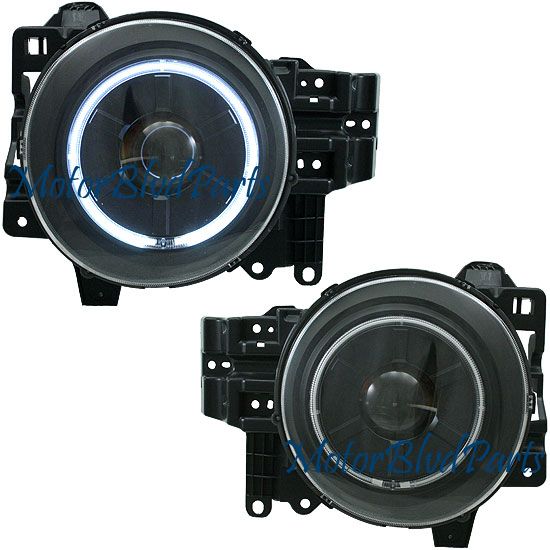

    I don't have any pictures of my mini, but here are some of the pictures that are close to what I did.

    Jay did this on his FJ and it looks slick. Hopefully he'll post some pics. When I saw his install in Moab I thought about doing it on the VX....looks like LittleBeast will be the guinea pig. Definitely post some pictures once you're done.
    Yeah Jay's looks great. I've been looking onto a kit specially made for FJ's that I think would look great in the VX headlight assembly.
    The biggest problem with adding basic projectors to our headlights is that they are long and need to stick outside the headlight. Check out whaleboy's gallery- he already added projectors a while back.
