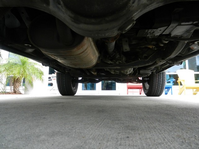

Is this the OEM muffler?
Sorry I don't have a better angle.
Yes.
