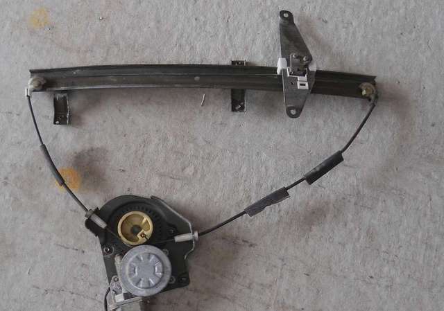

    Some pics of unbroken regulator for reference.
    First 2 pics are a BRAND NEW one, other 2 are used.
    1) New Passenger side
    2)
    3)Used Driver side
    4)Used Driver side
  9. #99

    When I first got my VX three years ago, I bought the SBC fix before I had even opened my doors up. Both windows were tilting, with the worst being the passenger. I thought that it was a clip issue given the state of the forum at the time. After opening it up it was clear that the issue was with the wear of the plastic guides on the cross member. This was a terrible design flaw, but I assume that a scissor mechanism wouldn't fit inside the VX's door due to the curvature.
    Anyways, after some lazy bit of searching, I came across this Isuzu Rodeo regulator from 94-97 (and honda passport). Does that cross member look familiar?
    VX regulator:
    Rodeo Regulator:
  15. #105
    Dec 2010
    2001 Proton Yellow VX 1268
    58
    My dad has 2001 trooper and we bought a new rear door regulator for it. when it came it looked almost identical to the V. So based only on the pictures posted here and the pictures on ebay I think you could drill out the spot welds on the mount brackets on the old reg and rivet them on the trooper reg and you would be good to go. THIS HAS NOT BEEN TESTED. just an idea.
