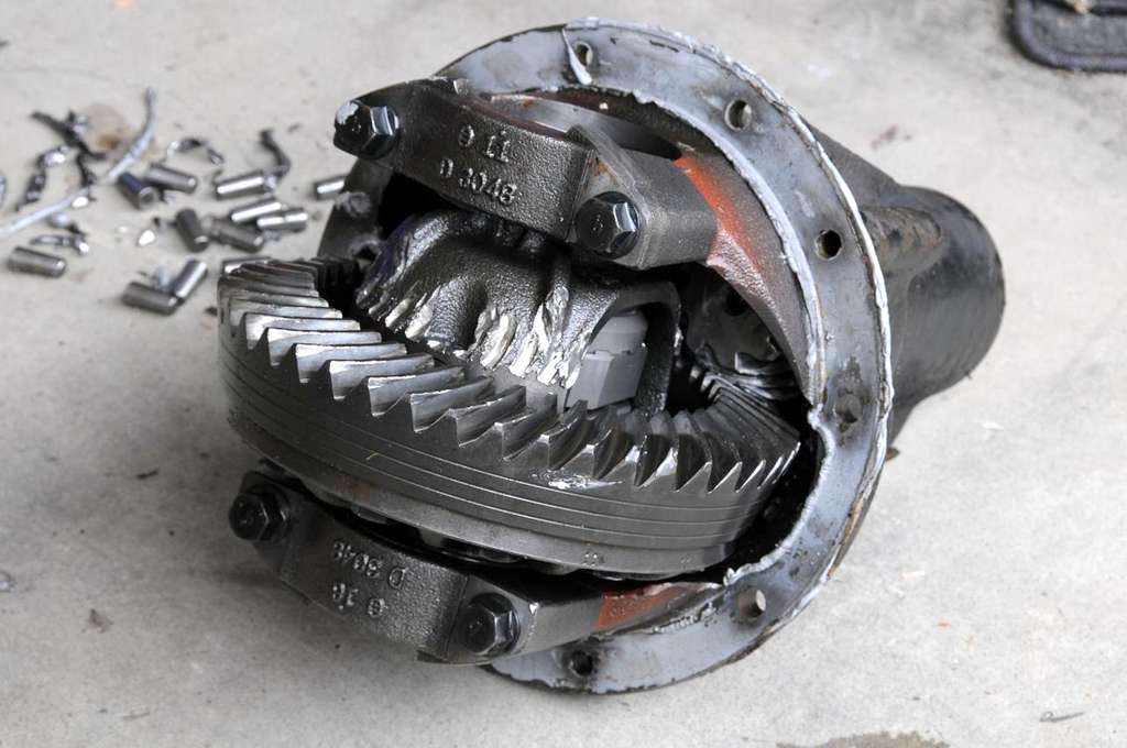

    Hey Jo ! If I find a trooper with the 6NZ code how do I remove the gearing and what tools do I need to get the job done . I would like the process explained in detail . Removing the entire rear and front axle will be a deal breaker for me .
    Nov 2004
    4,403
    Thanked: 14
    Hiya Travis...
    Quote Originally Posted by tjh View Post
    No need to remove the axles at all.
    The differential housings ("3rd member") slide out of the axle pumpkins.
    Roughly speaking...(how I do it, any better ways welcome!)
    1) remove drive shaft at axle end.
    2) remove all bolts that hold 3rd member in pumpkin housing
    3) Pull axle shafts enough to release/clear splines from diff.
    4) Pull 3rd member out.
    5) curse, cause ya forgot to empty diff oil first, and yer covered in ICKKK!!
    You'll end up with this (3rd member)...
    ...but not damaged hopefully...and with 43 'teeth'
    From here the 3rd can be taken apart/boken down....
    .... and the ring gear,carrier housing and pinion can be seperated from the 3rd member "housing/case"
    Hope that helps...and thanks for YOUR help
    Jo

    Forgot 1 step... you have to pull the axle shafts out of each end enough to disengauge from the third member.

    Thank you ! So in order to pull the axle shafts I probably would need to remove the brake calipers or something else ? Is the front diff the same procedure ? It has a CV propeller shaft, which I guess would be a pita to remove. I know you just need the rear pumpkin, but I cant see leaving a perfectly good 477 front pumpkin behind.
    Wrench
    The sensors on the rear axle need to be removed...CAREFULLY, before the axles can slide out.
    The entire front axle needs to be pulled, so you can get to the snap rings behind the diff brackets...
