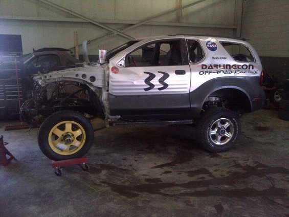

    No recent pictures but I have the motor and trans out. I am working on getting the AR5 prepped for installation. I am building all aluminum rear links and steering links as well. It is going to be nice when I get it all together. Also working on installing the guessets on the rear axle to I can get that back in. Still lots of work to get done, so much so that I will not be ready for the first race. I will get some more pictures up soon. Especially when I get all these nice new parts installed.

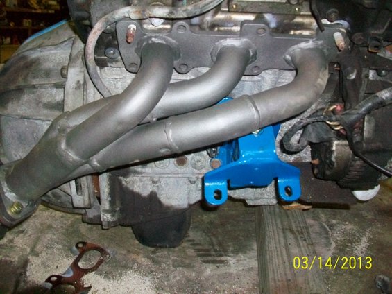

    Custom motor mounts by a fellow racer who owns a fab shop. You send him the motor plates and your mounts and he transforms them into this....

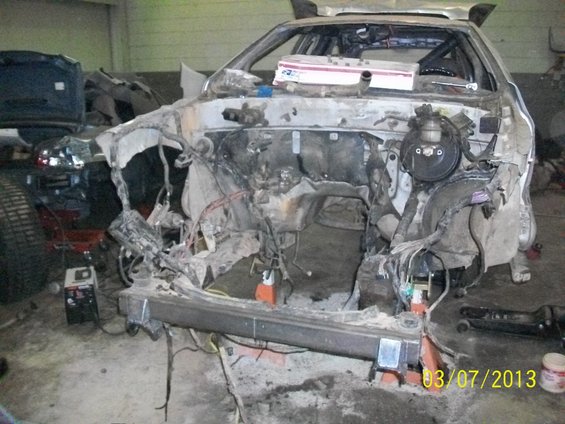

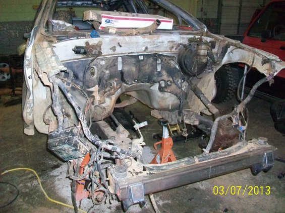

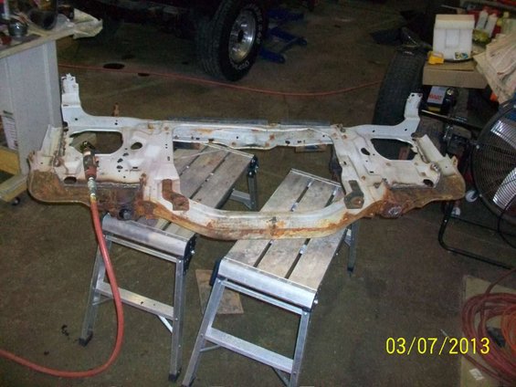

    Making the final "adjustments" to the front end. The core support will be removeable. The inner fenders have been removed to make room for the larger shocks and roll cage extension.

    ....any chance he wants to make another set, assuming they'd fit a stock engine situation?
    I've got one mount fubar'd...would be interested in a whole new set at the right price.

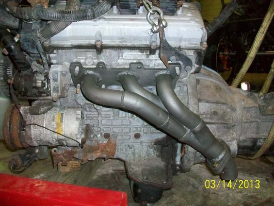

    Need to get some header wrap to help keep the underhood temps down.
    Hatfield...most offroad races it is illegal to run open headers...fire danger.
