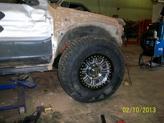

I am getting ready to start my second season racing ECORS. The last race of the season beat the VX to an inch of its life! Totally destroyed the passenger side, bent the passenger side frame, almost lost the rear bumper and tore the farelead off the front bumper.
I was tired of getting lapped by Jeeps, Sammies, etc... the IFS just didn't have enough travel to take the abuse. So... out it came and in goes a Dana 44 with 5.38s and ARBs front and rear. I am still in the mock up stage but this thing is going to be a beast. I will be running RaceLine beadlocks and 35x12.50x17 tires. So here's some pictures.....
Mocking everything in place. Ths suspension is in full compression here.
Love the size of this tire/rim combo.... these are just mock up tires but the races tires will be the same size as these....
More pictures and posts to follow. I have lots of work to be done by the first race March 24th!

How's the oil pan clearance with the D44?
It has plenty of clearance. It actually looks like it should have come stock with the solid axle in it. I was very pleased with how everything lined up. Like I indicated ealier the pictures are of the suspension in maximum compression and I still have 4 or 5 inches of clearance for the oil pan. The steering will be the real trick.... to be determined!

I am going to be converting to the AR5 manual trans. Oh I've been researching full hydro but for now the cost is getting out of reach of my budget. The system I would want is 1.75 turns lock to lock but costs around 3k. But I may do a hydro assist system. Going to be mapping the steering out tonight, I hope!
This year we will be in TN, AL, Marion, NC, possibly GA or KY. Should beat interesting season. I'm interested in how the truck will handle with 5:38 gears and ARBs front and rear. Oh and 35s on beadlocks! Can't wait to try out the improvements.
