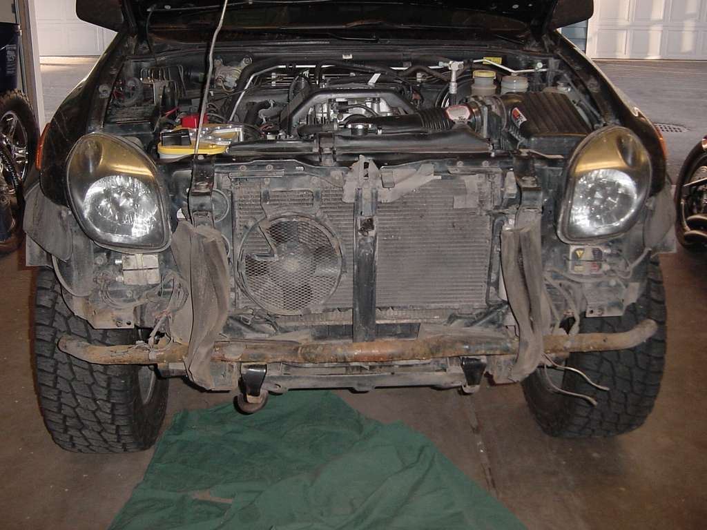

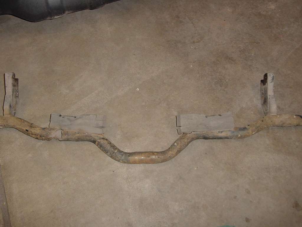

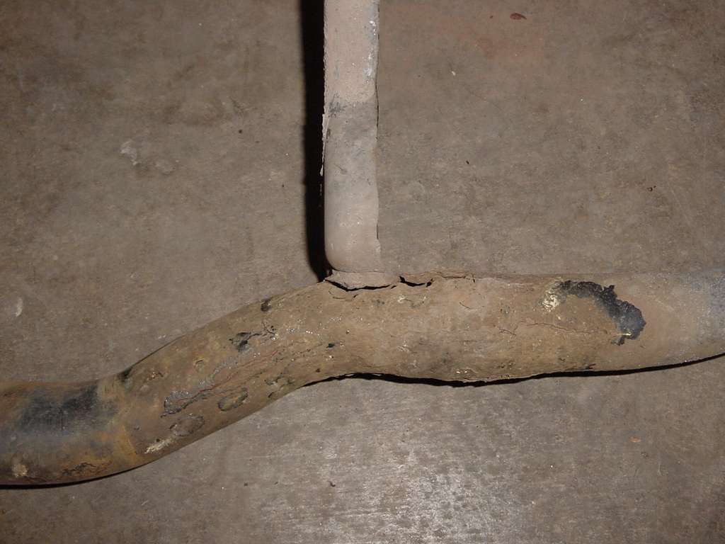

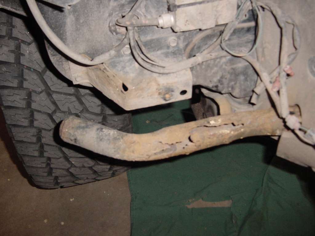

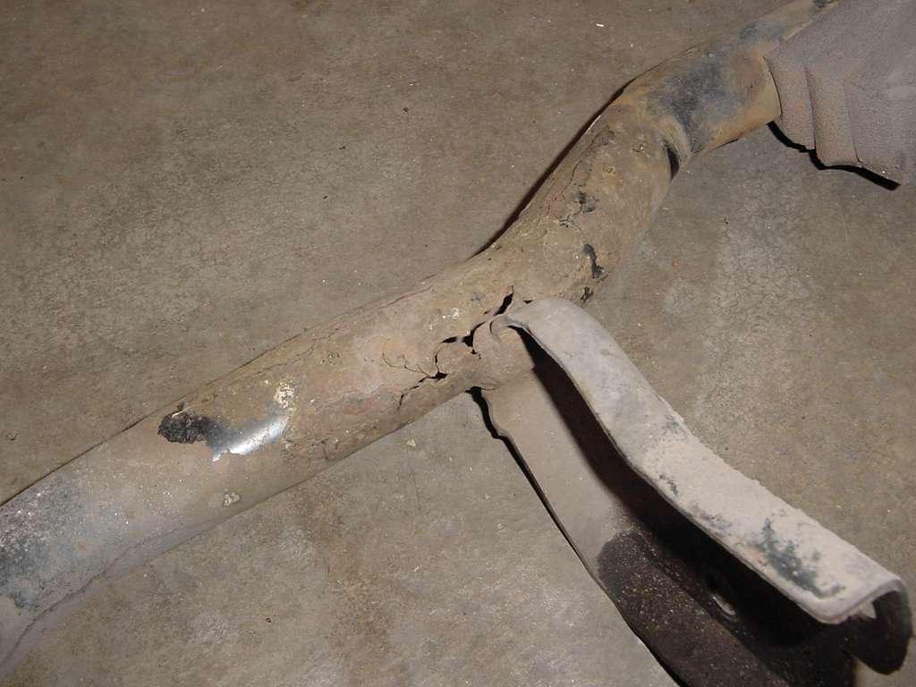

    OK, I've been threatening to do this for a while ( http://www.vehicross.info/forums/showthread.php?t=19947 ) and I finally got around to doing it. After taking the front cladding off this past weekend to do a little fog light work, I noticed that my front bumper was really just swiss cheese (more like metal lace) so I pulled the trigger and called a local 4x4 shop to have them bend up a new one for me.

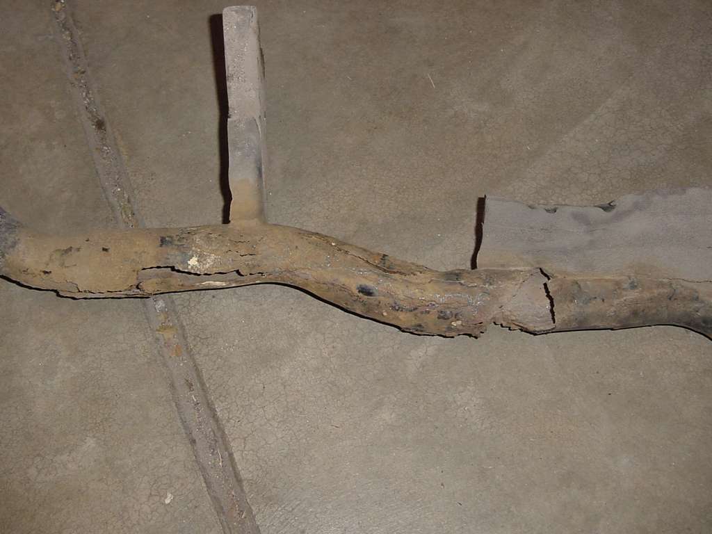

    When I took the bumper off I nearly fell apart in my hands. I can't believe that the thing was still in one piece and attached to the VX.
    Here are some before's:

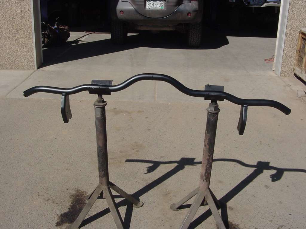

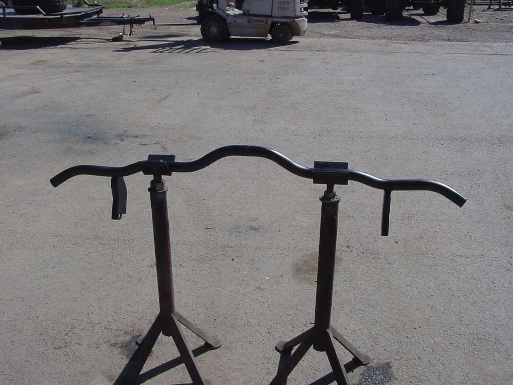

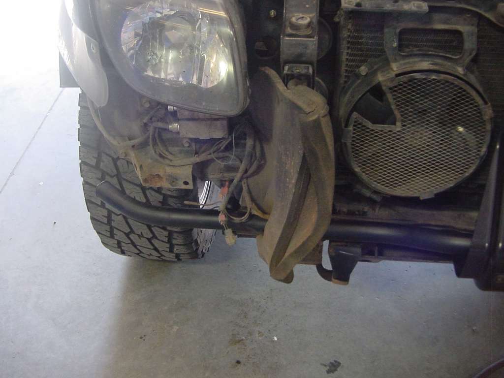

    And here are some shots of what the shop bent up. They used the same 1 1/2" steel tubing that they make tube buggies out of then mandrel bent it, welded caps on both ends then painted it with self-etching primer. The original bumper mounts were still good so they reused those.
    And a before and after:
    The shop (4 Play Offroad) kept the "pattern" and said that they would be happy to replicate it if anyone else wanted one.

    Looks good but I have one question. Is the center section where it is welded together sleeved?

    RabidPony - Yes, the weld in the center is sleeved. They ended up doing it that way because their tube bender couldn't do the two bends on either side of the centerline. Think they were too close together for the machine to handle.

    ~I'm pretty sure that the brackets are equally rotated. Maybe it's a weird perspective thing in the pictures. The bumper sits flat and level on the VX. Maybe they are rotated differently and my frame rails are out of whack.
    ~To tell you the truth I'm not sure how much protection this dinky little thing would provide. I have a feeling it would just get folded up into the radiator if it recieved a good impact, particularly my old rusted out one.

    The metal is thicker on the brackets and is probably a different grade of steel. That's probably why they didn't rot like the tubes did.
    The bumper offers little or no crash protection. Round tubing just ain't that strong. If you were looking to modify it for crash protection, you should replicate it in square tubing or angle.

    The reason the tube bumper rots is that moisture builds up inside it and then slowly rots it from the inside out. The brackets being flat do not retain the moisture. If you take a look at your factory bumper you will see the end caps are tack welded and not sealded the entire way around which allows the moisture in. Most could prevent the rusting by sealing the end cap and applying a good coat of paint...or be fortunate enough to live in a nice dry desert setting!
    As far as round tube not being strong...wrong. Why are tube frames not made with square tube? It depends on the tube material, how it is used and the size/thickness.
