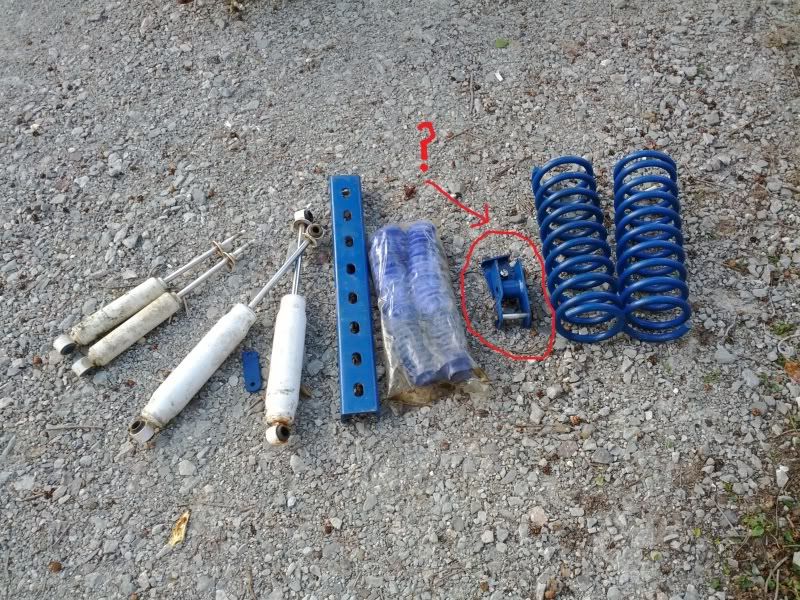

im finnally installing my calmini lift kit that i got from a fellow forum member here.
but i have no idea where this part goes installed ?? any help would be greatly appreciated a pic would be awesome

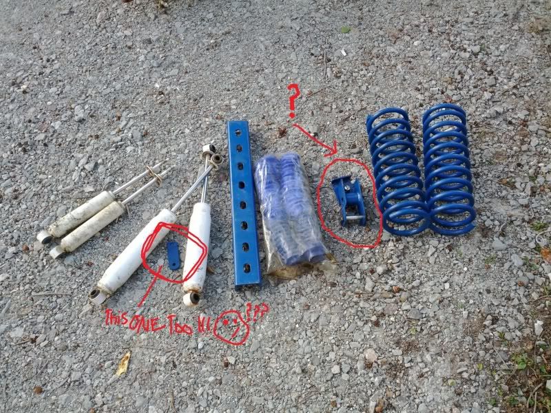

						ahh and this one too lol.

						I *think* the thing on the right is a drop bracket for the panhard bar, which is the axle link behind and parallel to the rear axle. The little tab on the left might be to raise the brake line junction on the rear axle, so you don't overstretch the center brake line with the lift.
I have no idea what the piece of blue unistrut is for...
Note that I have not used a Calmini lift, so take the above for what it is worth.
Hi,
Yip, BigSwede has nailed it on the button 100%. The small flat bar on the left is used to extend the T-piece on the rear brake lines upwards. Take a look at the rear diff and you will see where it fits. The other part extends the rear track bar downwards to cater for the increased distance between the diff and the chassis. If this is not installed, the rear axle will pull to one side. Last but not least, the unistrut does not look like the correct part (unless it has changed). It is supposed to be a replacement centre cross member.
Check out the pic on the Calmini website and you will see what it supposed to look like.
http://www.pureisuzu.com/99-01_3_lift.htm
I hope this helps.
Cheers
Robert
