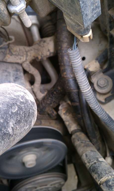

    Would this wetness have anything to do with it?
    Fan spins.
    May need to flush. Where is the thermostat located?
    Thanks for the advice.
    Wetness is likely power steering fluid. Thermostat is inside the engine block, not an easy fix.
    Id guess a normal radiator flush should make a big difference. Also make sure there no.blockage in front of the radiator fins.
