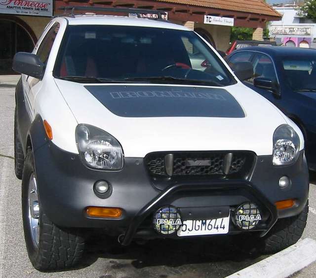

With the help of many people here, and the encouragement from several more, collectively we present the definitive Safari Bar thread.
The bar pictured below is the Westin 30-0015 safari bar, also referred to as a "bull bar," shown in black. It is available in chrome as well, that model being the Westin 30-0010. Lights sold separately (assuming you're not purchasing someone else's set up).
(Image courtesy of member cascabel3's gallery.)

My personal experience is that the safari bar, installed with the hardware described above, will fit a VehiCROSS outfitted with a fiberglass "skid plate" sourced from fellow member Rowhard. However, the .25" clearance on my particular vehicle, combined with the hand-assembled nature of our vehicles leads me to believe that some adjustments may be necessary.
