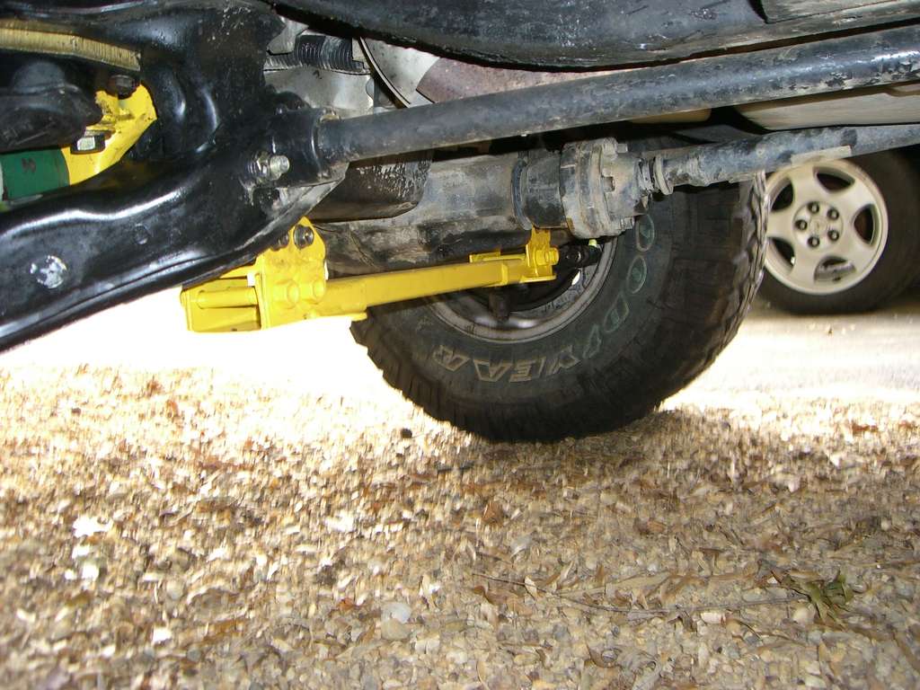

    unistrut
    http://store.eberliron.com/products/...channel/p4100t
    It may be modified to be a crossmember but I know unistrut when i see it

    Good call...
    Quote Originally Posted by Jpuga87 View Post
    just sent the paypal payment
    ...its a good deal if shocks are good and coils are equal.
    Now ya just need a VX to put it on!

    Is that an early Kit or ????? The VehiCROSS kit on Calmini's page looks different than your pic as far as the crossmember goes and no brackets with mounting holes on each end. The Unistrut piece in the pic is for what then?
    http://www.pureisuzu.com/99-01_3_lift.htm

    Actually Tom......
    The crossmember is the Drilled square section...
    ... between the boots and shocks in the pic.
    Its just upside down.. ...and youre right...its really not needed.
    jo
    I'm not seein it. Mine looks totally dif'rent.
    Quote Originally Posted by lasturbo View Post
    Now dats what mine looks like.
    Not needed anyway so - irrelevent.
    BTW, Kilby must get the crossmember from Cal-Mini for their skid plate application 'cause it's same-o ('cept they drilled & tapped a few holes).

    MMMm.......mine is different.
    Mine is 100% the same as the OP picture on this thread.
    Calmini must of changed the design recently I guess.

    Like I said, it could have been modified into a crossmember, but it started life as a piece of unistrut.
    Unistrut is extremely strong. it's even used to hang heavy pumps and motors.
    Here's a better link to show more applications;
    http://www.unistrut.us/

    I've used Unistrut for many applications....including marine and Industrial.
    I know it well..
    ...but...the real point being...its not required anyway!
    There is no need to swap it out... the OEM crossmember is good.
    jo
