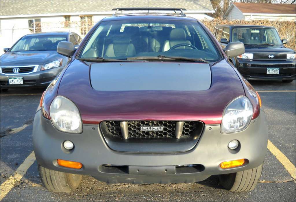

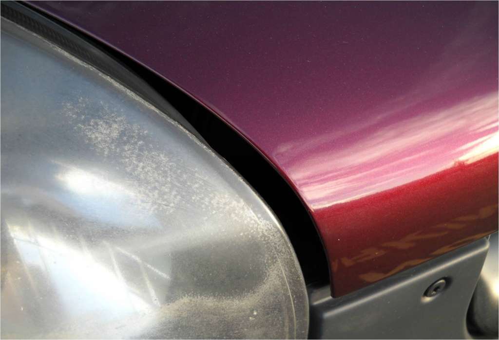

    Here are two pics from before the clear bra application. It's hard to see here but the passenger headlight is very cloudy.
    Here's a closer view of the oxidation on the passenger light:
    And here's a front-on view after headlight polishing and clear bra application:

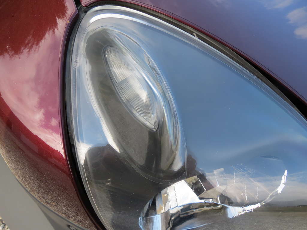

    Closer view of the passenger headlight:

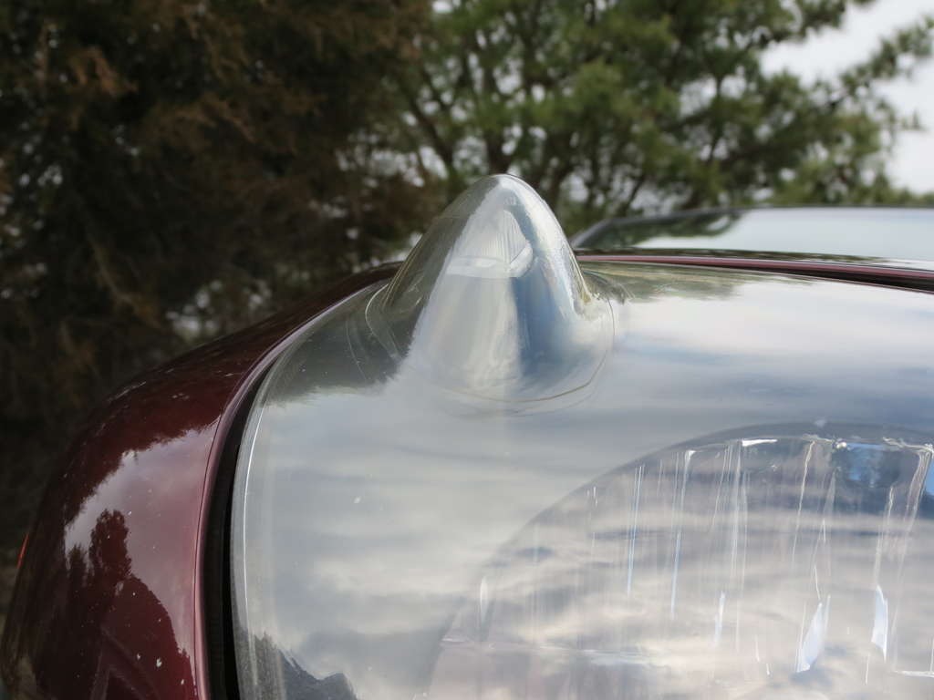

    And here's a close-up of the horn where you can see the custom application work that had to be done. 3M doesn't have a template for our headlights (or our hood or fenders for that matter), and just as is the case with the 3M Stongard protectors that I previously had installed, it's not possible to use a single sheet of film to cover the main section of the headlight and the horn without serious bubbling and detachment issues. So here you can see where the installer cut the main section of film, then custom made a second layer to go up and around the horn. I will be interested to see whether I get any yellowing in the tiny strip between the two pieces of film.

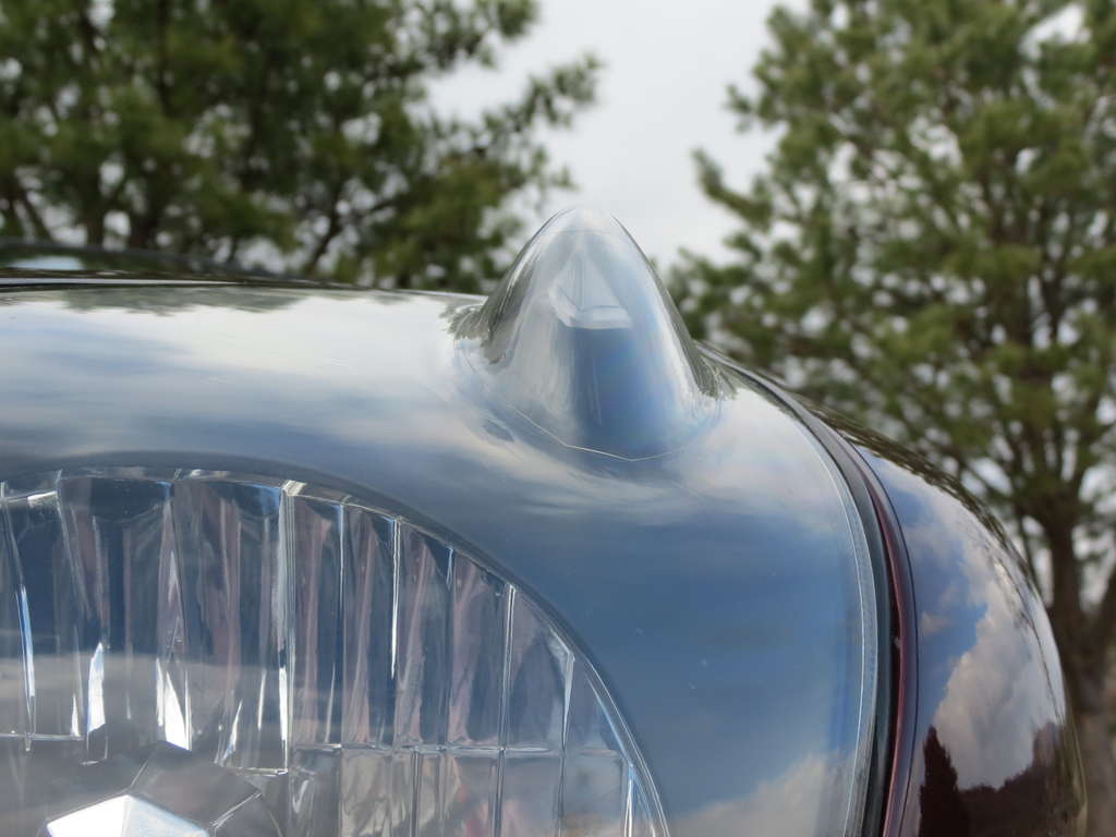

    Better view of the two film sections:

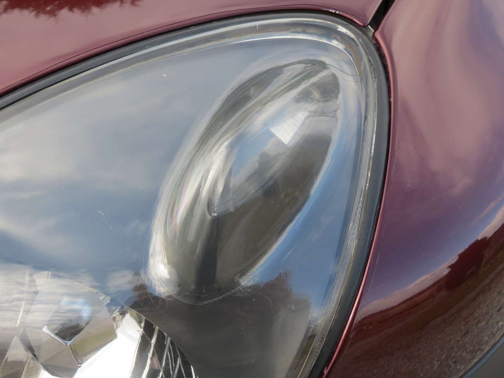

    And now the driver's headlight:
