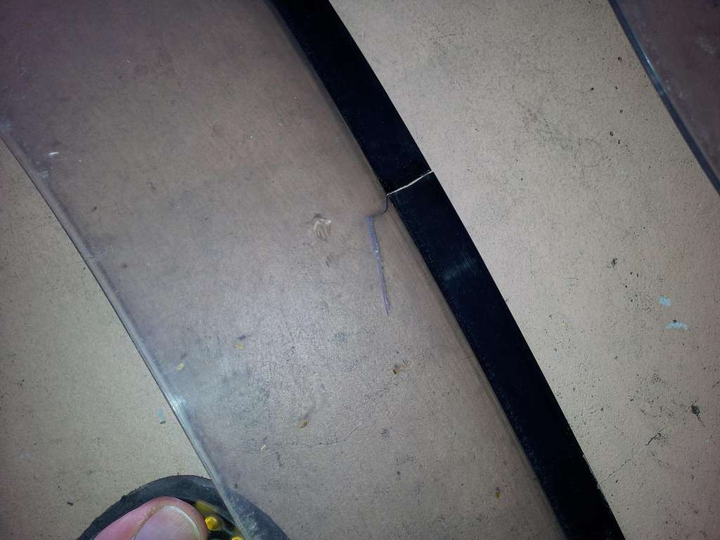

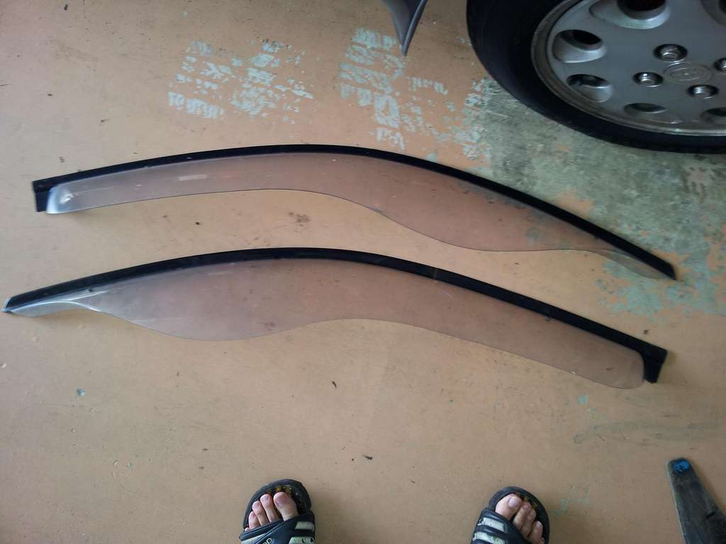

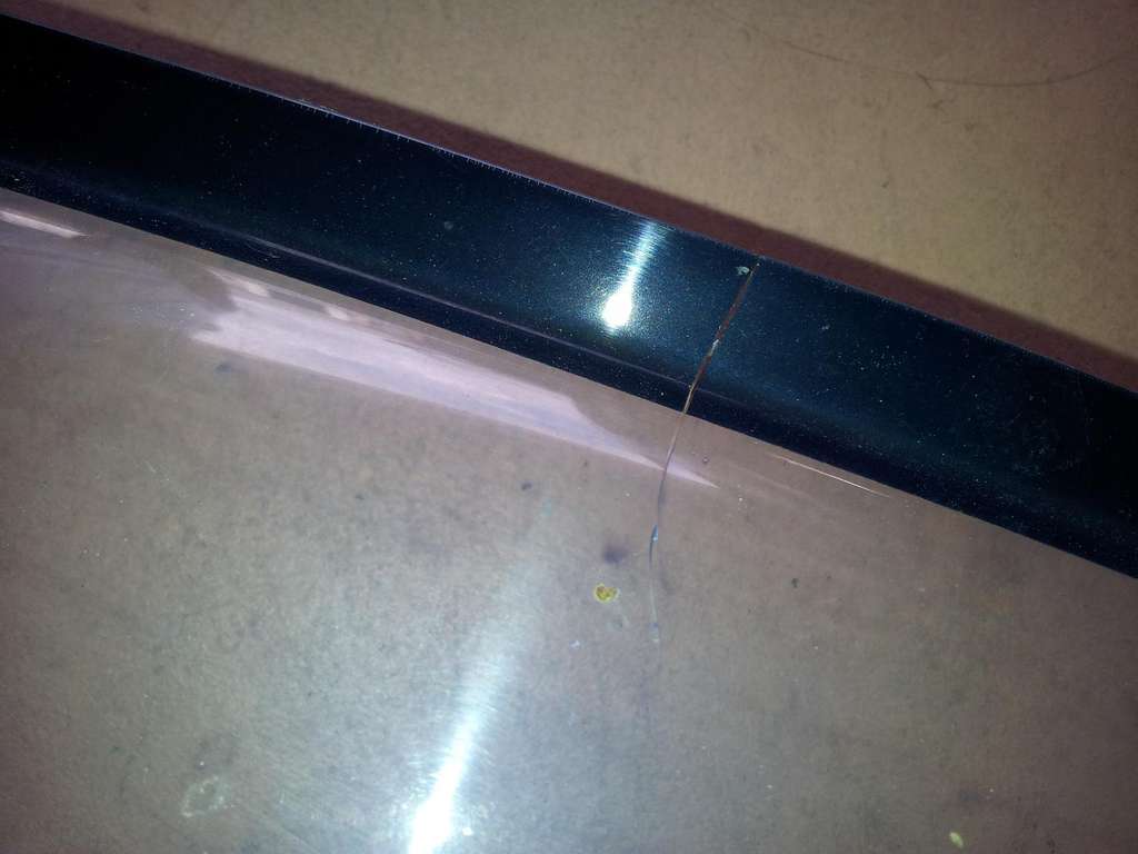

I have a line on these if I want them, but before I commit, does anyone know if it's possible to repair cracks in plastic like this? And if not, is anyone interested in using them to make molds for new ones?

This hard plastic responds well to 2 part epoxy or superglue, just go easy on them and maybe sand down the areas-post-glue to make sure they are nice and flat.

ATF - I may take them to a glass and body shop and see if they have some sort of resin they can put in there to fix it...

Plastic "welders" exist and make repairs to plastic best. They actually heat the plastic so it fuses itself back together.
They do make "plastic" superglue but I've yet to be thrilled with any plastic repair. If they make a plastic epoxy, that's what I'd try first.
Duplicolor and SEM make great spray dyes if you need to refinish after you're done. This stuff is very thin show it shows everything. OTOH, it's very durable ad professional looking. Much better than paint where paint isn't' desired. Best part is it won't chip if prepped correctly.
It seems that one of the cracks is on a part of the visor that should be clear. Maybe the reheating would be best.
They are so rare, that it is almost better to take them to a professional as VT mentioned.
						I thought the JDM ones sat outside the window channel, and those appear to sit inside the channel.
Regardless, first thing I suggest you do is find a place to dupe them so you could sell them to our membership. They would surely sell, and I'd be your first customer.

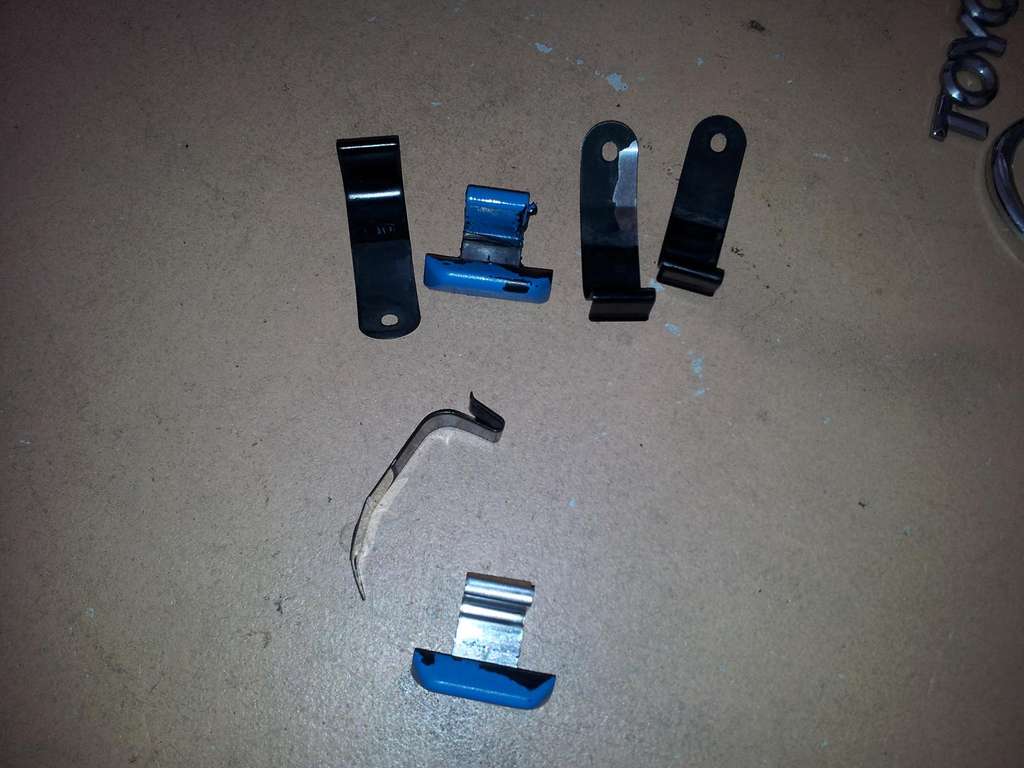

						Here's a pic of the mounting hardware:
